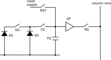

    Here is a diagram
    Here PD is the photodiode, TG is the transfer gate, FD is the floating diffusion connecting TG with the source-follower amplifier SF. Remember that source followers have a voltage gain of unity or a little less, so the input of FD is limited by the voltage swing of the output. What determines the size of the input? As PD collects charge Q it will gain a potential Vpd of Q/Cpd where Cpd is the capacitance of the photodiode. The photodiode itself is generally isolated by trench oxide, so the only thing limiting Vpd is the breakdown drain-source voltage of TG. When TG is opened (made conductive) the charge flows into FD, causing a potential of Q/Cpdfd where Cpdfd is the parallel capacitance of PD and FD. Now this voltage cannot be larger than the output swing of SF, as discussed above. Also, to ensure that most of the charge transfers to FD, and therefore is used, PD must have a much lower capacitance than FD. Thus it is the capacitance of FD and the output swing of SF that determines the maximum usable charge. In many modern sensors there is a further capacitor which can be switched in parallel with FD, thus lowering the potential for a given charge and allowing more charge to be used - sometimes (wrongly) called 'dual base ISO'. This feature is an indication that it is not the 'well' that dictates the size of usable charge - rather it is the capacitance of FD and the voltage swing of SF.
    This diagram shows the circuit of a global shutter pixel:
    Here a second photodiode SD has been included, though it doesn't act as a photdiode because it is protected from light by a mask. It's there to save the charge from PD between the time the exposure ends and the time that the pixel can be read. At the end of the exposure the gate SG opens to allow the charge from PD to transfer to SD, then close. Then the pixel operates as the standard pixel above. So what limits the performance compared with a standard pixel. One factor is the degree to which complete charge transfer can be effected between PD and SD. This is in effect a very small CCD, so can be made quite efficient - though limited by the gate voltages on CMOS sensors being much smaller than on CCDs. The second limitation is how much capacitance there is in FD, given that the pixel has more to fit in the same space. If the capacitance is smaller, the maximum charge usable is smaller. However the pixel is still collecting light from the same area (assuming good microlenses) so can tolerate a lower maximum exposure, which means that a higher ISO must be used.
    PNG, 6.7 KB, uploaded by bobn2 on June 26, 2024.

    Why should there be any difference between the breakdown drain-source voltage in TG (fig.1) and SG or TG (fig.2)?
    IMHO it would make more sense to close switch SG during the exposure and open it as soon as the exposure ends. Too bad i never bothered about CCD shift intrinsics.
    (I didn't attend semiconductor physics lectures beyond 101)

    I shouldn't think that there is, and if there was, it wouldn't make any difference - because that breakdown should never be reached in a properly designed pixel. Those transistors will be made as small as they can and still gives a breakdown above that required to give full output swing of SF.
    It's possible that some do it that way, but papers I've seen on GS sensors say that it is only PD that collects exposure charge.
