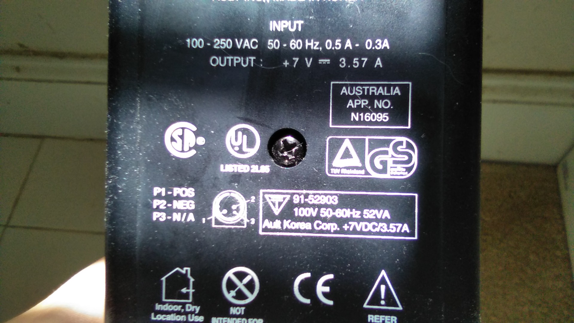

    In the mean time, I'm wondering about using it around the house/studio with a bench PSU. The connector looks simple enough with just a 3 pin mini-DIN, and I know Quantum made a pig tail to run these cameras off one of their packs. I seem to remember the power supply being a generic looking brick that just had "POWER SUPPLY" or something like that splashed across the front in big letters
    I've looked but I can't find the pinout published anywhere on the web for this. Does anyone have it?

    Hi,
    I just happen to have one handy.
    And a cell phone cam comes in handy once again. :)
    Stan
    JPG, 367.9 KB, uploaded by StanDisbrow on May 3, 2023.

    Wonderful! thank you and it worked perfectly once I remembered to invert it left to right for the female part of the plug!

    Hi,
    Ha! Yeah. Been there and done that. I didn't get a T Shirt. And my wife is a screenprinter! :P
    I should design one that says Flip the Flipping Pinout Male v Female
    Very few would get it, though!
    I actually had remembered the voltage and which pin was which. I grabbed the end to snap a pic and turned the brick over in the process. And there it all was on the label!
