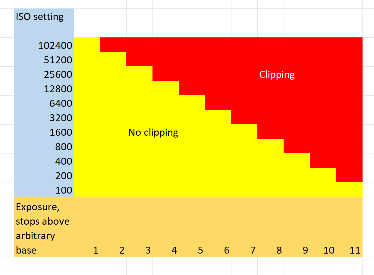

    June 12, 2023, 11:02 p.m. June 12, 2023, 11:02 p.m.
    @finnan has written:
    Either the base is not arbitrary,
    or the "11" is pulled out of thin air.
    The 11 was necessary to deal with the range of ISOs.
    Deleted and IliahBorg like this.

    June 13, 2023, 12:07 a.m. June 13, 2023, 12:07 a.m.
    BTW, for scenes wider than 11 stops lens flare starts to undercut linearity.

    JimKasson
    Members 1738 posts
    June 13, 2023, 12:12 a.m. June 13, 2023, 12:12 a.m.
    Oh, so you just choose the number of stops so they match the number of ISO ranges in your graph, thus getting an isosceles triangle.
    Nice trick.
    Thank you, but it's not an isosceles triangle. It's a right triangle. It's just a teaching aid.

    JimKasson
    Members 1738 posts
    June 13, 2023, 12:25 a.m. June 13, 2023, 12:25 a.m.
    Right triangle or not, if row and colum labels have the same distance increment it's isoceles for sure.
    You could make it an isosceles triangle if you did that.

    JohnMoyer
    Members 83 posts
    June 13, 2023, 3:47 p.m. June 13, 2023, 3:47 p.m.
    @JimKasson has written:
    What the graphic does show is the effect of ISO setting on full scale with full scale measured in lux-seconds of exposure.
    What definition for ISO are you using? What does the camera do when the ISO setting is changed? Do all cameras do the same thing when the ISO setting is changed?
    JimKasson
    Members 1738 posts
    June 13, 2023, 3:54 p.m. June 13, 2023, 3:54 p.m.
    @JohnMoyer has written:
    Whatever the camera manufacturer chooses.
    In the vast majority of the cases, it applies conversion gain, analog gain, and/or digital gain to the sensor photodiode charge..
    Not all. The Fuji GFX 50S and 50R are an exception at some ISO settings. But not the GFX 50S II.
