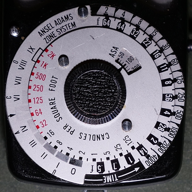

    The model 6 p/n 560 is actually said to be made under license by Sekonic, neither by Weston nor by Sangamo-Western. Mine came with the optional Adams Zone dial, which is why I bought it out of interest.
    Took me a while to figure out the Adams Zones bit. There's a small arrow where "V" should be. Basically, it gets pointed to the meter reading on the inner dial by rotating the outer dial. Pick the desirable resulting aperture/shutter combo and the metered object will render as middle luminance i.e. the object will be "placed" in Zone V. To place an object, e.g. snow, in a lighter Zone, rotate the outer dial until perhaps "VII" is pointing at the meter reading ... or, for the proverbial coal heap, rotate the outer dial until "II" is pointing at the meter reading. These additional rotations change the exposure appropriately and are equivalent to Exposure Compensation now that the Zone System is almost forgotten.
    To test the degree of compensation for snow, I figured the Exposure Value recommended by the illustration above - it is 13 Ev. (from log2(N^2 / t).
    Then I turned the outer dial to align "VII" with the same meter reading on the inner dial - sure enough, the recommended Exposure Value changed to 11 Ev ipso fatso.

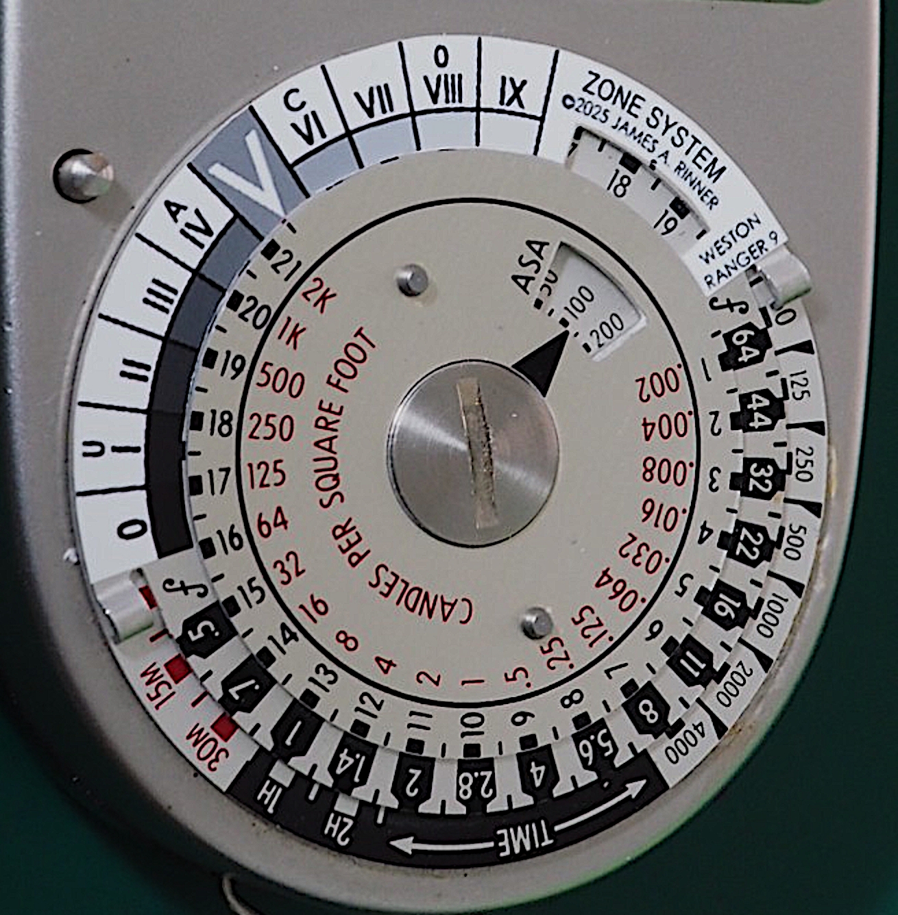

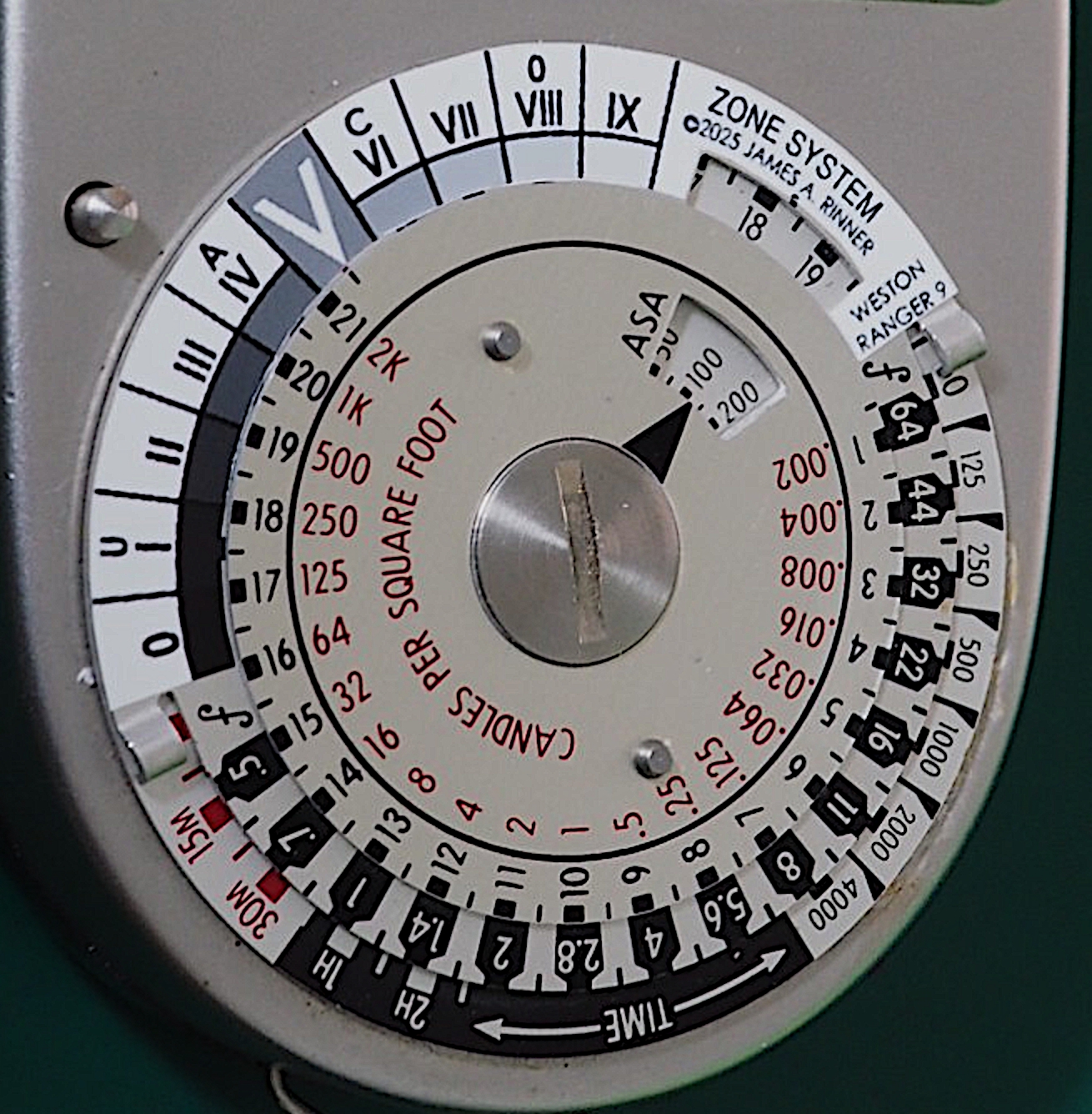

    Cool. There's a guy still selling stick-on Zone scales for various light-meters.
    www.shutterspeedblog.com/
    For a Weston Ranger 9:
    For a Pentax spot-meter:
    i.etsystatic.com/7602174/r/il/bb8424/4268443572/il_1588xN.4268443572_7xd3.jpg
    JPG, 1.1 MB, uploaded by xpatUSA on Jan. 4, 2026.

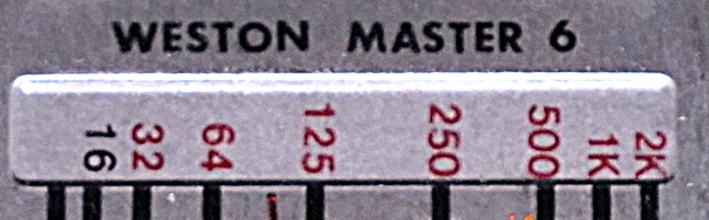

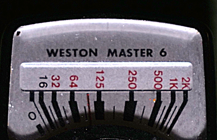

  • Members 1558 posts
    Jan. 8, 2026, 2:54 p.m.
    Do you remember the readings?
    I estimate that your spot-meter function should recommend about 14 Ev for concrete under that lighting. If you shot at f/8, that would work out to 1/256 sec - pretty close to my earlier estimate.
    Sorry to hear that. However, there is actually no need for a resistor in vintage selenium-cell light-meters; the meter itself is scaled to match the cell output characteristic i,e, scrunched up at both ends. See my earlier shot of the Weston 6 meter.
    See for example the difference in distance between 32-64 and 125-250. For true log scaling they would be equal distances.

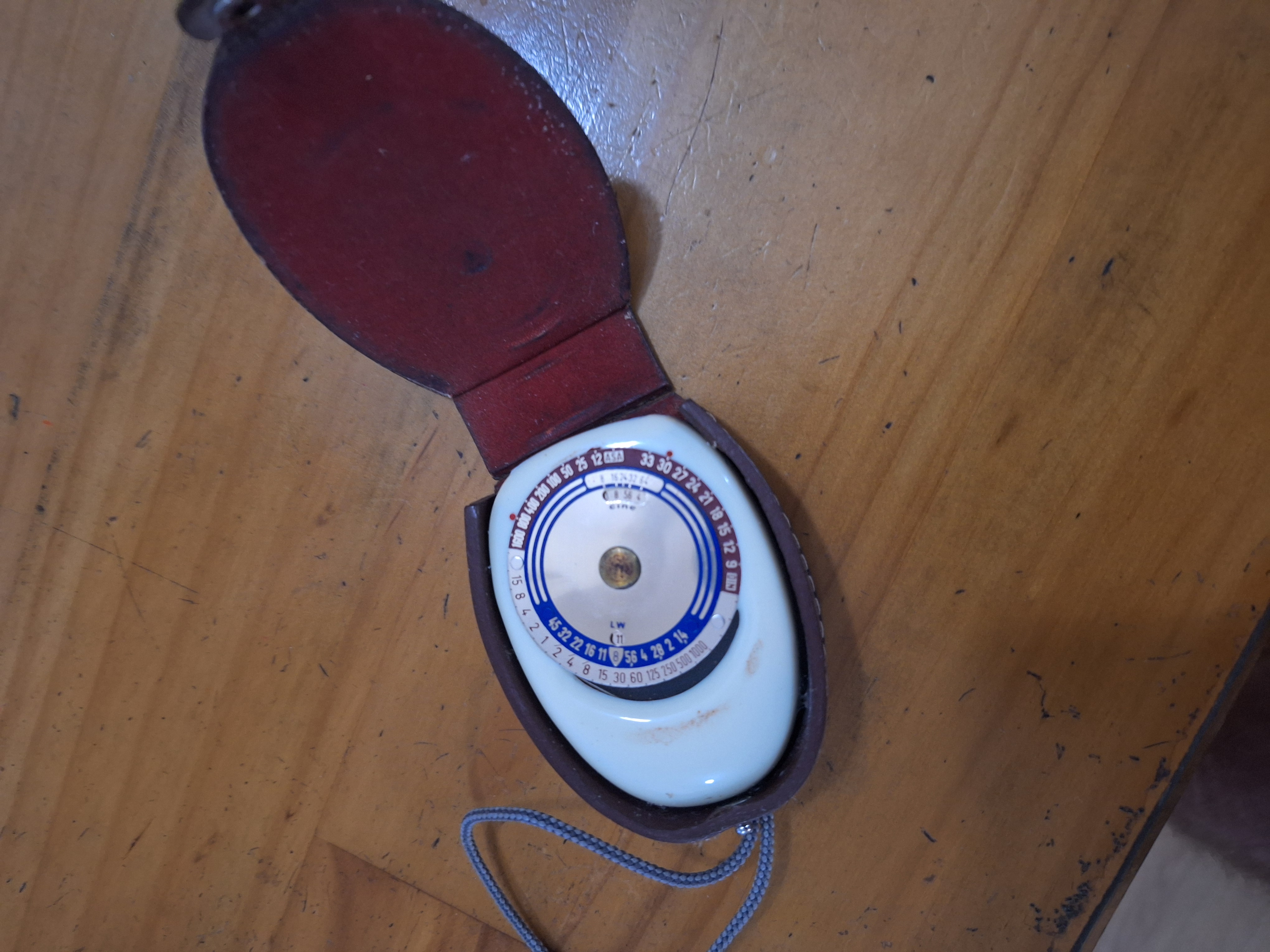

  • Members 2662 posts
    Jan. 9, 2026, 8:46 a.m.
    i will do another test and let you know what the readings are, i have a pentax ME somewhere, might have to find it and see what it reads.
    JPG, 3.1 MB, uploaded by DonaldB on Jan. 9, 2026.
