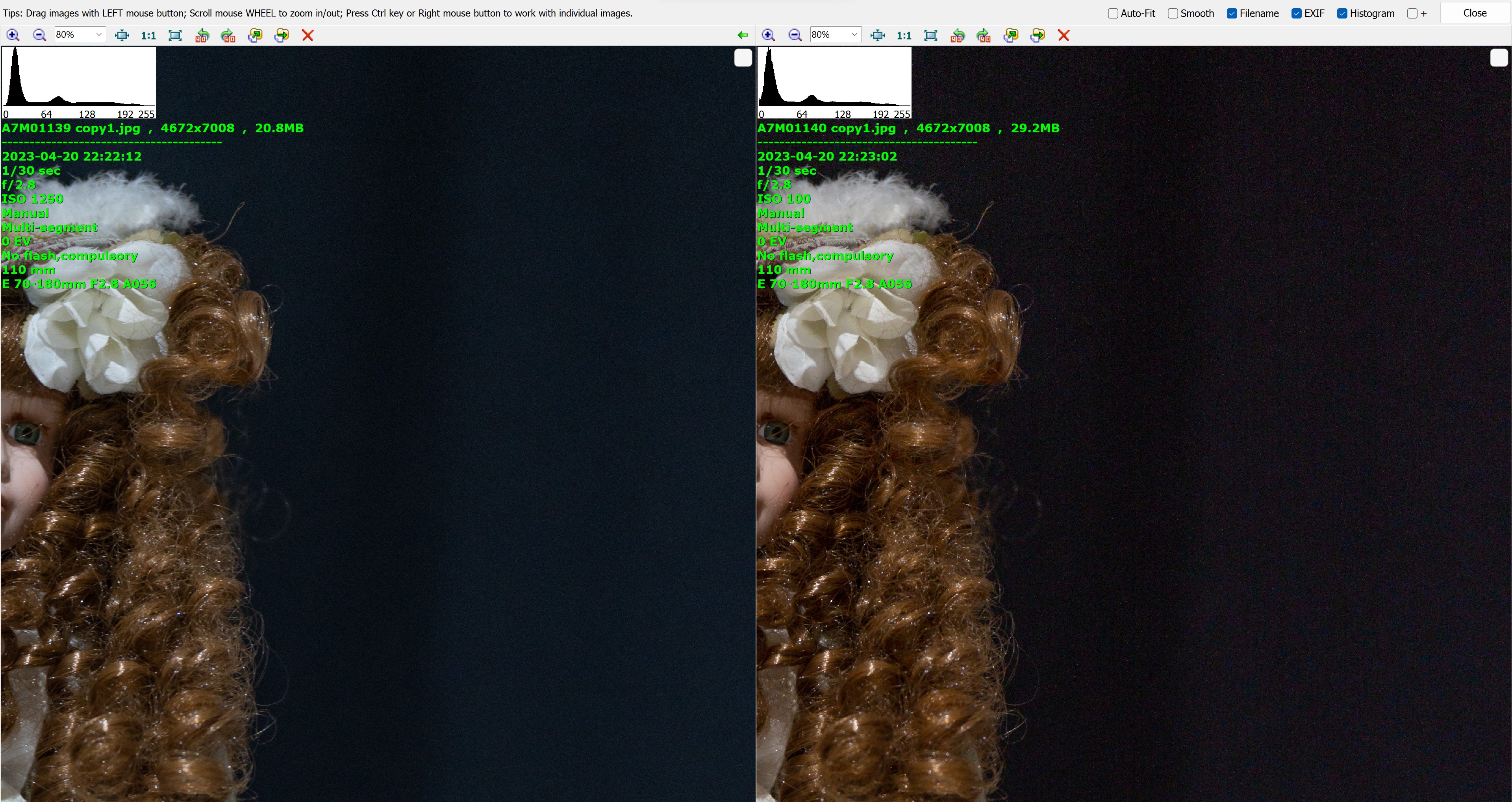

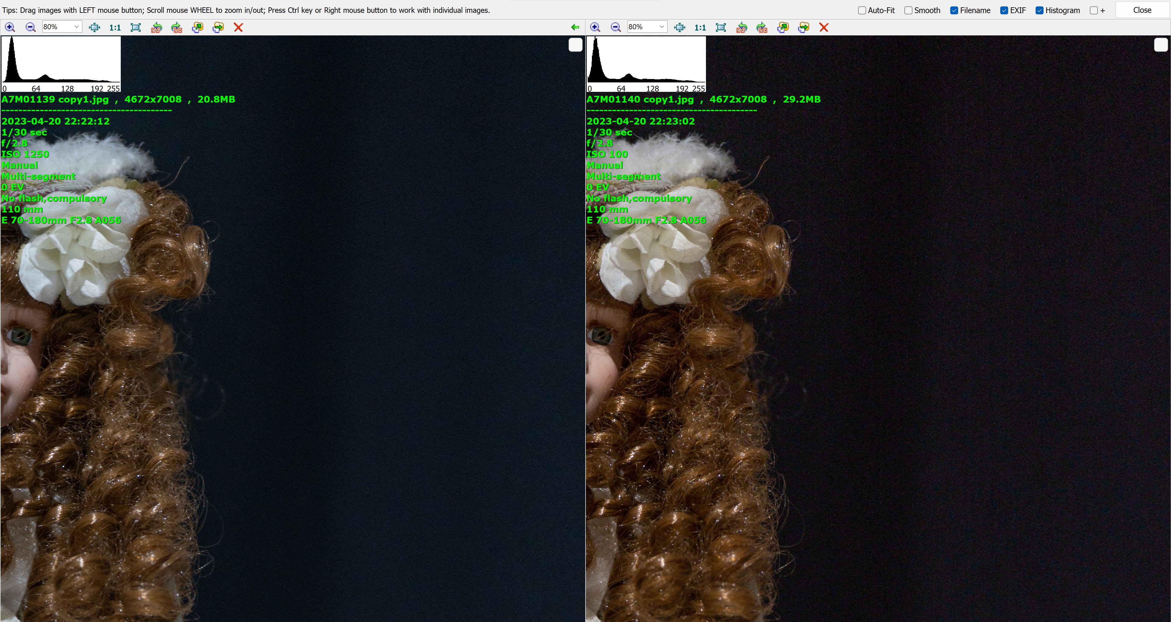

    April 20, 2023, 1:11 p.m.
    not so fast. someone with more knowledge could answer this

    April 20, 2023, 1:17 p.m.
    I can't verify what processing/editing might have been done to those images. Post links to the raw files.

    April 20, 2023, 1:35 p.m.
    The ISO 100 one looks brighter. Is that what you mean? If so, just reduce the settings in your raw editor until it looks the same. You can set the brightness in post to anything you want.
  • Members 976 posts
    Getting rid of the specular highlights may help exposing still life better ;)

  • Members 2661 posts
    April 20, 2023, 9:57 p.m.
    isnt that weird. last night i could see different noise patterns in the black background between the 2 images ,but this morning it is not visible due to ambient light hitting my monitor.
    April 20, 2023, 10:44 p.m.
    And that is exactly why you shouldn't calibrate monitors using your eyes as you said you did in another thread.
