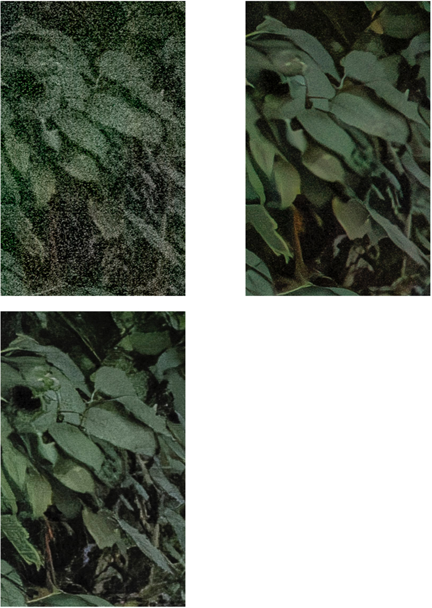

    Here is one comparison.
    Leica SL2 file, original: top left
    LrC with AI Denoise: top right
    DxO PhotoLab 6 with DeepPRIME XD: bottom left
    Edit: removed comment about added false details, corrected crop.
    Edit: this is a 348x556 pixels crop from an 8368 x 5584 image

    all comparisons sorely lacks screenshots of values used in NR sliders ( which PL has more than one ) ... hence useless ( who uses defaults ? )
    PS: correct me if I am wrong - but your 3 crops are not identical ( different offsets within the frame ) ?!
    PS2: unless you are talking about reproduction work - inventing details ( that is what any Ai-NR / demosaick / resize do ) is not always bad

    Yes, they are not identical. I forgot that the DxO generates different frames than the original (wider angle). I have fixed it.
    I typically always used defaults with DeepPRIME XD. I played with the three DxO sliders but did not see much improvement from what I got from the default.
    LrC has only one slider (enhance amount), which is much simpler.
