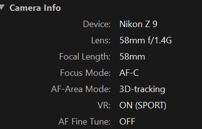

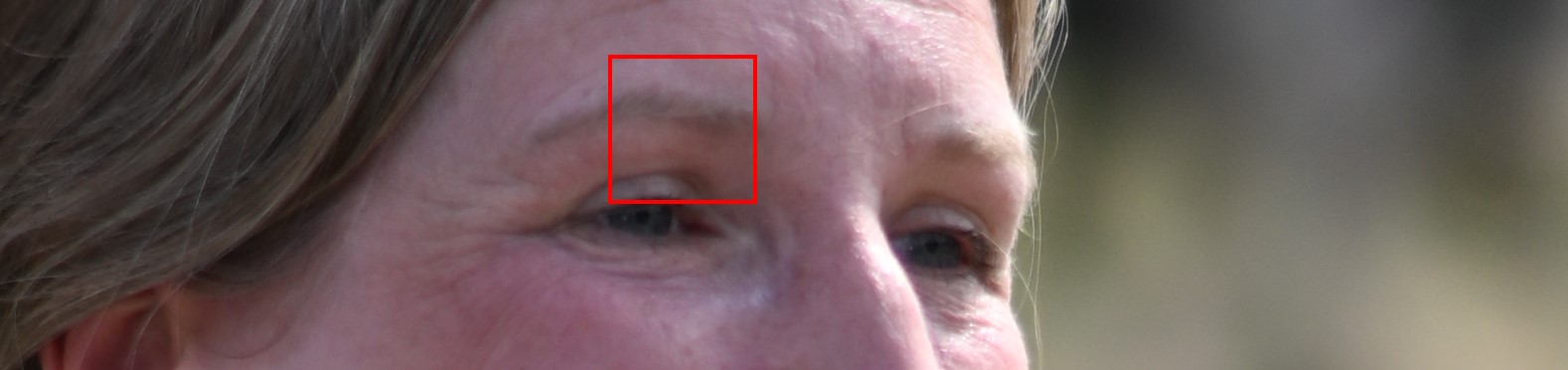

    Here is an example of what I am trying to understand.
    Eye detection was on, and the camera was saying it focused on the nearer eye, but actually focus is somewhat behind.
    JPG, 18.4 KB, uploaded by Dibyendu on May 1, 2023.
    JPG, 72.6 KB, uploaded by Dibyendu on May 1, 2023.

    Your "I'm trying to understand is different to the original question you posed" -- but OK - you consider the Af leads to a "back focus" issue.
    I recommend you Buy Recan FoCal and a target and complete their lens calibration test -- as noted in MY previous post some Af-S lenses benefit from AF-fine tuning -- and it looks like your setup may be one of these. These are your LENS and your BODY specific -- so just do it.
    Yes there are other tools you can use to identify if your "system" is focusing towards the front or rear -- including a ruler at 45 degrees -- but FoCal is the BEST by far I have used.
    MY 58/1.4 on my first Z9 benefited from -2.0 -- YOURS may be different. Go to the Settings menu and look for Af-fine tune and adjust the default for your lens to see when it is sharpest - use single point AF-S to start. AND obviously turn Af-fine tune ON.

    This is trickier than at first appears.
    First, the "focus point used" indicator is not always accurate. It is NOT where focus was made, it's generally where focus was acquired, which can be different. The indicator does not seem to be updated after acquisition in most modes.
    Second, you appear to have Subject Detection on while using 3D-tracking. There's considerable debate going on among those of us who test thoroughly as to whether that's the right approach or not. I'm now leaning towards, no, it isn't. 3D-tracking works most like DSLR 3D-tracking when Subject Detection is off. When Subject Detection is turned on, you get some interaction effects, including "seeing outside the box." These effects seemed to change with different versions of the firmware, as well.
