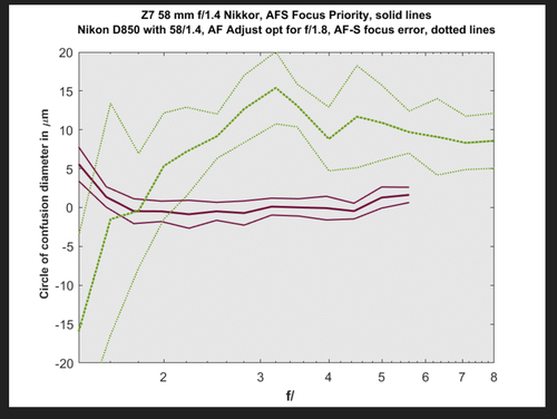

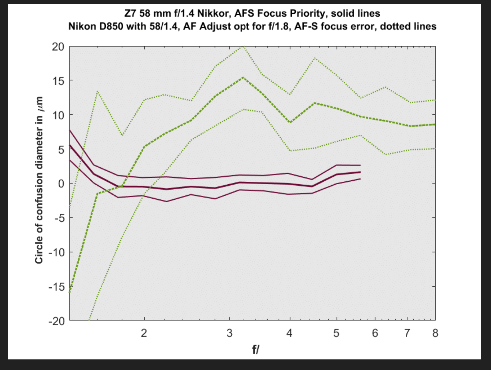

    Due to the way the phase detect light path works via the mirror relay on DSLRs, lenses faster than f/4 tended to have issues with focus accuracy/consistency, particularly if there was a lot of spherical aberration in the lens. You can see this with a tool like Reikan Focal pretty clearly. The mirrorless cameras see the full context of the lens (and the lenses have less aberrations/coma), and have proven to be more consistent/accurate in lab testing. Look for Marianne's analysis of the DSLR phase detect technology on dpreview; it goes into detail about some of the DSLR issues.

    Again, look at Marianne's comments about what portion of the lens image circle the DSLR system sees for fast lenses, and the issues with edge performance.
    To answer your specific question, I've found the Z cameras to be more accurate with focus at f/1.4 with DSLR lenses than the DSLRs (don't have any f/1.2 F-mount lenses). Like JimK, I can vouch for the 58mm f/1.4 and 105mm f/1.4, which were two of my favorite DSLR lenses. They just perform more accurately on the Z's.

    I have not seen a focus accuracy difference between F-mount and Z-mount lenses on a Z9. I have seen a focus speed difference between a Z9 with F-mount lenses and my D6 (the Z9 is generally faster).
    Since you mention AF-C and people specifically, I believe you're also using Subject Detection. This becomes one of those "how was the AI trained?" questions very quickly, which is unanswerable. The focus data stream the algorithms are using is coming from the EVF stream on a Z9. Nikon hasn't given any technical information on how that actually works. I'd be curious whether you see a difference based upon the CSM #D20 setting.

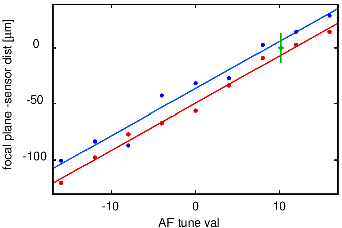

    What also appears clear is the a Nikkor AF-S F-mount lens works very well on the Z9 -- but one MAY see benefits if one uses FoCal to optimise the AF-fine tuning (there are a growing number of us who have completed Focal tests and posted results for both Z and AF-S glass) -- in summary most Z-mount glass "needs" no fine tuning - but there have been some individual lenses which may be towards the edge of manufacturing tolerances and some have seen minor benefits from changing these settings for these lenses as well. Whereas there is a growing body of test results (so not just mine) that show AF-S glass can benefit from minor AF-fine tune adjustments when used on Z bodies (including the Z9).

    I recommend you Buy Recan FoCal and a target and complete their lens calibration test -- as noted in MY previous post some Af-S lenses benefit from AF-fine tuning -- and it looks like your setup may be one of these. These are your LENS and your BODY specific -- so just do it.
    Yes there are other tools you can use to identify if your "system" is focusing towards the front or rear -- including a ruler at 45 degrees -- but FoCal is the BEST by far I have used.
    MY 58/1.4 on my first Z9 benefited from -2.0 -- YOURS may be different. Go to the Settings menu and look for Af-fine tune and adjust the default for your lens to see when it is sharpest - use single point AF-S to start. AND obviously turn Af-fine tune ON.
