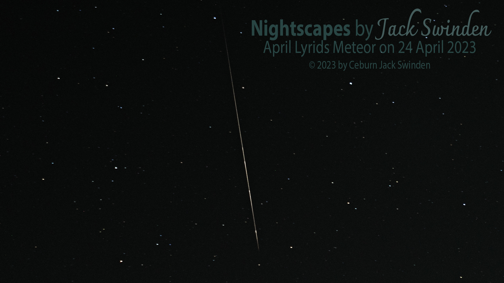

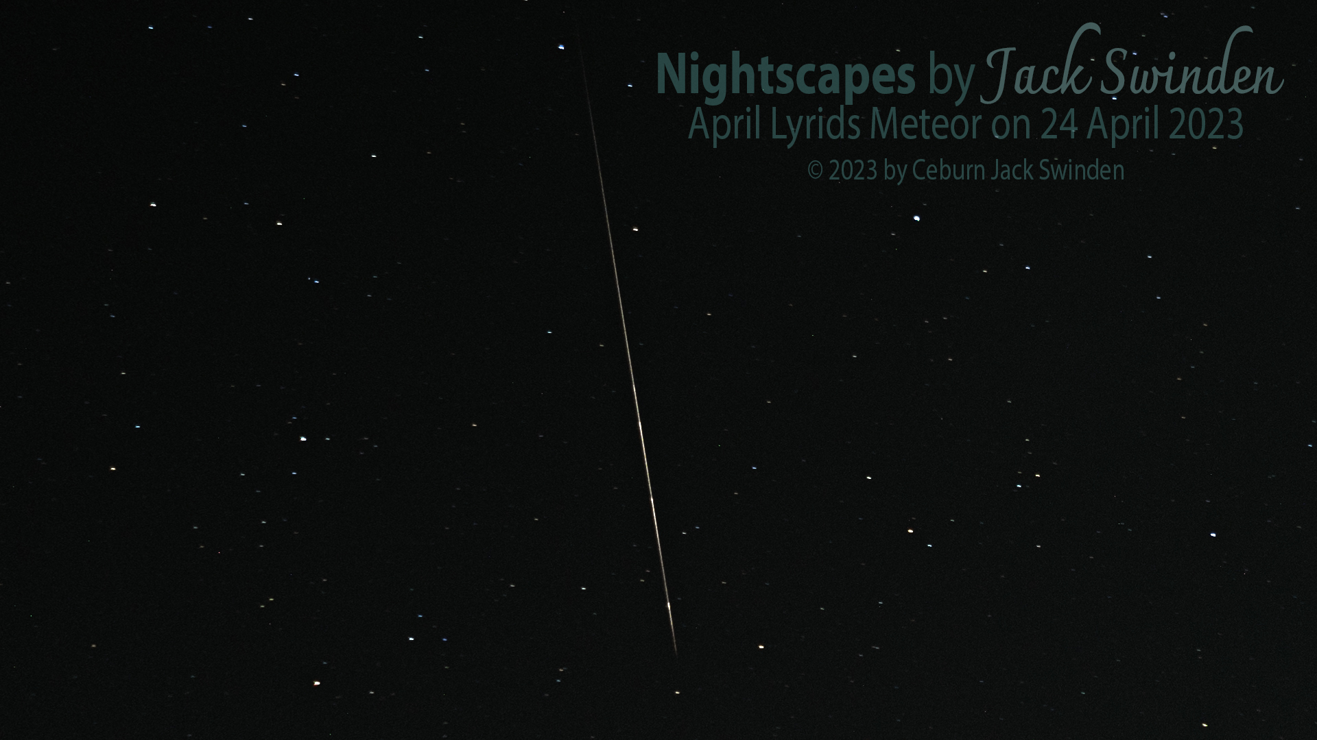

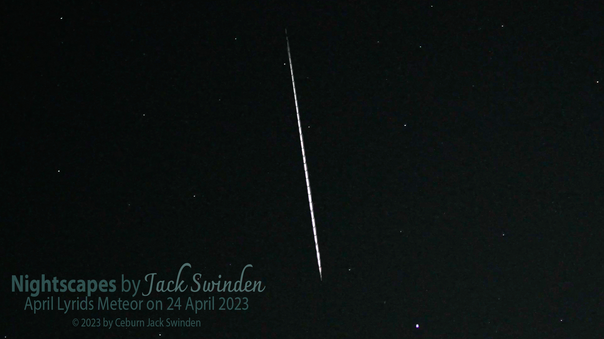

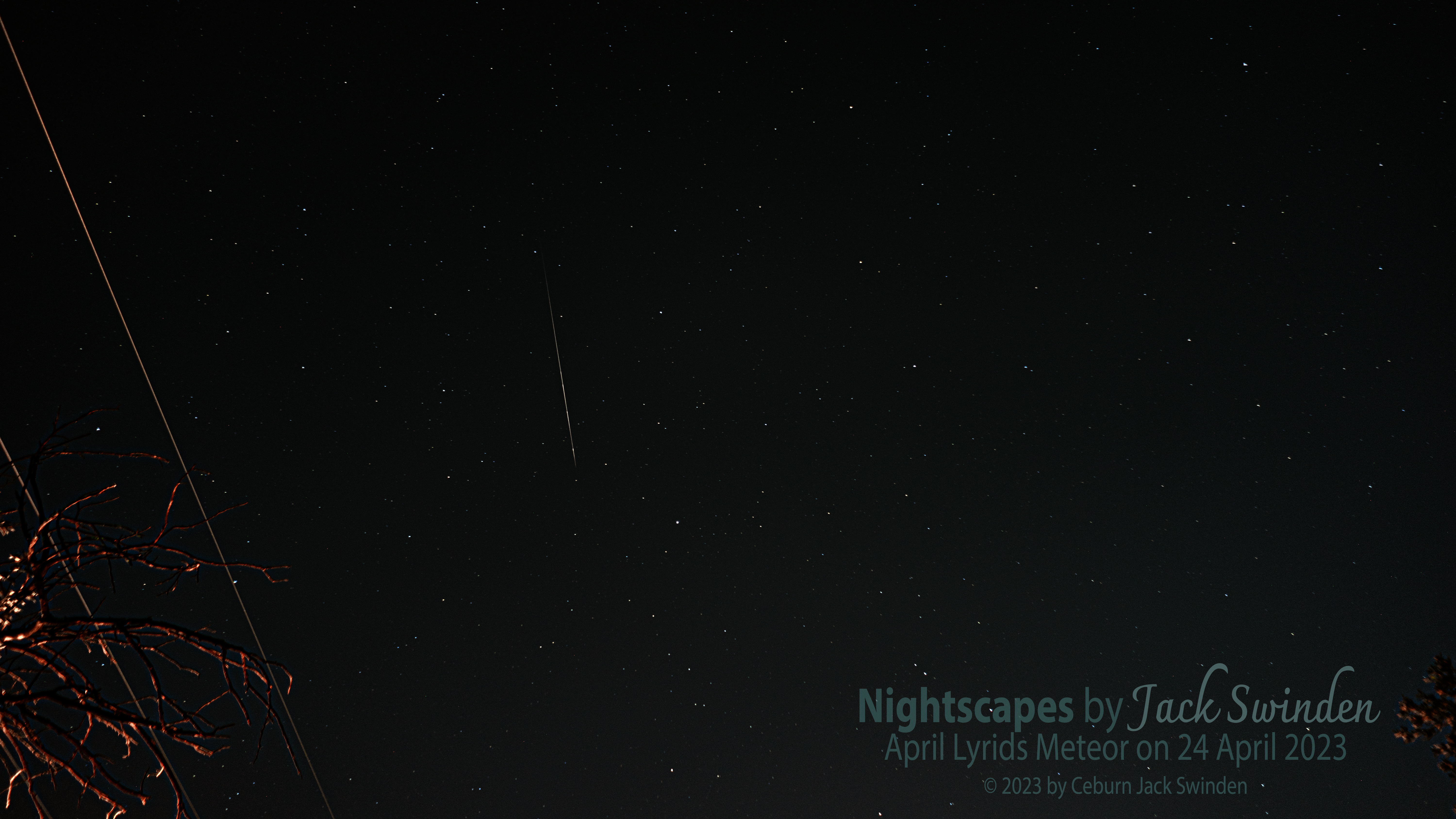

    This is a video of an April Lyrids meteor captured on 24 April 2023 using my Sony ZV-E10 with Rokinon 20mm t/1.9 lens at 01:05 CDT (06:05 UTC) in Everman, Texas. Video was shot in true 4K using 24p 60M. The video shows the full size image at normal speed, then shows a cropped in view at normal speed, then finally shows a cropped in view at 1/10th speed so you can see how the meteor flares multiple times and understand how that will look when captured within a long, still image photo.
    April Lyrids meteor
    I also captured a still image of this meteor with my Sony a7 camera with a FE 28mm f/2 lens and have shown a full and a cropped view of that too.
    JPG, 3.4 MB, uploaded by W5JCK on April 25, 2023.
    JPG, 342.7 KB, uploaded by W5JCK on April 25, 2023.

    Very cool. Must have been fun trying to capture!

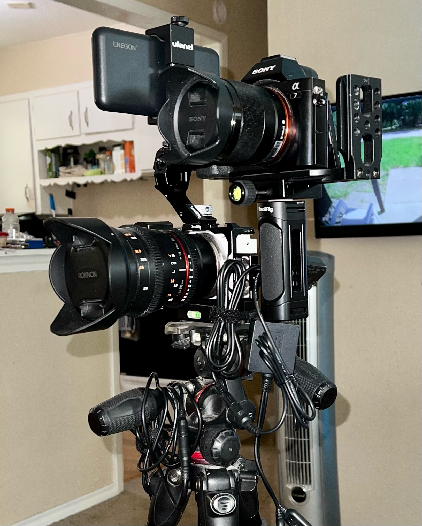

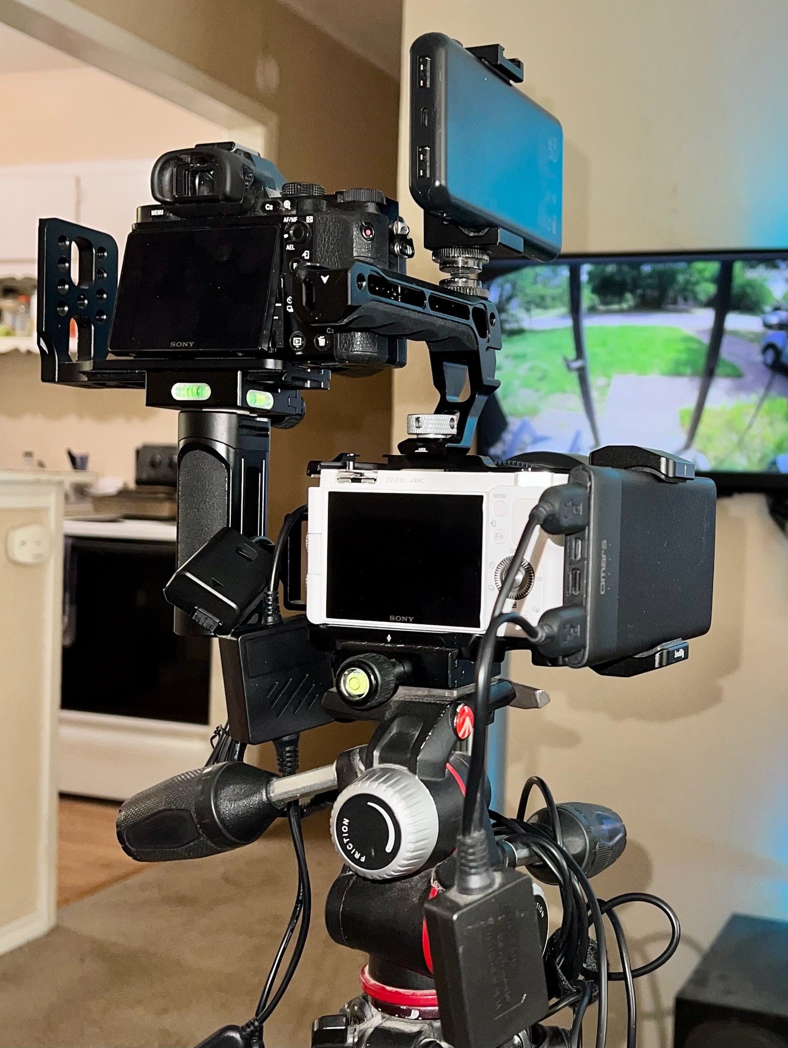

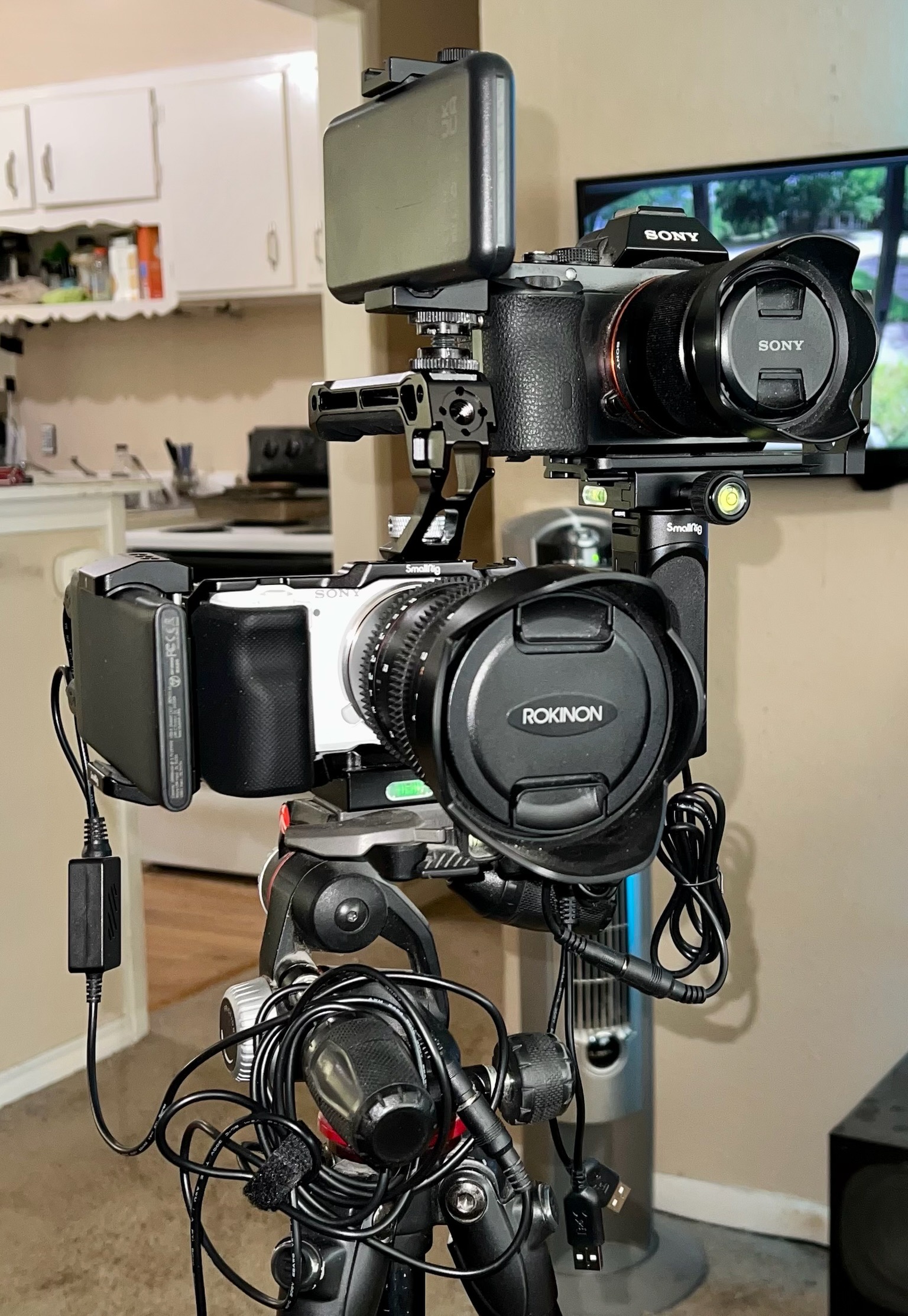

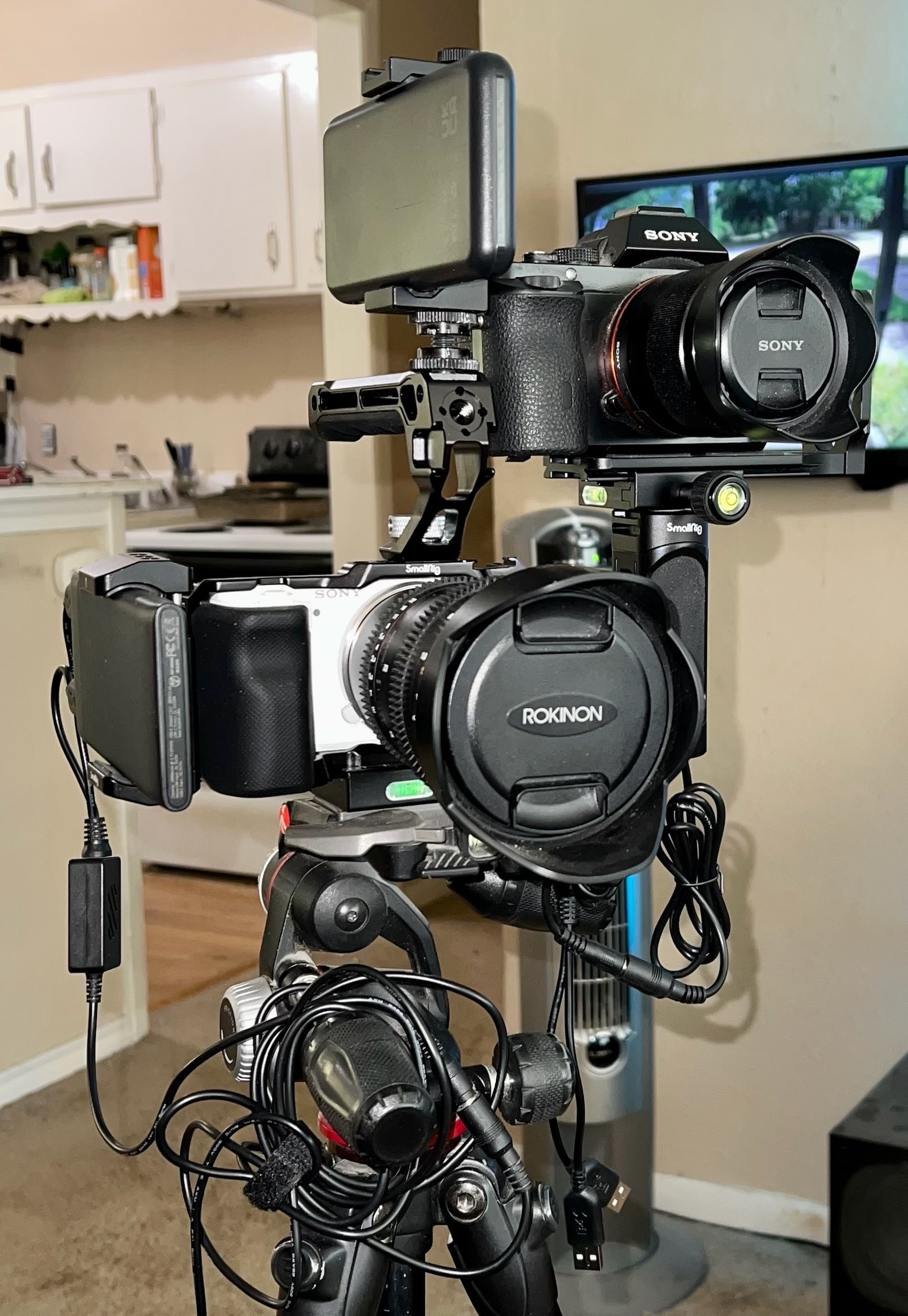

    I have to admit I love a challenge. I shoot in Bortle 8 sky with a lot of light pollution, so it is even more challenging than in dark sky. I built a rig to capture both video and photos at the same time. I used a Sony ZV-E10 with Rokinon 20mm t/1.9 lens for video and a Sony a7 with FE 28mm f/2 for time lapse photos.
    JPG, 728.9 KB, uploaded by W5JCK on April 25, 2023.
    JPG, 770.7 KB, uploaded by W5JCK on April 25, 2023.
    JPG, 758.0 KB, uploaded by W5JCK on April 25, 2023.

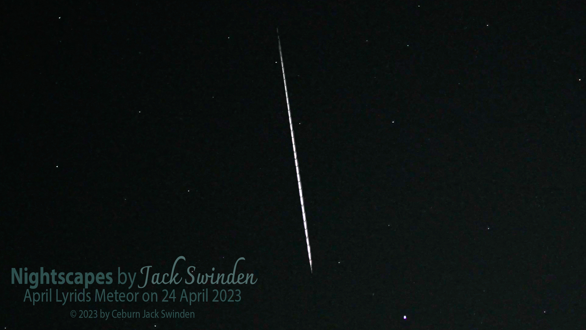

    Interestingly enough when you compare the dimness of the meteor track in the 15 sec photo to that in the slow motion video, the photo makes the meteor look dimmer than Spica but the video frames make it look brighter than Spica, way brighter. So you might be on to something. This meteor lasted about 1.3 sec. The 15 sec exposure allows Spica and friends to gather a lot of light, but the short duration of the meteor at only 1.3 sec doesn’t get the opportunity to gather nearly as much light. Even if the meteor is mag 1 and a star is also mag 1, the star will look brighter because it pumps out mag 1 for 15 sec but the meteor is only in a single frame for 1/25th sec. Granted I suspect that there is some overlapping over multiple frames, but it will still be rather dim in the final photo. In the video, every frame is only 1/25th sec so the meteor and Spica only expose for that brief amount of time allowing the meteor to look brighter in each frame, but in the photo Spica gets 15 sec to gather light so it looks brighter. I’m going to separate out all 32 frames which include a portion of the meteor and stack them in order to compare it to the image in the photo. I’ll post the results.
  • Members 37 posts

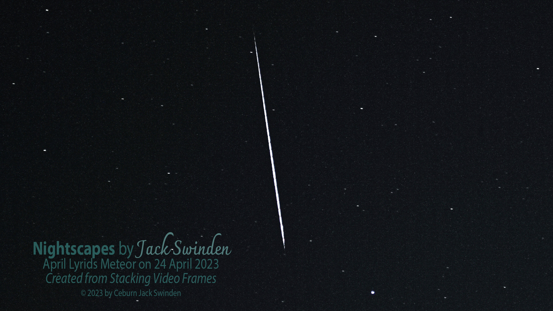

    April 26, 2023, 6:52 p.m.
    I imported into Photoshop a short version of my video containing just the meteor frames. I then had PS extract all the frames as 16-bit TIFFs and cropped out everything in each frame except the meteor. That was time consuming! I then stacked those frames over a duplicate of one of the frames that contained the background and I got a brighter trail than the 15 sec photo showed. Unfortunately there are portions between each frame that show black. I think this might just be that the camera used a tiny bit of time recording the frame and thus didn't capture the complete trail. So the result is a bit segmented.
    [Edited to add:] It just dawned on me that my camera was shooting 24 fps but using the slightly faster 1/25th sec setting. I wonder if that very small difference can cause the one pixel breaks between the frames?[End of edit]
    Overall I prefer the 15 sec photo view of the meteor, but the video view is definitely brighter and looks way more cool when it is watched in motion.
    15 sec photo
    Frame overlaps from video
    JPG, 903.4 KB, uploaded by W5JCK on April 26, 2023.
    JPG, 1.0 MB, uploaded by W5JCK on April 26, 2023.
  • Members 30 posts
    April 27, 2023, 7:17 p.m.
    Makes sense to shoot longer brighter lenses till you get a 16/1.4. Although your chances of catching a complete event are reduced, it should look better when/if you do.
    Regarding the differences in brightness. I'm thinking contrast might have a roll to play here. Just like when dim objects are observed from dark sky sites, they appear to be brighter.
    I have been wanting to extract individual frames from footage, and wondered how to do so. I didn't realize Photoshop could do so, so thanks for mentioning it. I'll have to give it a try.
    Very interesting to see your comparison between the 15s exposure and the stacked frames. It really jumps out how much brighter the meteor looks in the stack, but at the expense of background/star detail (and more crucially, light pollution). I think you just proved my point there regarding the benefits of shooting footage vs long exposure stills from light polluted sites Jack! :)

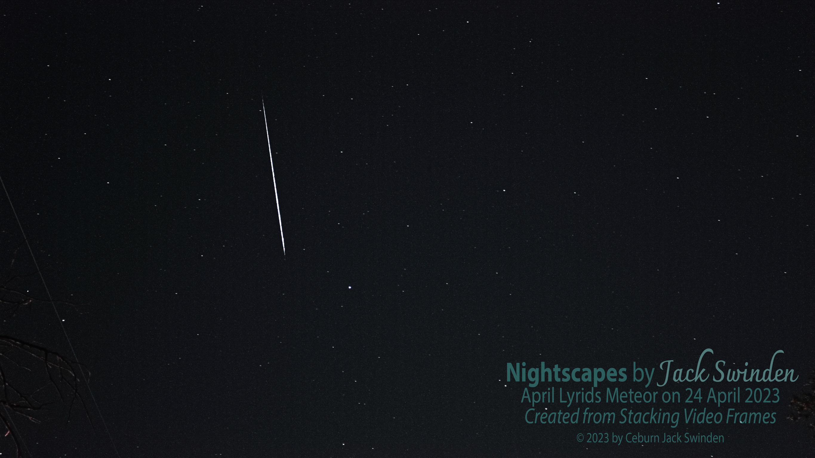

  • Members 37 posts
    April 30, 2023, 11:43 p.m.
    I took the extracted frames (images thereof) which I had meticulously edited to extract the meteor bits and decided there might be a better way, not to mention easier and much quicker, to get a trail of the meteor. Kind of puzzled why I didn’t do this the first time rather than editing nearly 40 frames.
    I extracted the frames again and made sure I extracted enough frames to cover 18 seconds of elapsed time. I then loaded these into StarStaX and let it create a meteor trail. I use it for star trails, but it does well for meteor trails too. I used 18 seconds worth (about 430 frames) so that the stars would trail slightly and thus look bigger and better in the image. The video was shot 24 fps at ISO 16,000 so the stars were tiny. Any way, here is the StarStaX images.
    Full image:
    Zoomed image:
    JPG, 711.0 KB, uploaded by W5JCK on April 30, 2023.
    JPG, 1.2 MB, uploaded by W5JCK on April 30, 2023.

  • Members 81 posts
    May 9, 2023, 2:55 a.m.
    Nice rig Jack!
  • Members 37 posts
    May 9, 2023, 9:25 p.m.
    Thanks. A bit heavy, but it works. I’ve been experimenting using my little RX100 iii as the time lapse camera to lessen the weight. It does a decent job too.
