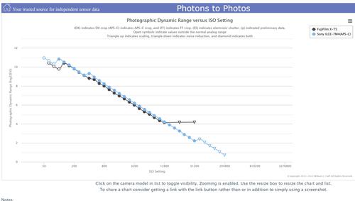

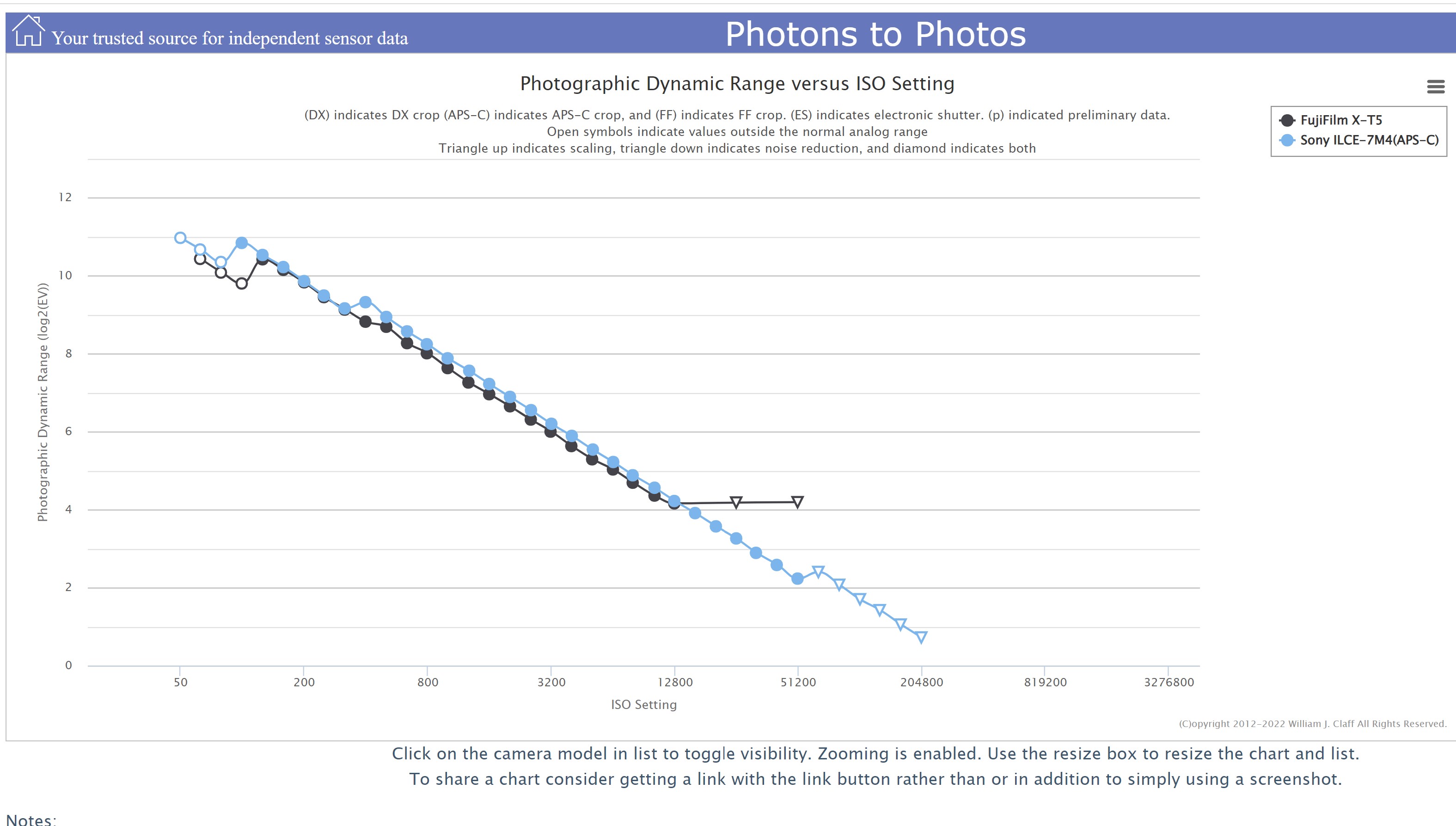

    @bobn2 has written:
    @ArvoJ has written:
    @bobn2 has written:
    And most people don't really know what 'PDR' represents - not their fault - it's not at all clear.
    From www.photonstophotos.net/GeneralTopics/Sensors_&_Raw/Sensor_Analysis_Primer/Engineering_and_Photographic_Dynamic_Range.htm:
    My definition of Photographic Dynamic Range is a low endpoint with an SNR of 20 when adjusted for the appropriate Circle Of Confusion (COC) for the sensor.
    For me this was first time encountering this PDR thing too.
    It still doesn't tell you what it represents, just what Bill's definition is. And why you'd want a SNR of 20 in the deep shadows is beyond me. Something like 2 does just fine.
    IMHO the bigger issue, and not only going by the two screenshots posted in this very thread, is comparing PDR for the sensors of different sizes to compare the "state of the art".
    IMHO 20 is fine for film because of the character of the grain in standard development, and more or less OK for JPEGs as of ~2 years ago.
    bobn2
    Team 2240 posts
    July 15, 2023, 9:24 p.m. July 15, 2023, 9:24 p.m.
    @IliahBorg has written:
    @bobn2 has written:
    Yes, that's certainly an issue.
    20 as the lower bound? Do you need an SNR of 20 in the deepest shadows, zone 1?
    Donald, is it about the sensor not being "state of the art", or just about the sensor size?
    Take 2 shots with an X-T5 and see how the result compares with an ILCE-7RM5.

    @bobn2 has written:
    @bobn2 has written:
    Where there is no texture, only slight tonal gradation, some like those to be smooth.

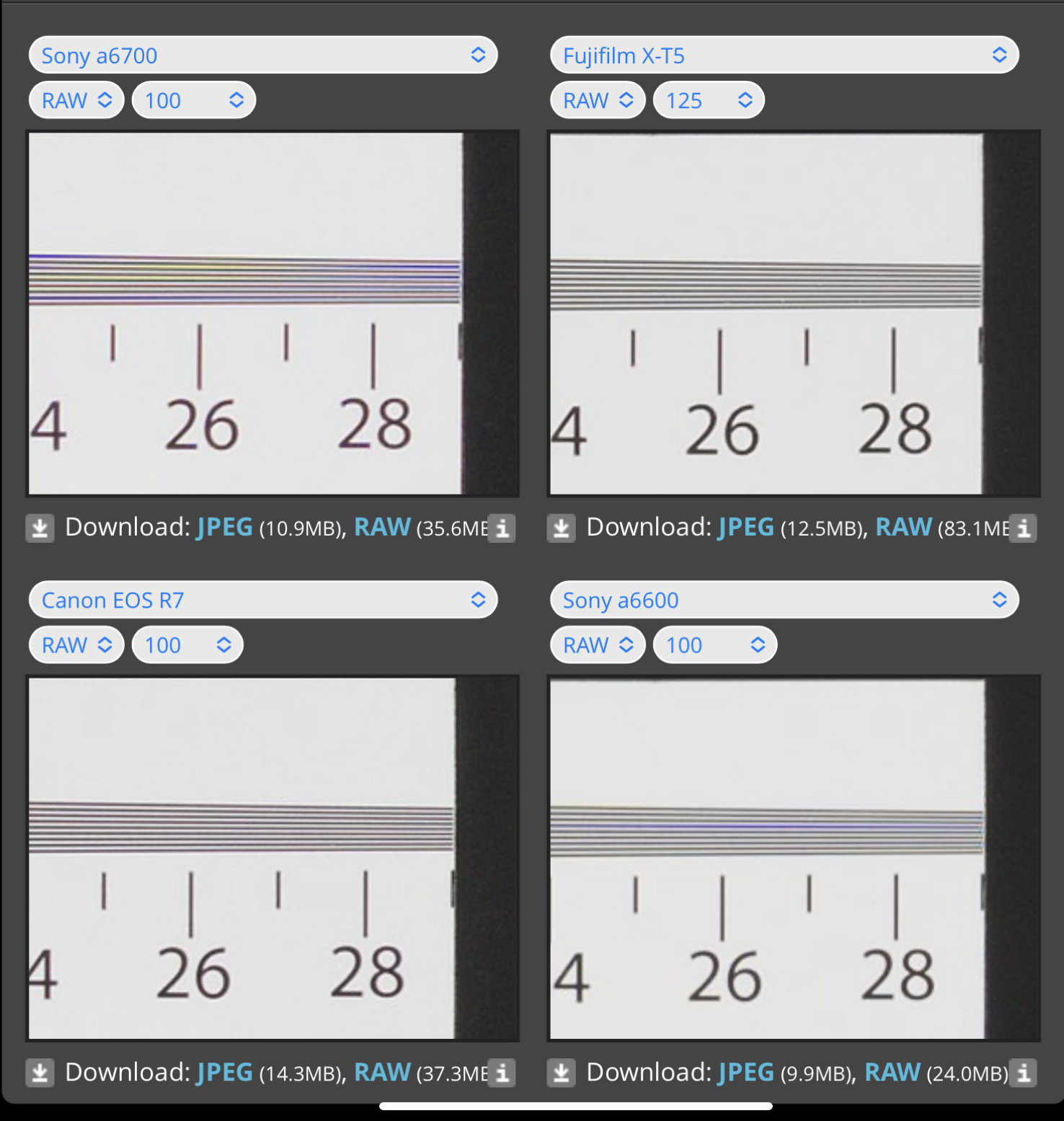

    @DonaldB has written:
    at pixel level i will take the a7m4 larger pixels anyday of the week.
    PNG, 69.7 KB, uploaded by IliahBorg on July 15, 2023.
    40 meg vers 14 meg
    JPG, 427.2 KB, uploaded by DonaldB on July 15, 2023.
    40 meg vers 14 meg
    "Larger pixels, anyday" :)
    DonaldB
    Members 2657 posts
    July 15, 2023, 10:51 p.m. July 15, 2023, 10:51 p.m.
    40 meg vers 14 meg
    xt5 3.04um a74 4.92um 4 or 10 x microscope objective min 5.0 um as they are effectivly f16 so xt5 would be useless for me.
    smaller pixels cannot record finer detail period.
    IliahBorg
    Members 976 posts
    July 15, 2023, 10:54 p.m. July 15, 2023, 10:54 p.m.
    LOL
    LOL
    checkmate 😎😁

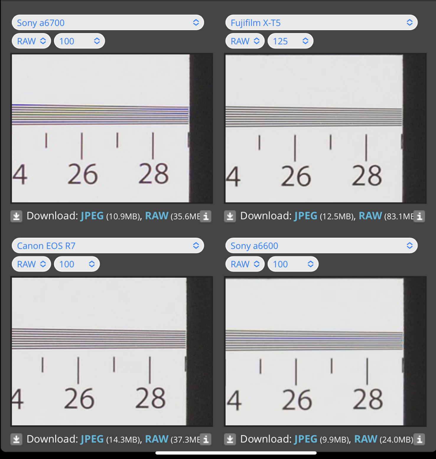

    TheDavinator
    Members 621 posts
    Aug. 3, 2023, 6:23 p.m. Aug. 3, 2023, 6:23 p.m.
    It’s definitely a moire beast compared to others.

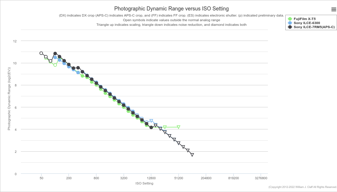

    @AlexeyK77 has written:
    I don't find information on ptonots to photos about sensor in 6700\fx30, but all state of the art sensors made by sony, and may be for top sensor better to look at A7r-m5 sensor:
    What do you believe PDR proves? I have no problem with people creating sensor metrics, but you must interpret them in light of what they are actually capable of saying. PDR is not a measure of noise performance, relative to exposure. It is a measurement of how far below the highest number in the bit depth of the raw Bill's standard of minimal image-level SNR lies. It has no direct indication of noise vs exposure. DR and PDR at higher ISOs than base are fluff, with no substance. You can modulate the PDR or DR with the same sensor at high ISOs just by changing the amount of headroom in the raw, using the exact same sensor, just like Canon does with HTP vs non-HTP. If Bill graphed Canon's HTP measurements, instead of the non-HTP ones, Canon would come out as king of PDR or DR at ISOs above base, even though HTP is slightly noisier (2x the post-gain read noise) than non-HTP.
    JohnSheehyRev
    Members 591 posts
    Aug. 4, 2023, 2:09 p.m. Aug. 4, 2023, 2:09 p.m.
    @ArvoJ has written:
    @bobn2 has written:
    With such a high threshold of SNR, the metric is heavily weighted towards photon noise and is most relevant to those who don't want to see noise at all; not those who work in very limited light where there is lots of read noise guaranteed. Even when that is understood, though, there is still no direct connection between PDR and exposure-referred noise, because the headroom range is undefined. It can give "true negatives", though, as a very bad PDR for a specific camera at higher ISOs probably does mean either a lot of noise or insufficient headroom for normal exposure. A very good PDR at high ISOs, however, proves squat about noise because it may be due to extra headroom, alone.
    40 meg vers 14 meg
    Perhaps you meant, "AOTBE", 100% pixel levels views generally look softer and noisier with higher pixel densities, but that is actually a good thing if you want the most malleable, artifact-free captures. Proper sampling is not a defect or artifact..
