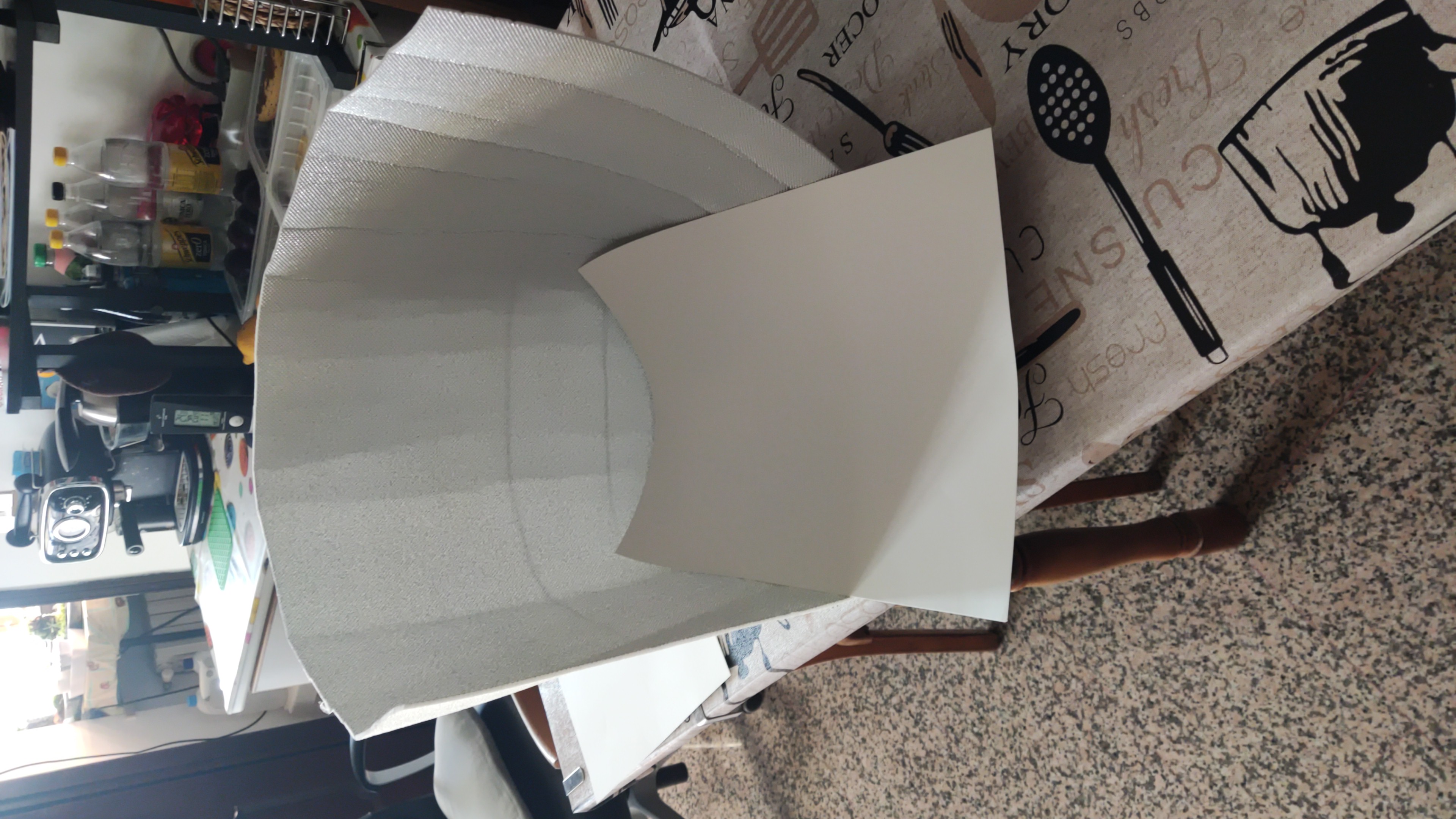

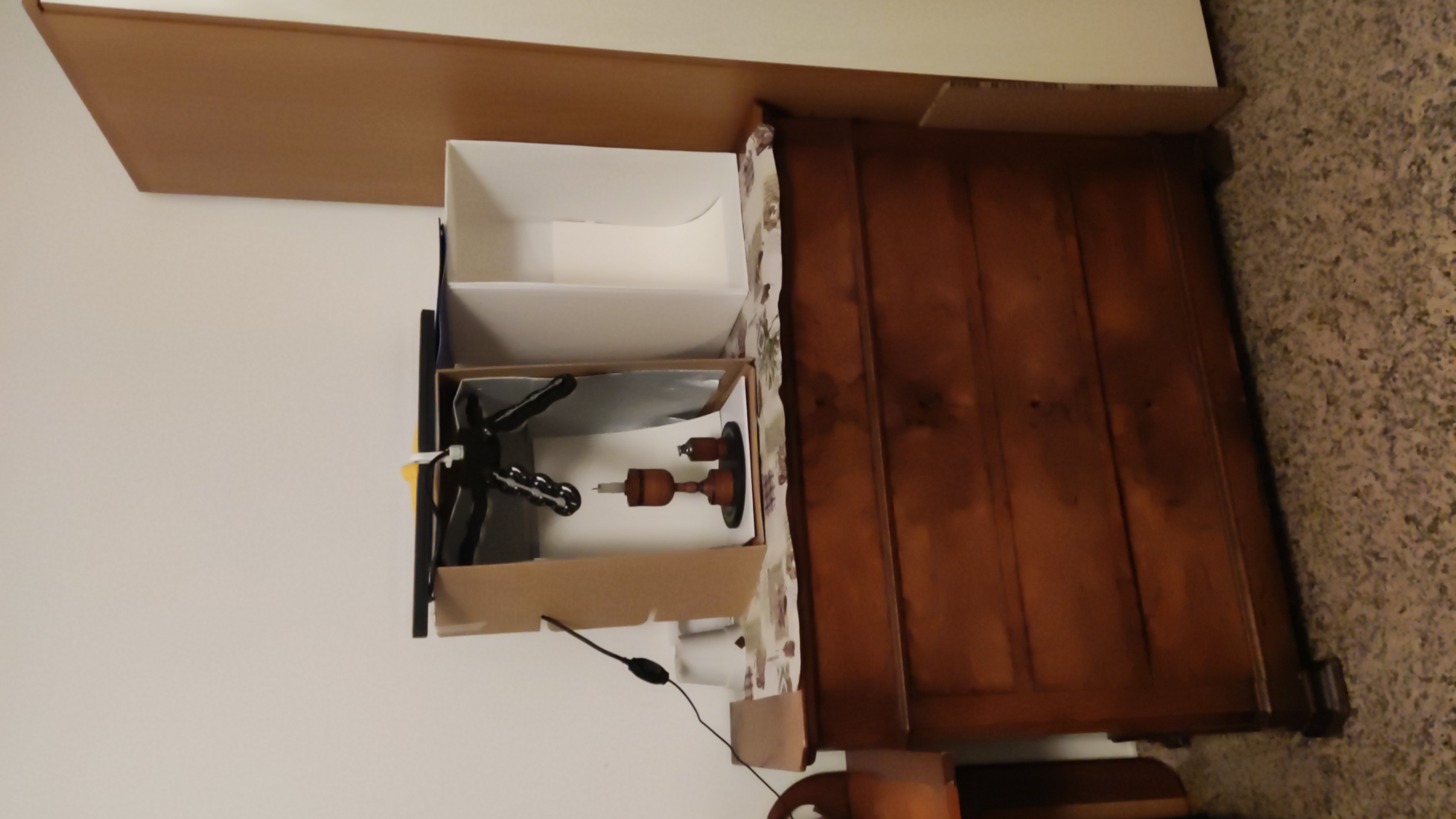

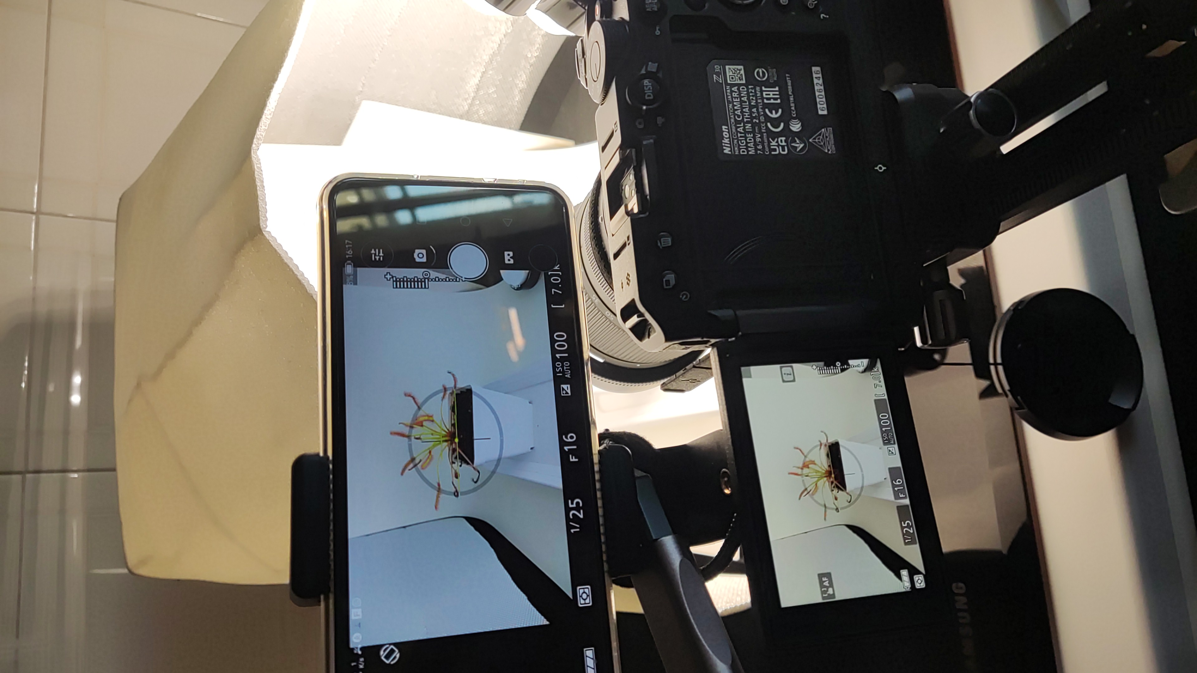

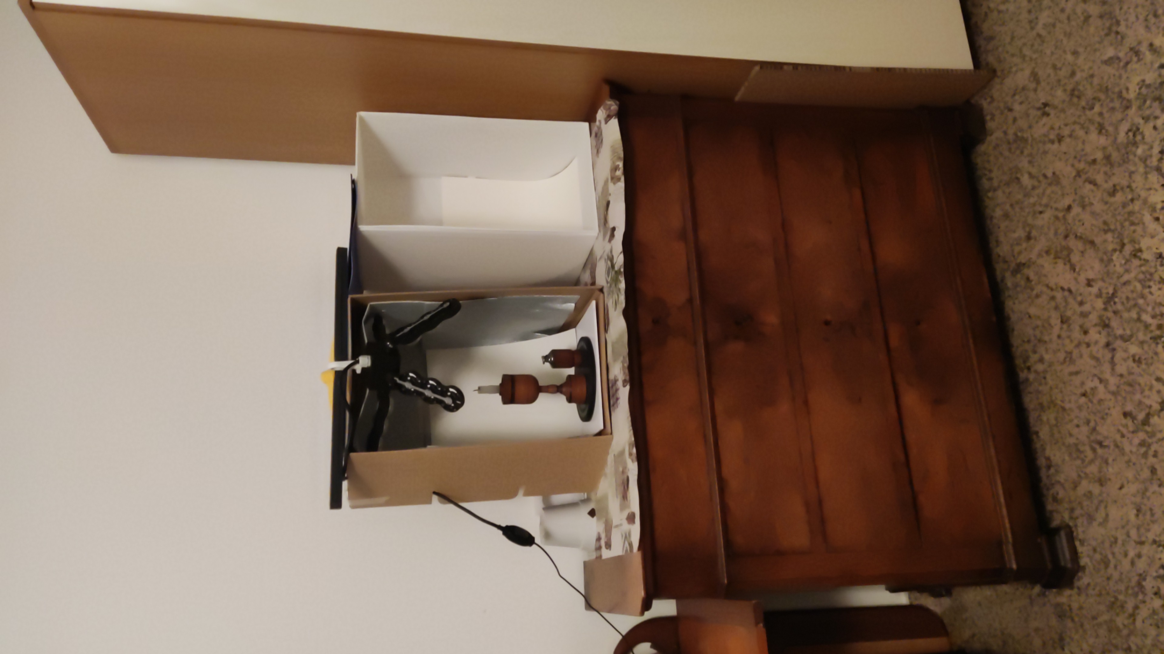

    I'm sure it's not the answer to your question...
    ... but this is are some contraptions I've made in a pinch with a thermo-foam and some sewing needles.
    this surface was really Orange-Like and diffused quite well the light... cannot find the results at the moment
    I will post them if interested
    ( I give for free bad ideas - the good ones I keep for myself)

    I really like those. I might try that myself.

    thats not really a beauty dish. More a reflector
    For a Beauty Dish, it will have said Dish covering the strobe bulb. It will create a shadow area in the middle of the beam. its like a softbox just reverse, where the softbox got the brightest spot in the center, the beauty dish has its brightest "ring" at the outside.
    The surface will give you different output quality,
    Silver will give you lot specularity, while white will reduce the specularity. There are Beauty Dishes with a varitety of different types of inserts, silver ones, white or semi transp acrylic, doubled up or like a disc with loads of holes. this will alter the apperance of the middle area, giving you diffrent looks. I have one with a brownish insert, making the light tiny bit more orangy brownish to please skin tones.
    the more shiny your surface is, the more your specular highlights will be pronounced.

    Yes. Indeed. I guess I wasn't being very clear.
    Incidentally, to focus a reflector like that, we'd need a means to adjust the position of the strobe bulb along the axis of the reflector. I don't know how anyone is supposed to do that.

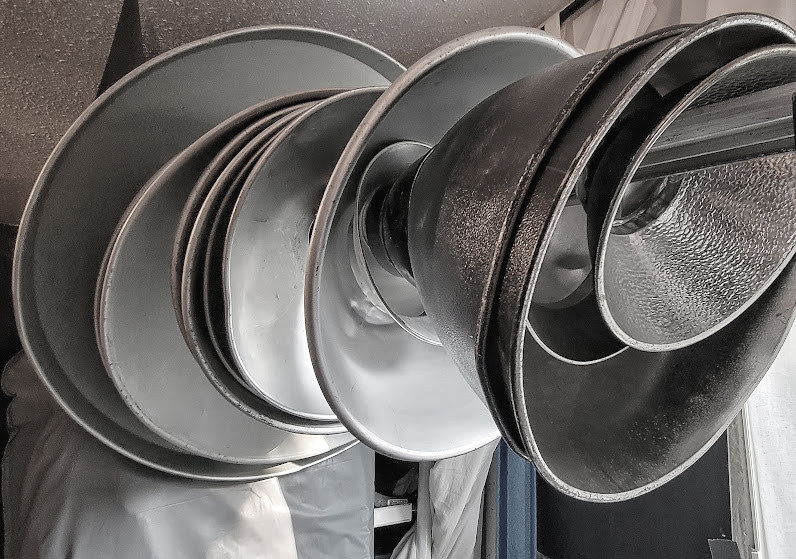

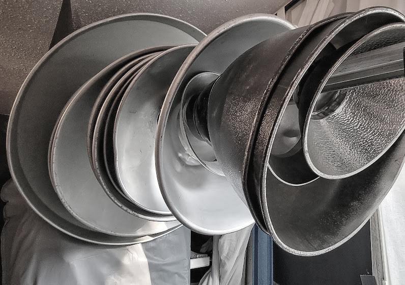

    As a commercial and portrait photographer I have accumulated many lights over the decades and still have quite an inventory of reflection of all those lights. The attached image shows only a small portion of these reflectors. I did not photogah all of my collection (hoard) because I fear for my health and safety in opening the door to that storage closet- I might be crushed- someday I'll reorganize it!

    As per my experience as to the reflective surface of say a parabolic (metal) reflector, I find very little difference between a spun aluminum, satin, or pebbled surface finish perha just a bit more light output. The size and distance tables yied more noticeable changes. And all parabolic reflectors are not created equal, they can differ differe in depth.

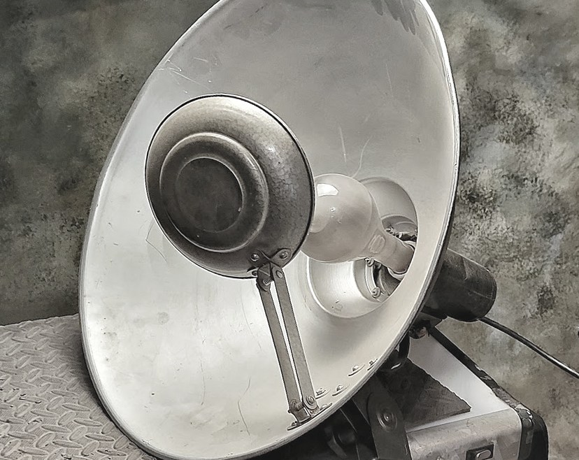

    All right, I can hear it now "Shapiro, for heaven's sake, what the hell does this have to do wi a BEAUTY DISH? I have been using a beauty dish since 1962, before they called it a " BEAUTY"-dish. I still have my 1950 s made "semi-psrabolic witt central deflector. But the beaut light can be an ugly light the light is ot applied with savvy. The central cap eliminates the hot spot so precise feathering is not practical and the effect is softer and somewhat lackluster as a result. The unt itself is big and ugly and utilizes a 100O watt (3200K) #4 Photoflood lamp. The beaut light will not automatically impart "beauty" on any given subject and the lighting may be lackluster unless you learn to control that central deflector- there are many differet nuances. Unless the surface is mirrorlike and highly polished the difference in effect between satin and stippled surface is minimal.
