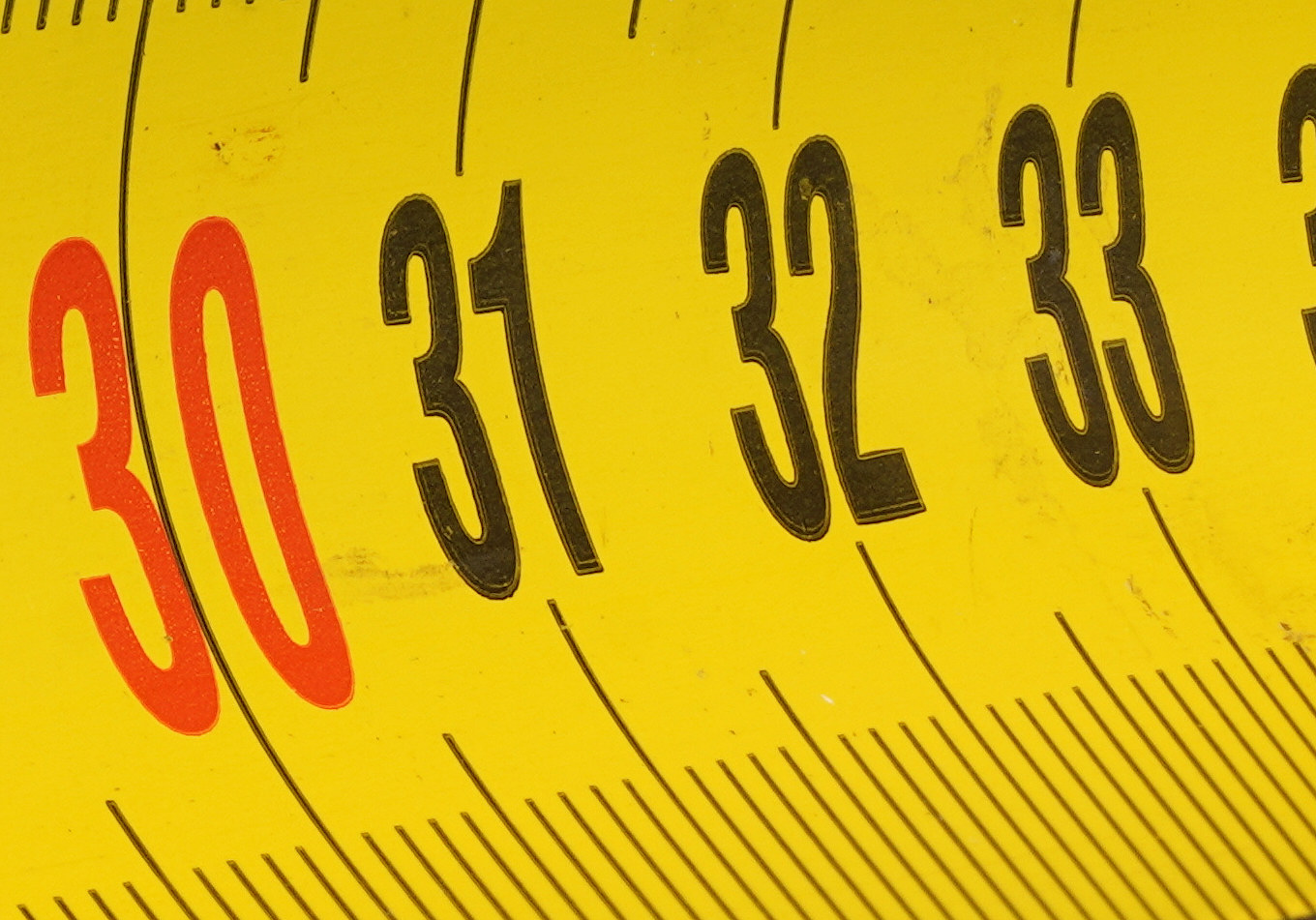

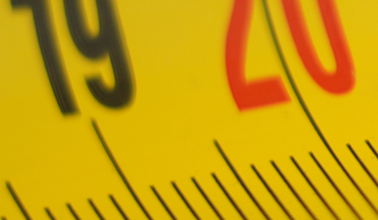

    You can tilt almost all lenses a little with good results. But you can't say how many degrees you can or need to tilt one lens.
    It depends on focal length and shooting distance. At landscapes 1-2° of tilt on 50mm lens is enough to get everything in focus.
    At macro shot you want or need more tilt. 12° is quite a lot.
    If I had to say one important thing it was chromatic aberration. Or missing of CA. Tilting increases CA and it does it asymmetrically,
    so it's hard to correct in post. I agree that enlarging lenses are good for tilting but not all.
    My best lenses are apochromatic or almost APO lenses like Apo-Symmars or Apo Sironar Digital lenses.

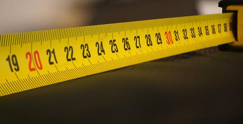

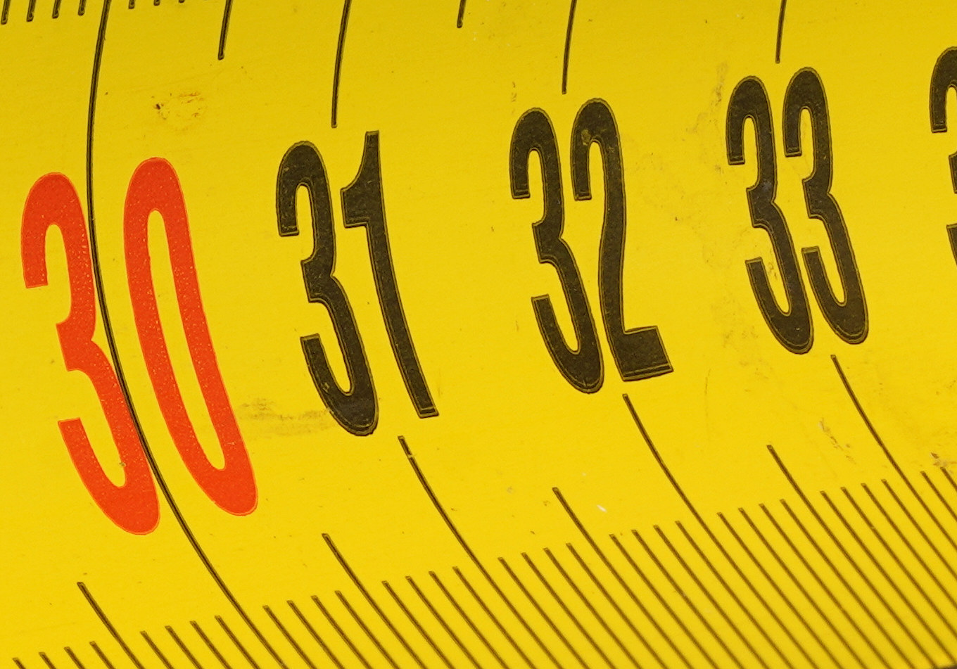

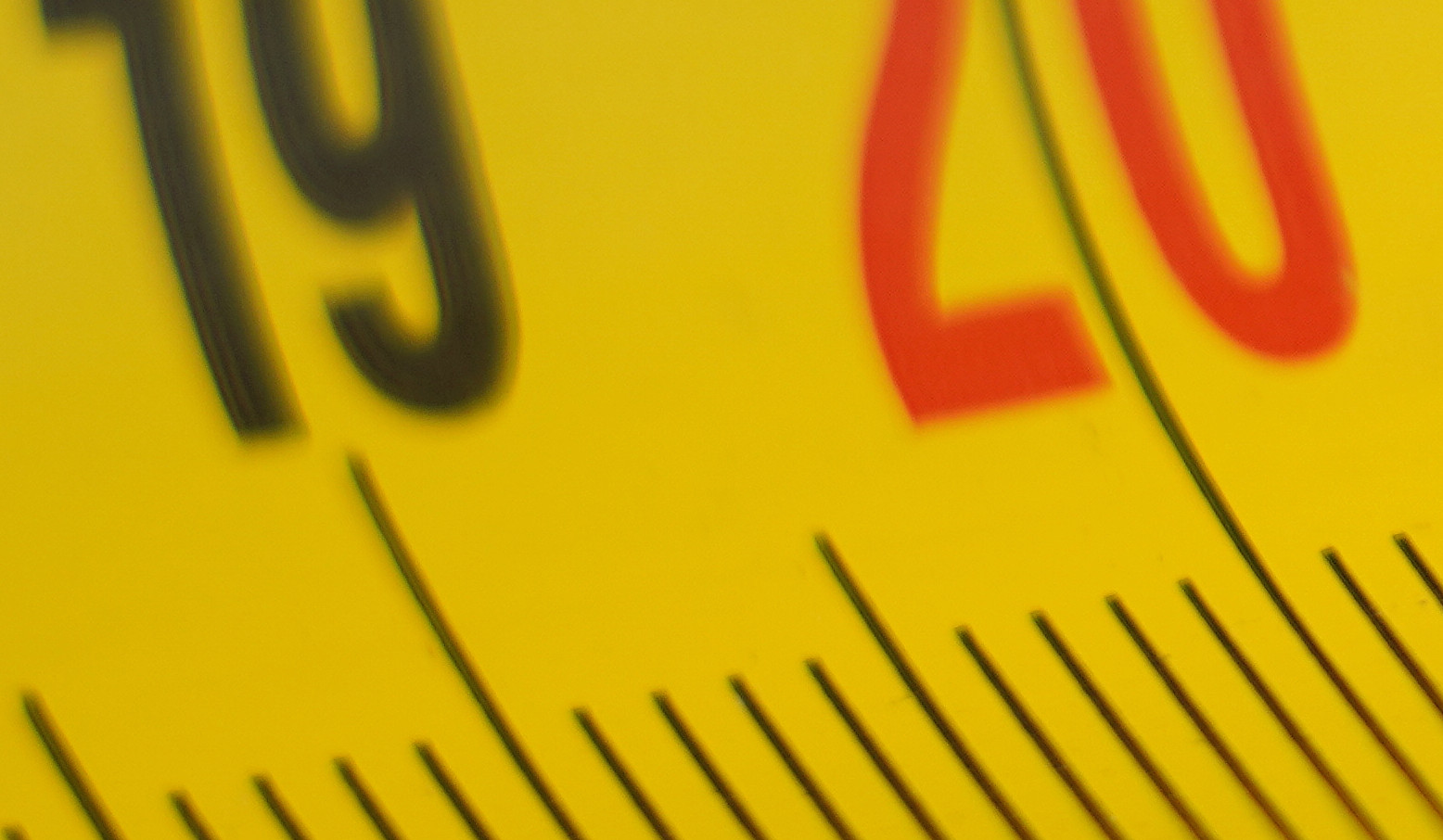

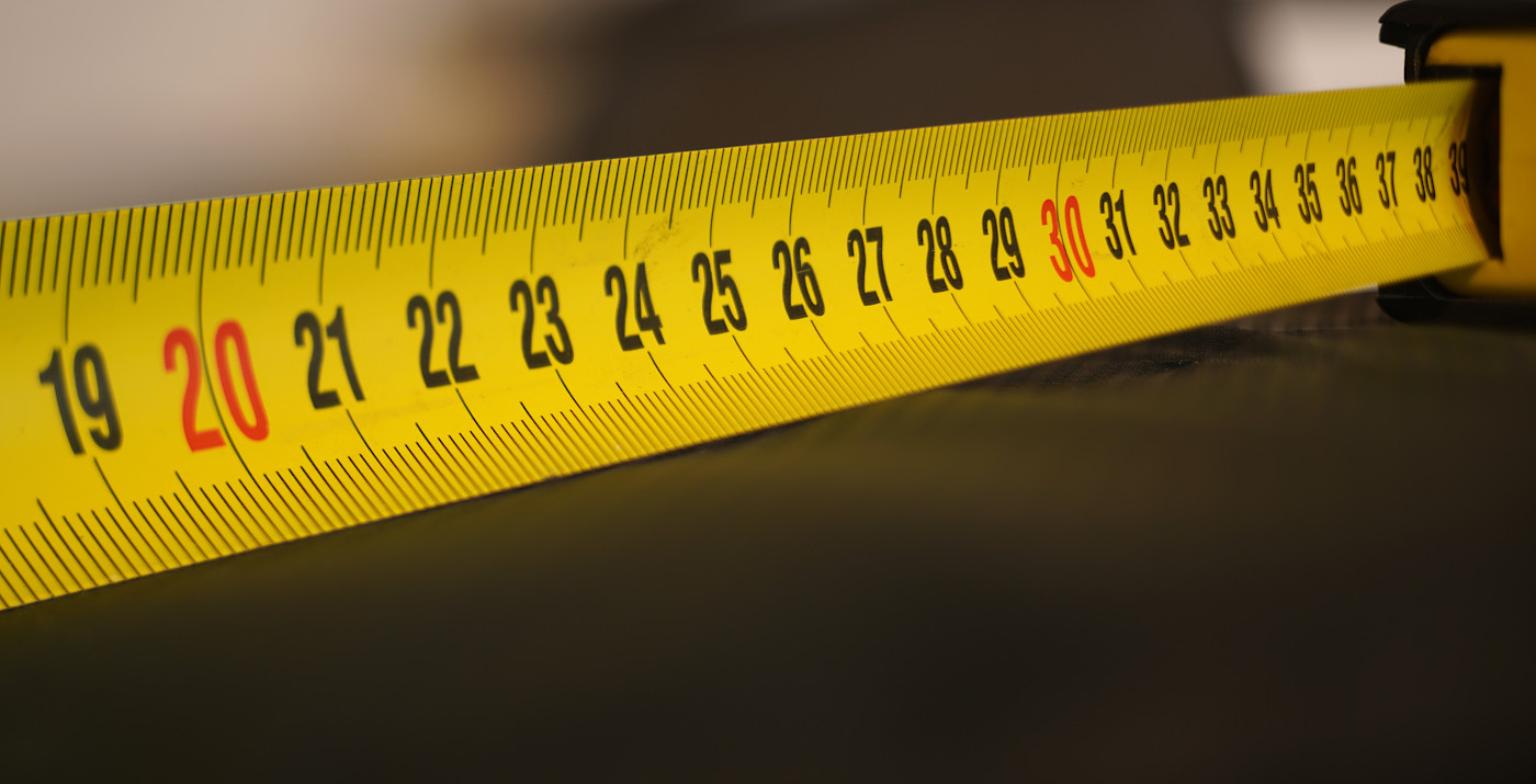

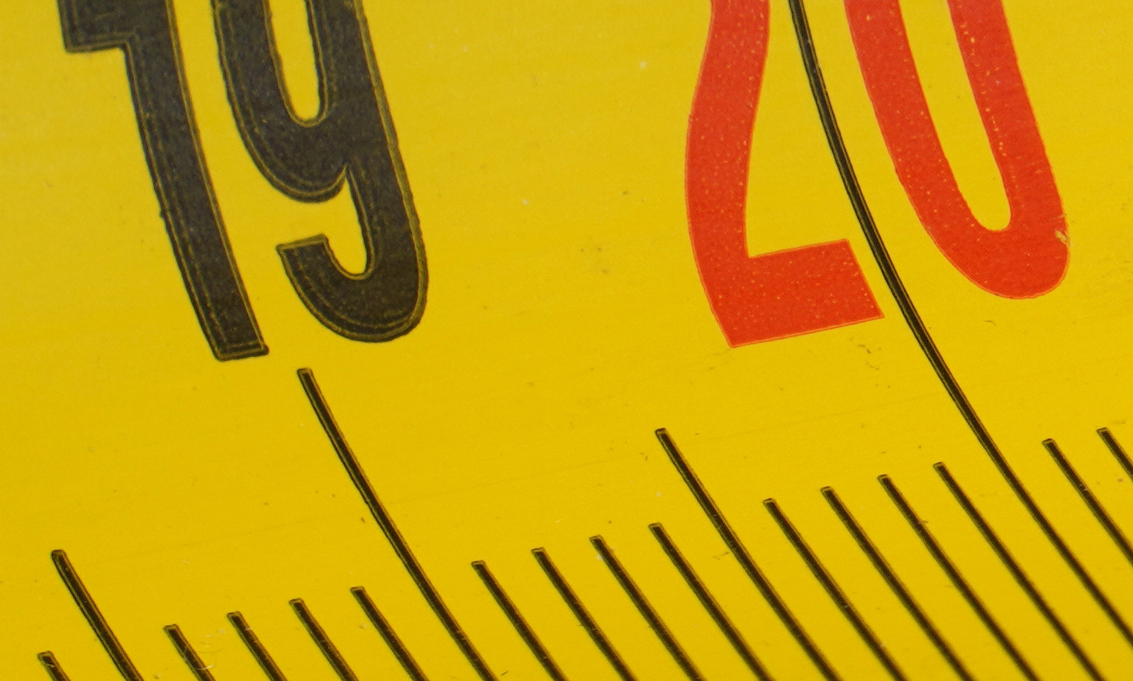

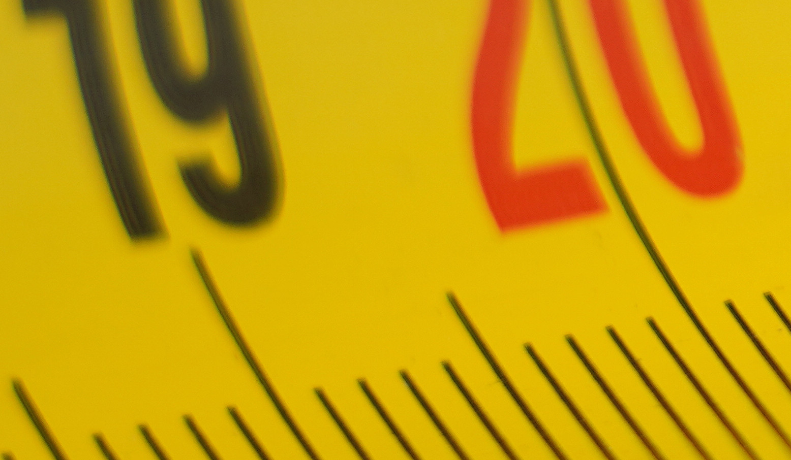

    Here I tested El-Nikkor 2.8/50mm (non-Apo). I don't remember exactly anymore, but I guess 10-12° tilt.
    A lot of CA and unsharpness at f/2.8. The scale at measuring tape is in centimeters.
