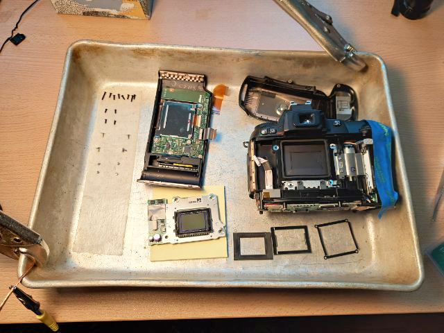

    May 19, 2023, 5:24 p.m.
    Today, I tore the D70 apart. Next step is to remove the cover glass from the sensor. That should be fun! It involves scraping around the glass with a sharp blade to remove any epoxy glue residue, and then using the heat gun to break the epoxy glue bond of the sensor cover glass. I've heard it can take many hours. You have to do it in stages, because the sensor is attached to a PC board with many components. The sensor and / or the PC board can be damaged if you heat it for too long at one time.
    JPG, 239.4 KB, uploaded by joman on May 19, 2023.

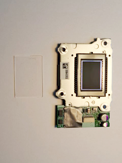

    May 27, 2023, 6:33 p.m.
    I managed to get the cover glass off in one piece. It did not take as long as I thought it would. (Well elapsed time was a few days, but I put it aside for a while.) I heated the cover glass with a heat gun for five minute periods for about 1-1/2 hours. This was at a temperature of something over 200 C. (The heat gun does not show any sort of scale, and my digital thermometer only goes to 200 C.) At that point, only the corners seemed to have some separation. I chose to stop for the night.
    I did not get back to the project for a few days later. When I did, I decided to scrape around the glass with a sharp single edged razor blade again before using the heat gun. With the first amount of pressure of the blade against the glass, it popped off! So, I guess the heat gun had done its job the first time, and the only thing that was needed was a little mechanical activity to complete the process.
    Now to go on to the next step, and design and build a jig to use in milling the CFA off the sensor.
    JPG, 134.6 KB, uploaded by joman on May 27, 2023.
