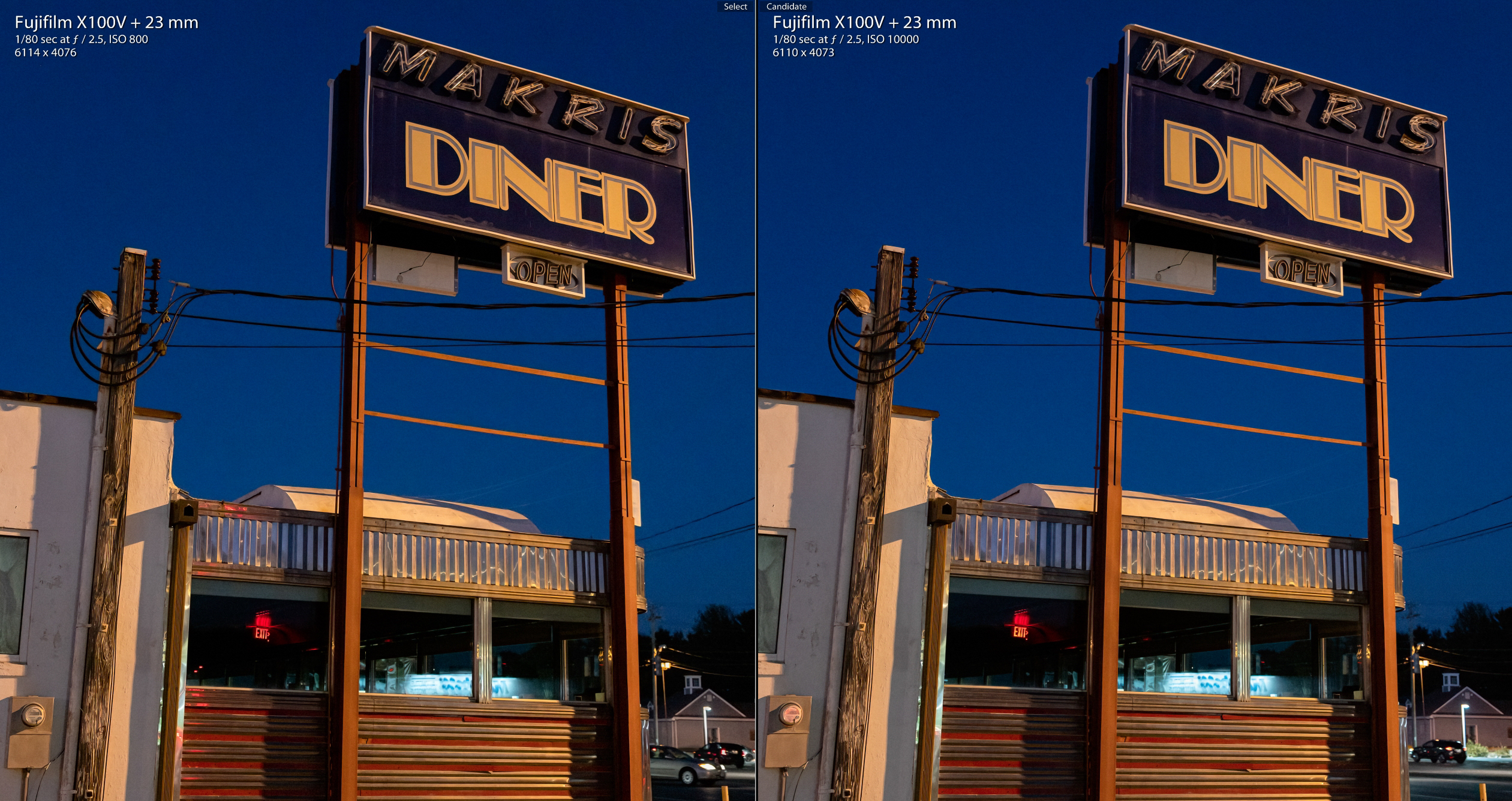

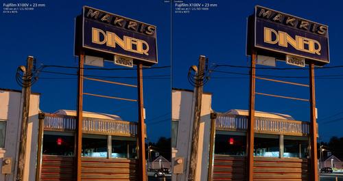

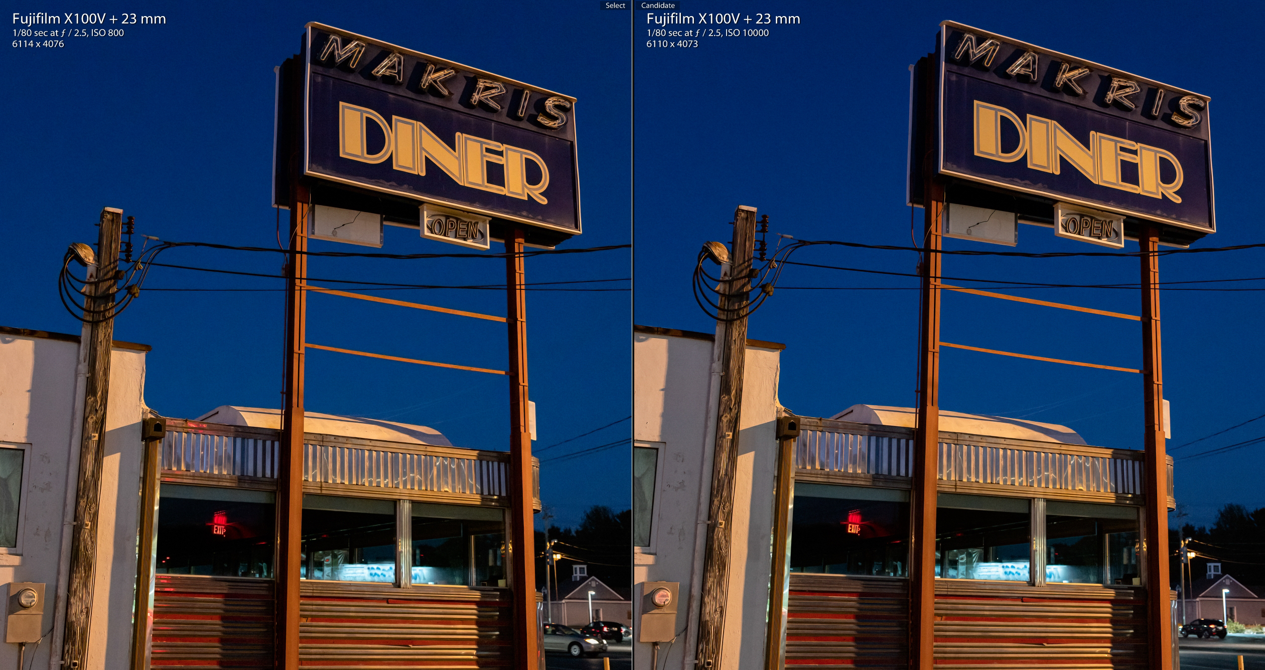

  • Members 204 posts
    April 18, 2023, 1:43 p.m.
    The primary benefit to shooting RAW at a lower ISO vs.a higher ISO with the same exposure is dynamic range/highlight headroom. As read noise generally improves at higher ISOs, especially beyond the dual-gain threshold, if you don't need maximum headroom, you really don't want to "underISO" for no good reason (and your images will be darker in the EVF and for culling/initial assessment) but, within reason, you will have extra highlight headroom to work with, and there's typically very little penalty to pay in terms of noise if you want to defer much of the "ISO brightening" until later in post.
    These are two examples using the Fuji X100V (dual gain threshold, ISO 500), both were the same sensor exposure, but one's at ISO 800 (L) and pushed (3 2/3 stops) in post, and the other is at ISO 10000 (R), identical processing otherwise. There is a slight difference, but it's probably hard to see here (at around ISO 1600+ there's no discernible difference).
