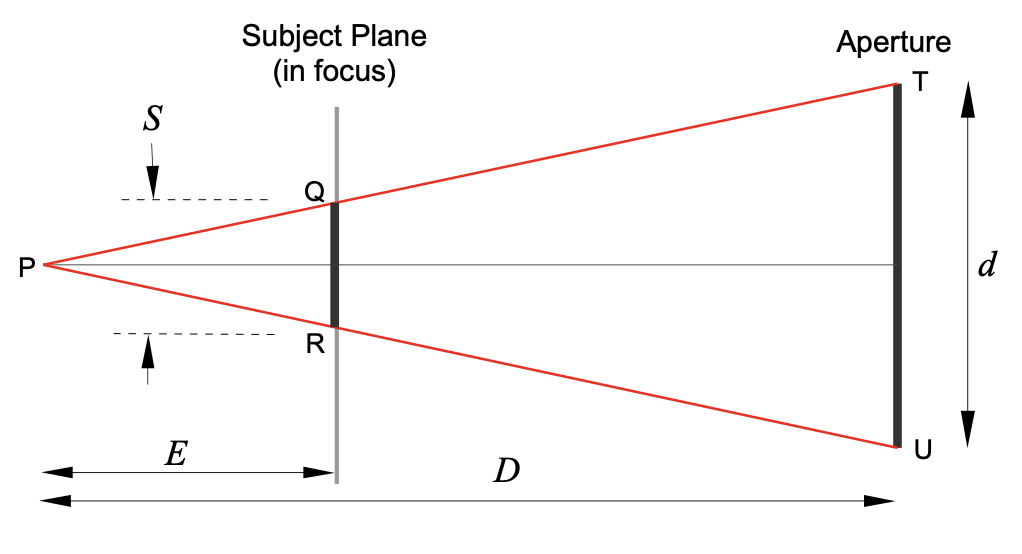

    Your formula for the disc of confusion is not quite correct. For it to work correctly, D must be the distance from the OOF object to the aperture. Here is a diagram that (hopefully) will make things clearer:
    P is a point on the surface of the moon. The point P appears as a blur that extends from Q to R in the plane of focus (the mountain range 4km away).
    E is the distance from the OOF point P to the plane of focus, while D is the distance from the OOF point P to the aperture (indicated by the line from T to U).
    S is the distance from Q to R, which is the size of the blur produced by the OOF point P in the plane of focus, i.e. the disc of confusion.
    The plane of focus (subject plane) is parallel to the plane of the aperture, hence the triangles PQR and PTU are similar.
    Hence S = E/D*d.
    For your example, d = 45mm, D = 400,000km and E = 399,996km, so S = 45mm. This is the disc of confusion produced in the plane of focus (4km away from the camera). 45mm will not be a visible blur at 4km distance, so the moon will look sharp if the camera is focused on mountains 4km away.
    If the plane of focus is at the surface of the moon and the mountains 4km away are now OOF, then D (the distance from the OOF point to the aperture) is now 4km.
    E is the distance from the OOF point to the plane of focus, so E is now 399,996km. Hence the disk of confusion is now 399,996/4*45mm, which is 4.5km (near enough). Now 4.5km is too small a distance to be distinguished on the surface of the moon (with an ordinary camera and 1000mm f/22 lens), so the mountains at 4km distance will also appear sharp.

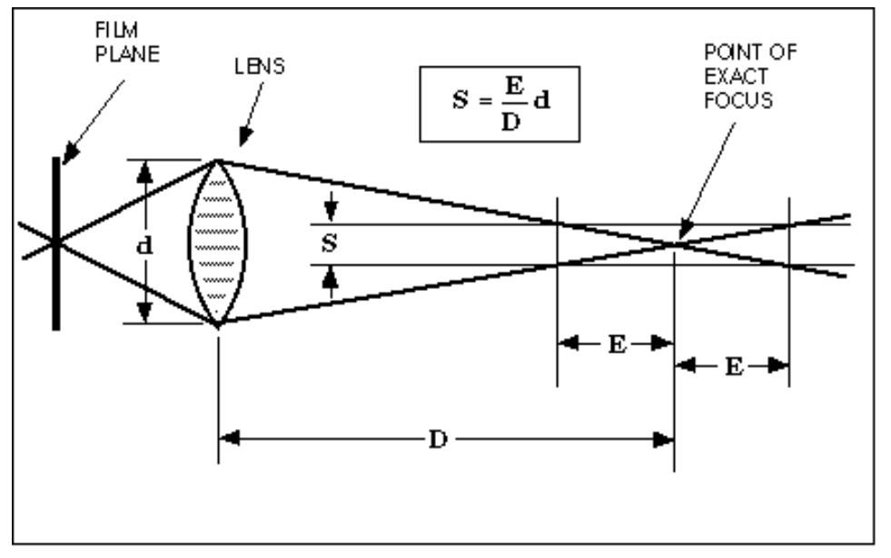

    This is Merklinger's diagram that his formula and my post is based upon:
    Your D is a different distance, so the same formula gives a different result. I'll stick with Merklinger, thank you ...

    Merklinger's diagram is essentially the same as mine, but you have misunderstood what it represents. His "point of exact focus" is the position of the moon, the point which you aim to focus on, i.e. the point of exact focus to get the sharpest possible shot of the moon. What his diagram illustrates is the size of the blur if you make an error in focussing, where E is the focus error.
    So if you focus at the distance D-E instead of focussing at the intended distance D, then the object at distance D is blurred by the amount S, as measured in the actual plane of focus (which is at a distance D-E from the camera). The same blur size would apply if you focussed at a distance D+E instead of focussing at distance D.

    The disk of confusion S at the moon would be approx 4,500 km, according to Merklinger's diagram, would it not?

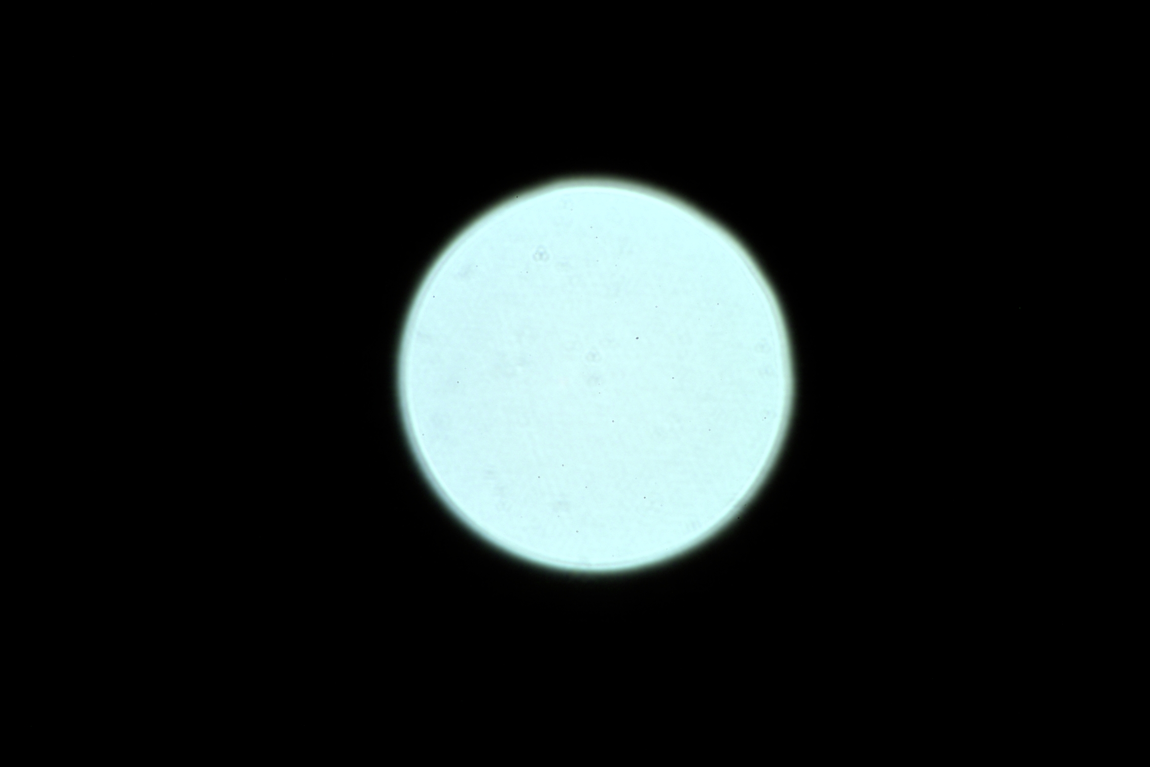

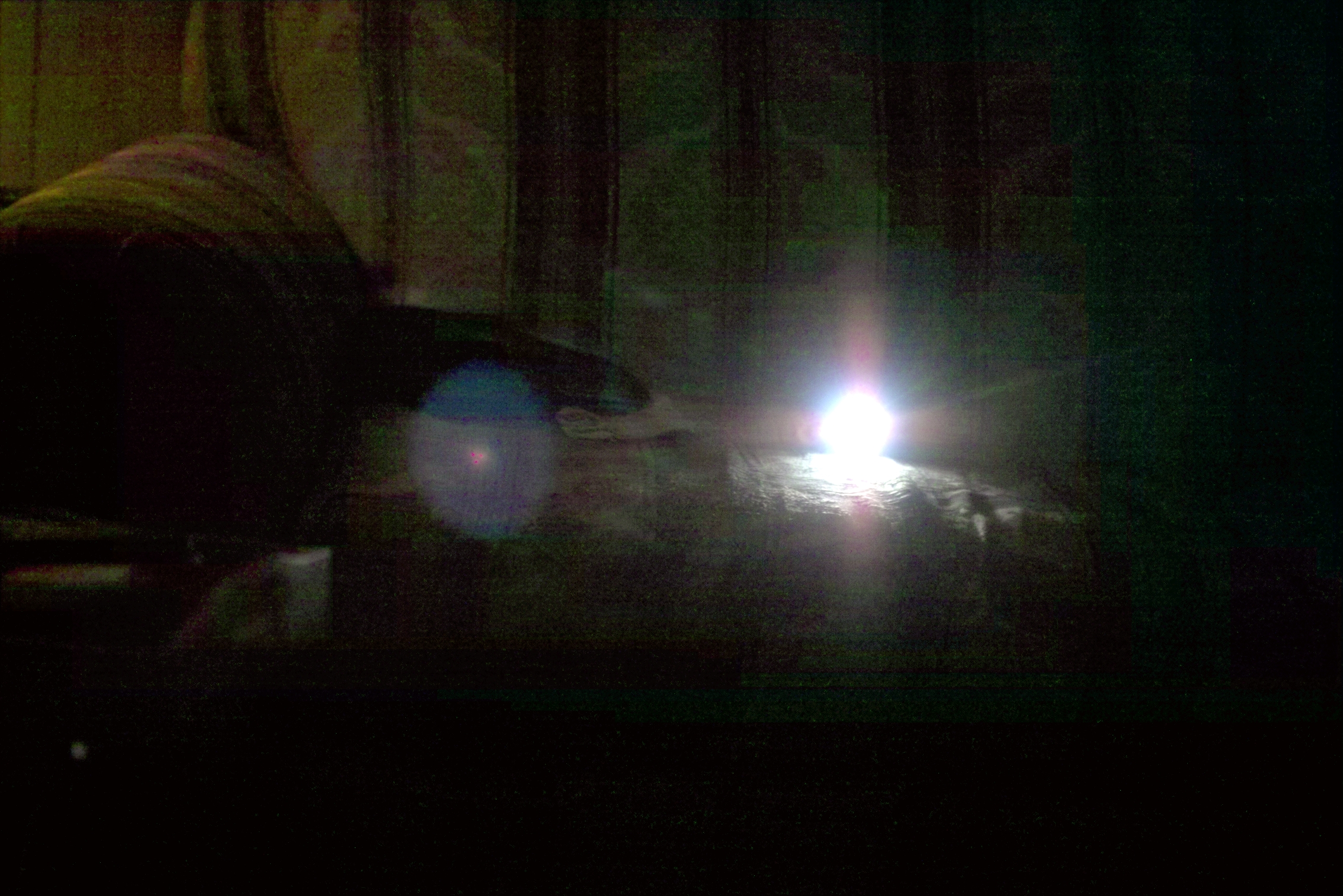

    So instead, a 50mm macro lens at f/2.8 = 17.9 mm aperture diameter. 19 mm diameter flashlight at 3 m distance.
    Focused manually on flashlight:
    Focused at 0.188 m(1:1):
    Images 2268x1512px.
    Merklinger's E/D*d = ((3-0.188)/0.188)*17.9 = S = a disk of confusion of 268 mm at 3 m.
    You too could shoot an object at some distance, focused on it then focused much closer and post it here with your conclusions ...

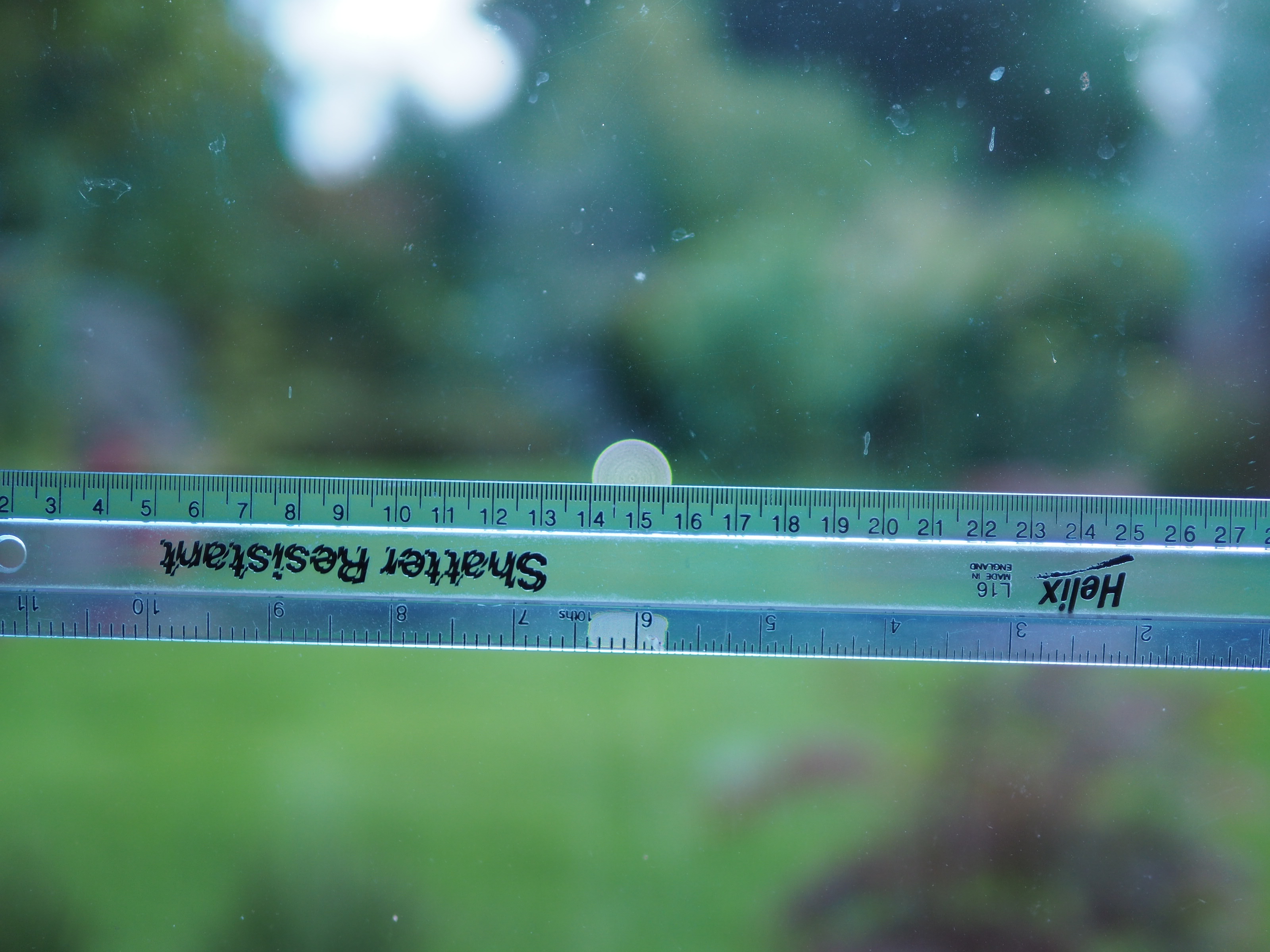

    Here is an image I took seven years ago.
    The ruler intersects a circular blur disc produced by a single LED light about 14 metres away. Using the ruler, it is easy to see that the diameter of the blur disc is 16mm approximately (in the plane of focus). The entrance pupil of the lens is 25/1.4 = 18mm approx. when focussed at infinity. However, the lens was focussed at around its closest focus and the entrance pupil may have been reduced slightly by the internal focussing mechanism.
    JPG, 1.6 MB, uploaded by TomAxford on Aug. 7, 2024.
