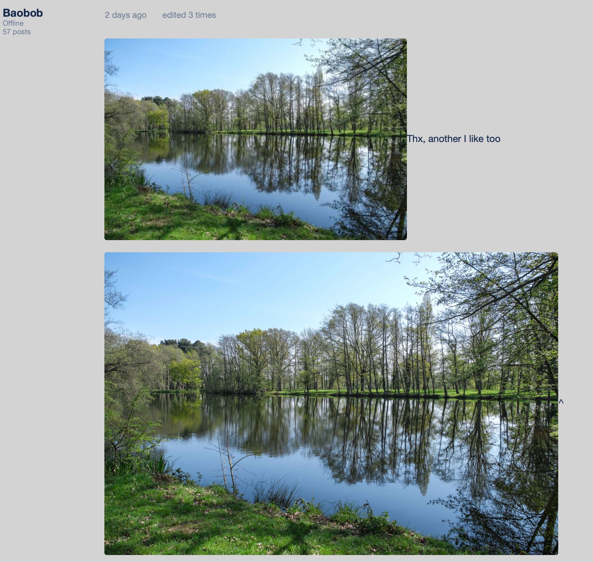

    Thank you for the feedback. I think I'm just confusing resize/download/upload in general. I saw a post in the weekly thread and thought there might be a way to post a larger physical rendering. I'm copy/pasting here the one that I'm referring to for example only. I know there is the 4.0 mb limit, but thought for a moment we could have it show larger in the thread. That part is likely me not fully understanding downloading a down sized sample from Apple Photos to then upload here. There is no option to choose mb size. Only width, height, or dimension are available when choosing a size other than small, medium, large, or full size in Apple Photos. Need to investigate further (and maybe use Raw Photo or Pixelmator direct) to download instead of Apple Photos. I always just did full size for dpreview.
    JPG, 1.0 MB, uploaded by Meeces on April 26, 2023.

    Ok, I think I see - I took a look at Baobob's post - they've uploaded the image and inserted it into the post (the top image) - the forum then inserts a "thumbnail" 333px tall.
    For the second image, they've done that manually - but inserted the non-thumbnail (full size) version, but the forum still restricts it's display to a maximum height of 500px.
    Personally, I would just upload and then click the insert button (click here for steps) and let the forum insert it, that way you'll get a smaller image in the post - yes, but it will automatically be clickable so people can view it in the viewer, zoom in etc.
    This method also then saves a bit of bandwidth as the thumbnail for that particular post, is around 55 KB, and the full size image is 2.6 MB. Folks on mobile or restricted data would be grateful... 😉
