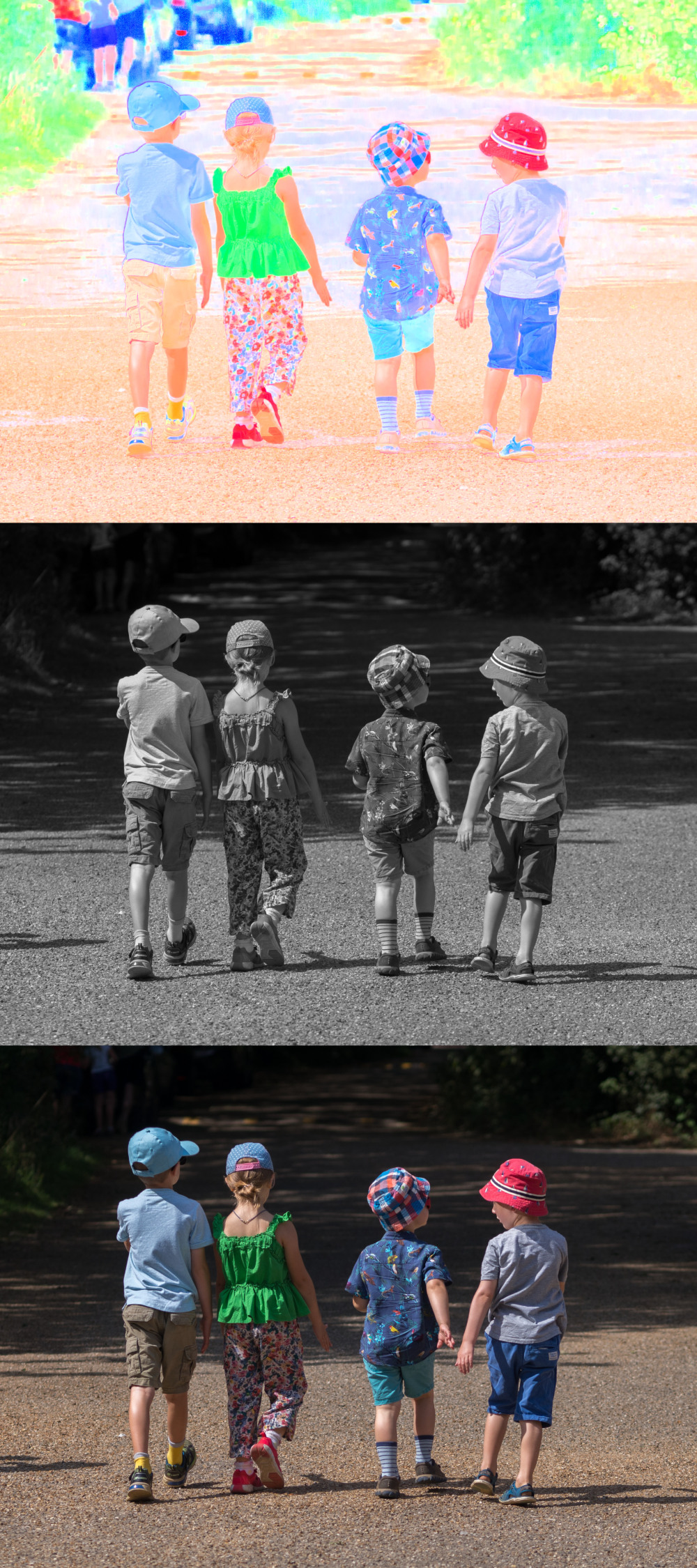

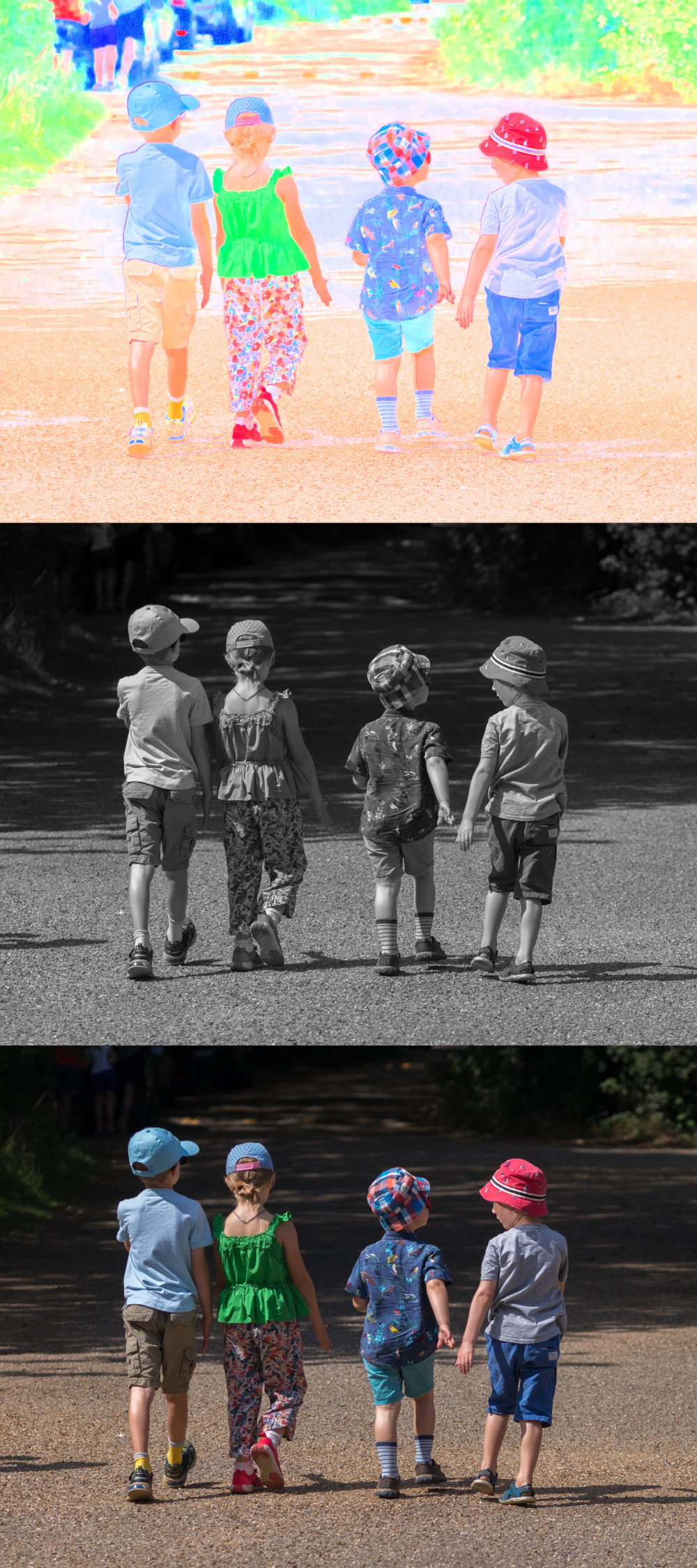

    April 24, 2023, 1:23 p.m.
    Here is an example image converted to greyscale in GIMP using the Luminance option. I find it interesting to also look at the image with the greyscale information removed, so we are seeing just the colours (all normalised to maximum lightness).
    The top image is with the luminance or brightness information removed and the colours made as bright as possible; the middle image is the luminance as a greyscale; the bottom image is the original.
    In GIMP, luminance is a weighted average of the three colour channels that tries to emulate the brightness seen by the human eye. I believe luminance is not the technically correct term for this, but that is what GIMP uses.
