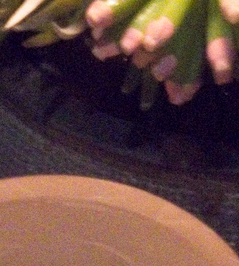

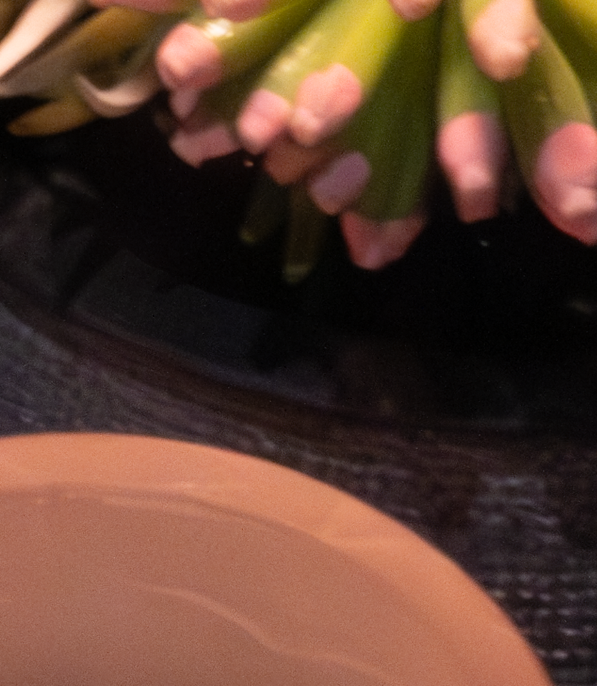

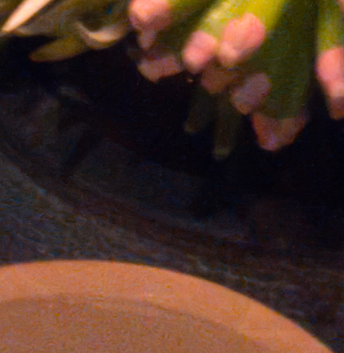

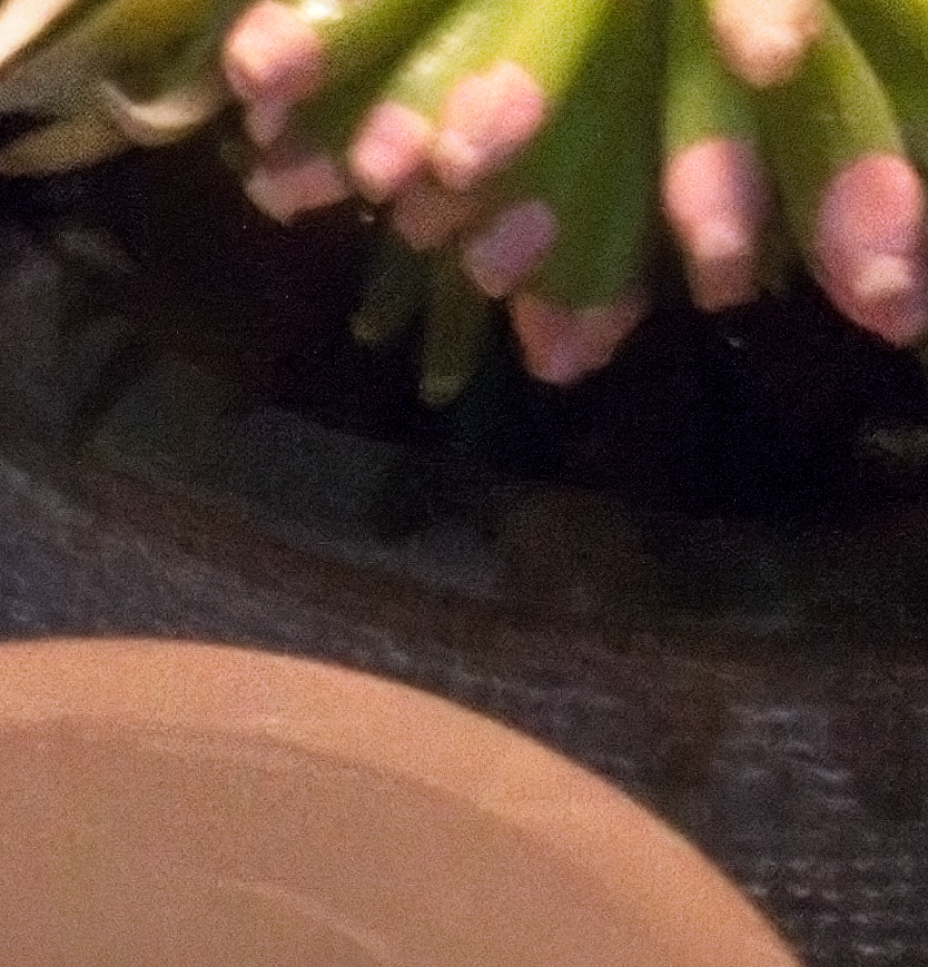

    I have a standard very noisy image that cleans up OK in Adobe Camera Raw and not quite as good in ON1. So, here's the results:
    The original:
    Neo
    ON1
    Adobe PS
    I leave you to draw your own conclusions, but I'm not buying Luminar based on that.

    Bear in mind that the color saturation is much higher in the Neo version, so naturally, that could make chromatic noise stand out more, even if it really isn't more.
    What happens when color saturation is normalized? I bet they will be more similar than they are here.

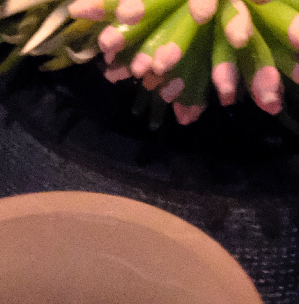

    My attempt to denoise in Silkypix, no other adjustments made. I just looked at selected area, it is quite possible that entire image needs a bit different parameters.
    Silkypix is real slow beast, I'm sure I could get better results, if I played for an hour or two :)

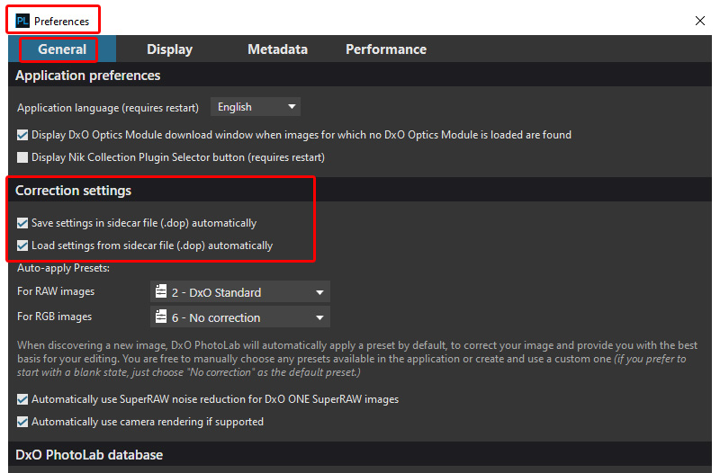

    Sidecars are optional in PhotoLab. If you don't want them, disable them under Preferences > General > Correction. The same info is always stored in the database.

    In PL 7, there is no such capability in "General>Corrections" That only relates to geometric correction. Under Settings>Advanced - there is an option
    there are options on Sidecar files of "automatically export" and "automatically import." However, the meaning is somewhat unclear. So I guess I'll need to experiment a bit.

    Yes. The options are under Preferences in PL 6, and why they were moved in PL 7 is not clear to me. As I understand it, the sidecars are meant as a backup to the database, and I imagine that they can be used in the event that the .dng and .dop files are moved to another folder, as the values in the database save the full path to the original folder of the .dop file. I have no idea why!

    I can see it there quite clearly in PhotoLab 7 for Windows.
    Maybe that's the Mac version.
    Yes, do that.
