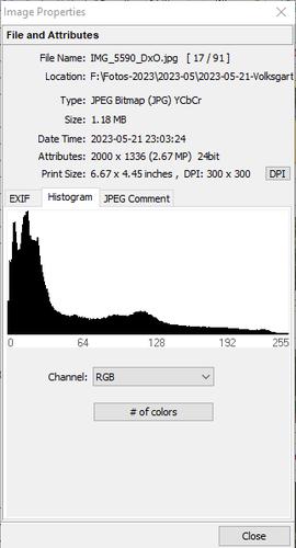

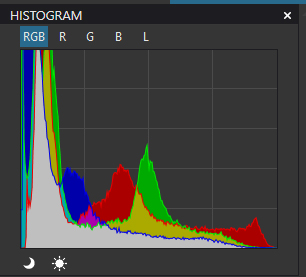

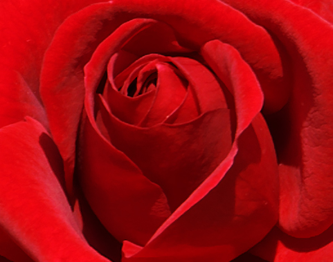

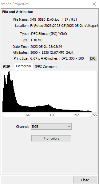

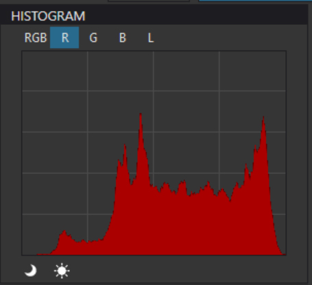

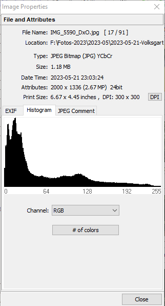

  • May 22, 2023, 3:25 p.m.
    Expat,
    Thanks for your contribution! I am not familiar with the program that made your histogram. Here are what I see in DXO-PL4 and Faststone. (I wish one could see histograms at a larger size on the screen and with control of the Y axis scaling...)
    PL4 has a method of showing clipped pixels by means of false colours and I back off the exposure comp until these are no longer visible.
    I did not do anything to edit the colour -- just levels.
    Here is a crop of the bloom:
    and DXO histograms:
    By the way, I did use PS for cropping and all the jpegs on this page I saved at maximum quality (PS calls it "12").

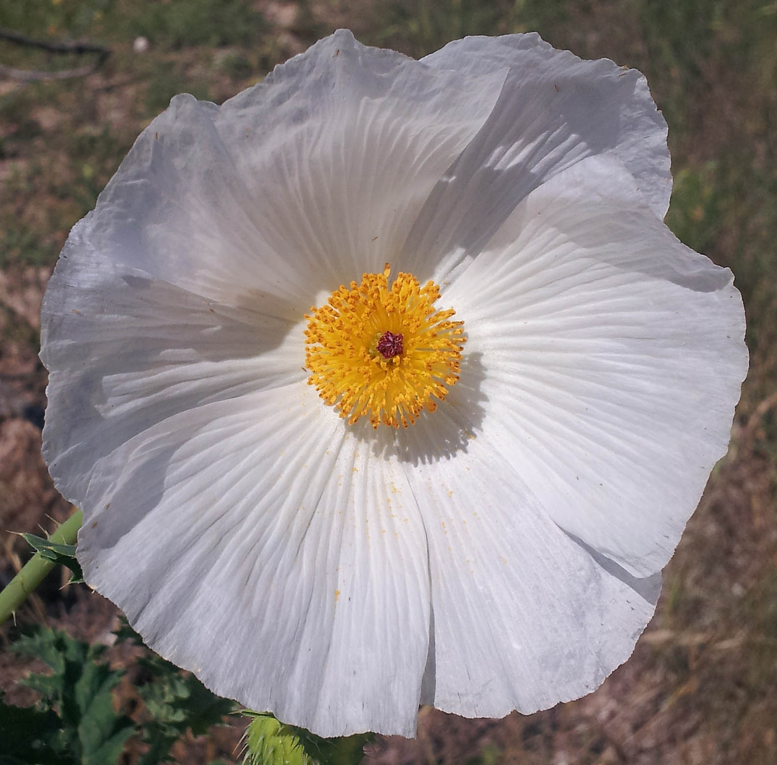

    One thing I avoid is getting the flower dead center in the image - simply because that's what many folks do. At the very least, I favor offsetting the flower's center of area (centroid) by the good old Golden Ratio i.e putting it at about 0.6, not 0.5.
    I would suggest researching background blur, rather than concentrating on DoF. You will then begin thinking about 'stacking' a set of images of the same flower, same camera position, same framing, na-ni-na, with the focus different in each shot. Stacking can be done with various Apps these days. About seven or more images are aligned then fancy software combines the best-focused areas into a single output image. Tedious but some find it quite rewarding!
    Or ... only shoot flat flowers LOL
    JPG, 228.0 KB, uploaded by xpatUSA on May 22, 2023.
