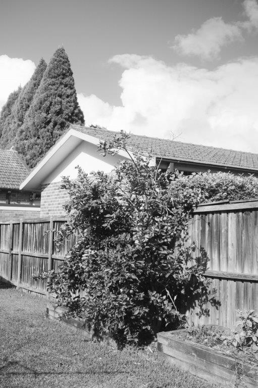

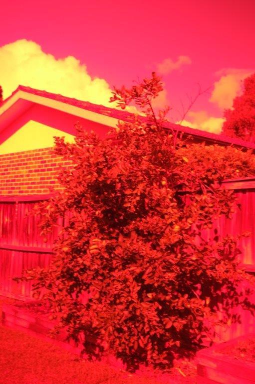

    Here are shots with an regular digital camera with the the filter. (colour and converted to black and white)

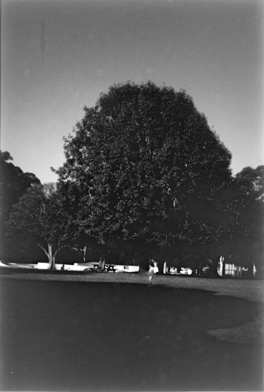

    filter at "530nm"

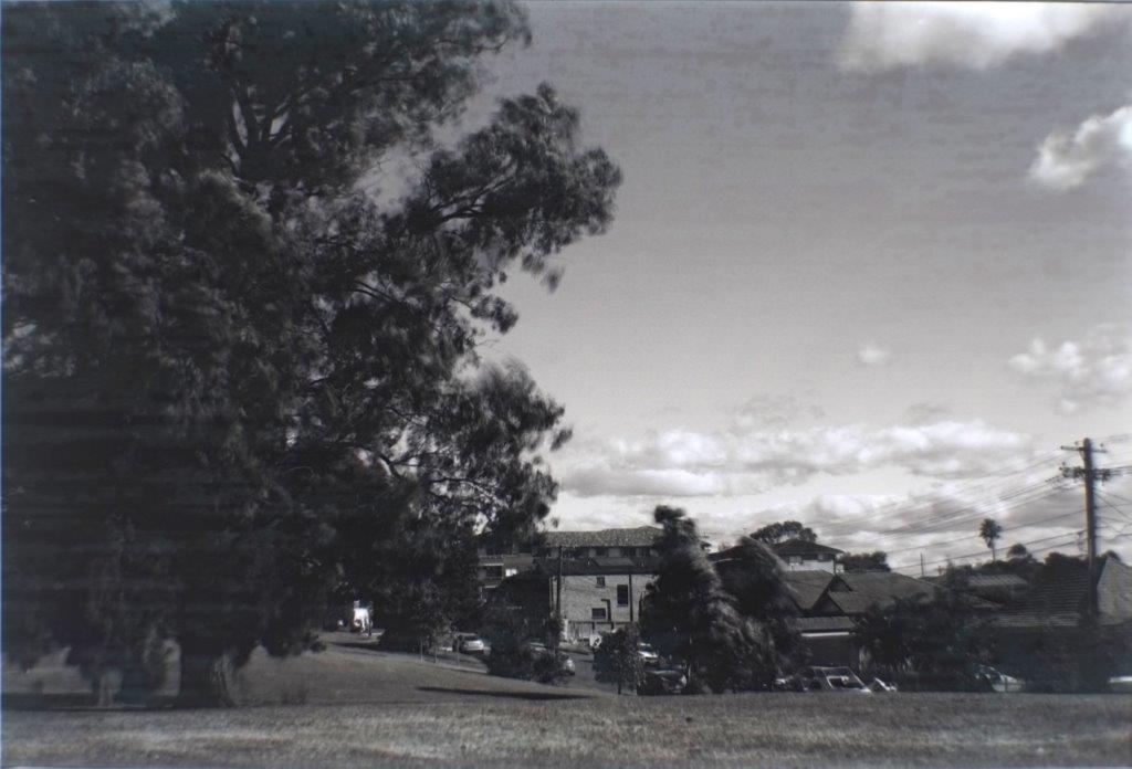

    at "650nm"

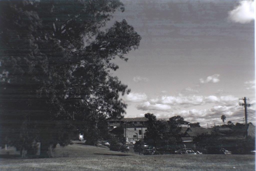

    and at "710nm"

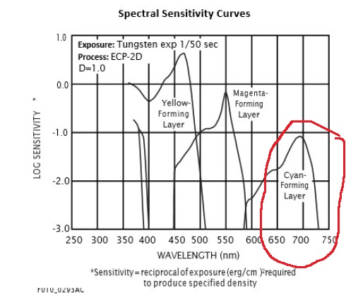

    Although I'm not using film that's labeled as infrared, it is sensitive to those wavelengths as shown by the spectral sensitivity curve below so I should be getting white foliage and dark skies with this filter and film combo.
    If you are using this filter and your getting the infrared effect then I'd love to know how your achieving it. I've tried taking shots with the sun high in the sky and late afternoon. White balancing for the filter and using auto white balance (for the digital shots). Photographing different types of plants and trees just in case some reflect more IR light than others. And as shown, trying digital and photographic film. There's no situation where I can get the foliage to look like true IR images. My only conclusion is that this "adjustable IR-pass filter" is actually a variable ND filter with a heavy orange cast and people should steer clear of it unless they want photos that look like they were shot on Mars.
