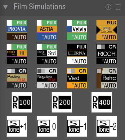

    I have created a set of styles emulating the various film simulations in my cameras. The styles were created with the built-in darktable-chart and use the color-lookup-table module instead of LUTs, which I find works a bit more robustly.
    And then I added a little film simulation panel to both the lighttable and the darkroom for quickly applying these styles, and a few other common edits:
    PNG, 40.9 KB, uploaded by bastibe on April 28, 2023.

    It's just a feeling I have, no science to back it up, but I sense that film stocks are much more difficult to emulate than just setting up some contrast and colour shifts. Film stock doesn't not behave in a simple linear fashion, you get different looks at different exposures and under different lighting. To fully emulate a film stock so that you get convincing results would require lots of complicated changes in the emulation for different conditions. I might be wrong, but I feel film emulations are really just fancy ways of applying different raw profiles. As such, they don't really behave much like real film. Am I wrong?
  • Members 60 posts
    April 29, 2023, 4:55 p.m.
    Note that these icons refer to Fuji/Ricoh picture profiles, not film stocks. They replicate the JPEG renderings of these cameras. Ostensibly, they are inspired by film, but they don't physically simulate it.
    For a realistic film simulation, you'd need to fix the ISO and white balance, simulate developer diffusion, halation, and grain. I have no idea if that's even realistically possible with digital color arrays and saturation behavior. I do know, however, that you can get quite close, albeit not necessarily with typical raw development tools, which aren't ideal for diffusion and halation. Filmulator has a diffusion simulation, I think, and it looks very good.
