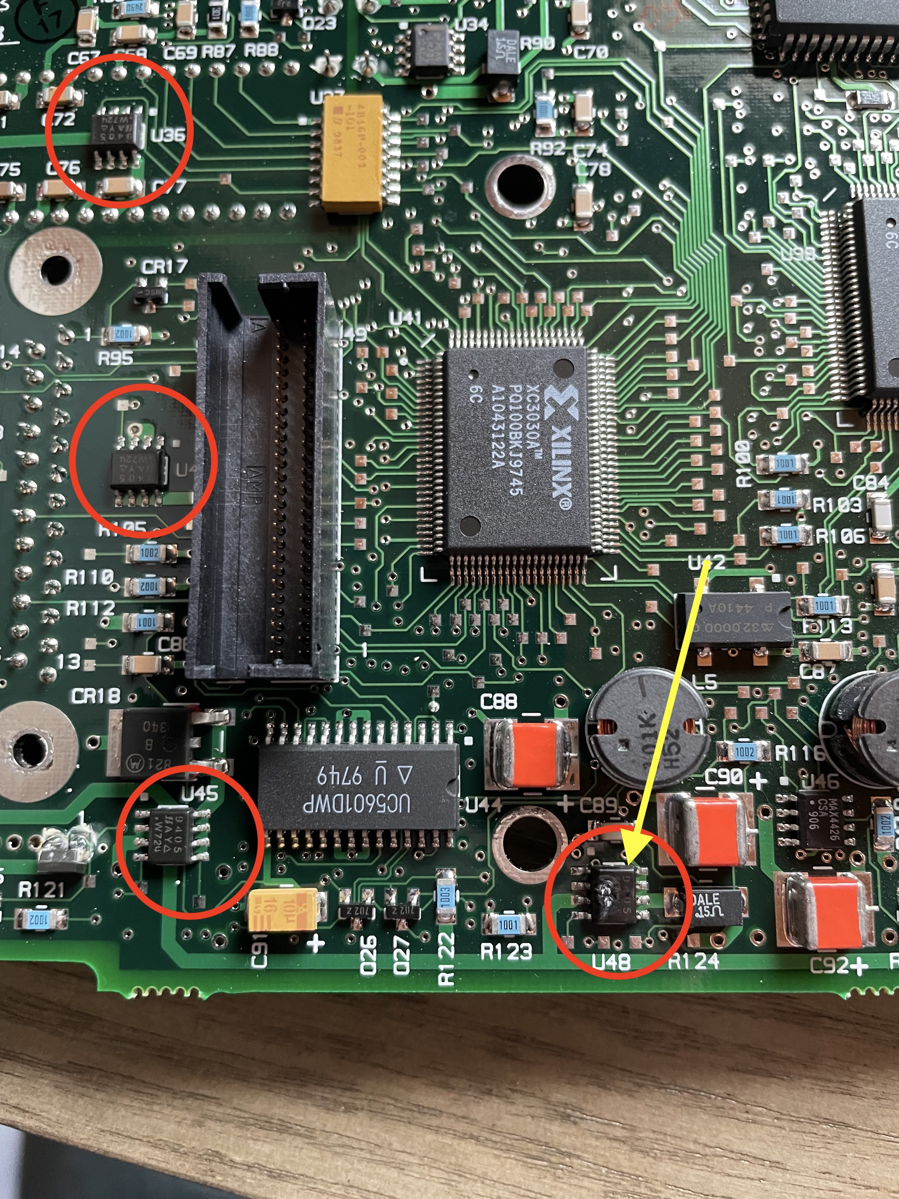

    I managed to get it open and this IC is the only thing obviously smoked I can find
    I've managed to hopefully find replacements, so we'll see.
    I spent some time probing around other areas. All the fuses I could find are good. I didn't check all the resistors but the ones I did are in spec. I need to check the caps, but nothing looked obviously off and of course there are no big electrolytics to worry about.
    I did probe around a few traces that have whitish deposits on them, but all are good that I could find...

    Hmm that's a FET, they blow because something else went wrong, if nothing obvious is shorted after that, a shorting tantalum can totally be the culprit.
    I can see one quite near the area of failure, Prior removing the dead FET one really easy way to rule out for shorts is to apply voltage to that part of the circuit with a bench supply and see where the heat goes. Using very safe values of course like 1v at 1amp, is quite safe to apply those on the capacitors that are obviously for power supplies.
    1V is too low to power anything, even less to damage anything, but well enough to generate heat on any shorted component.
    You can apply a freezing spray to check where it heats, or if you have access to a thermal camera that's much better.
  • Members 35 posts
    May 16, 2023, 1:49 a.m.
    The proximity of the inductors makes me think this FET might be part of a PWM DC/DC converter. If so, it could be whatever controller is driving the FET. You'll need to remove the FET first, regardless, and then you can check for a short at its output and maybe try applying power to see what is being fed to the gate.
