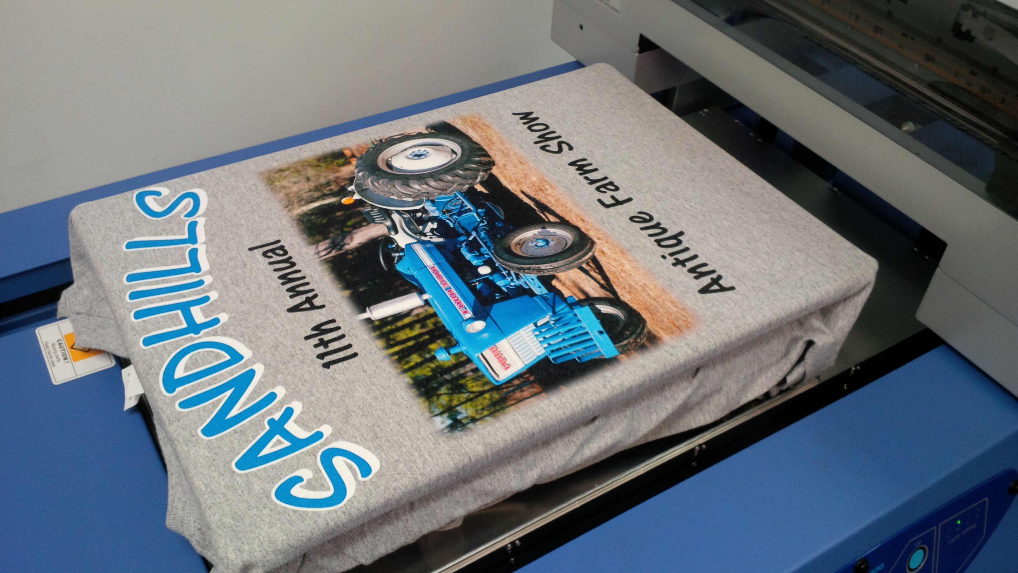

    Such as this tractor shot for the featured machine of the year for an antique farm equipment club. A Pre AI Nikkor 85/1.8 on a Nikon Df. I focus on the very front and very back and noted the distance and set the aperture to what would fit between the lines. Kept it simple.
    I was happy with it. They were ecstatic.

    AFAIK the markings on the lens was devised in the 1930s for small-sized prints. I guess they work for printing on T-shirts as well :).
