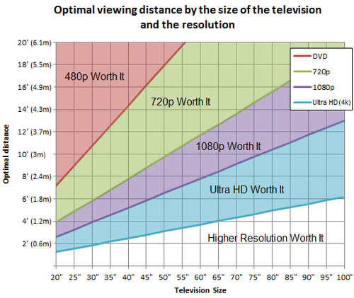

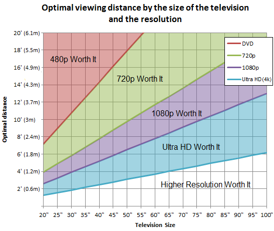

    I have been using 4k monitors for several years now. I have found that gradually most major software packages scale well enough.
    Thanks to the wonders of intraocular lens replacement surgery I have excellent vision especially for my age { I just turned 59 }.I certainly cannot see any pixels on the monitors . I currently use the BenQ PD3220U.
    My main reason for a 4k monitor was video editing. While it is not my major interest I do enough of it and typically output at 4K, so a 4k monitor was an obvious choice.
    As for 8k though ironically the close distances used in typical PC scenarios. Would be able to take advantage of 8k resolution. My sister has I think a 75” 8k TV and to see the resolution difference, compared to 4k. You need to be viewing at an uncomfortably close distance where I suspect headaches and the like would be a must with any length of usage. This is based on viewing 8k clips from my Z9 and 16:9 crops { 8256x4644 } which fills the 7680 x 4320. The images look glorious when viewed close up 😀 but honestly at more normal TV viewing distances much harder to tell
    If you look at the suggestions for viewing distances at the rtings website { a very good resource for reviews } . Basically 4k at common PC viewing distances a 32” monitor is plenty. For 8K to ake advantage of the resolution I think you would need a rather large screen. 8K monitors are very limited in choice and bloody high in prices. I have seen a few YouTube folk using 8k TV’s as monitors but given the smallest 8K TV’s are I think 55” I think that would be way to much. There a couple of 5k monitors again not cheap
    www.rtings.com/tv/reviews/by-size/size-to-distance-relationship

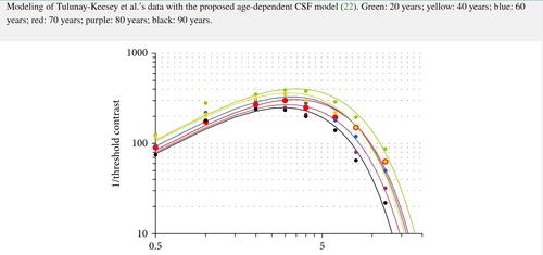

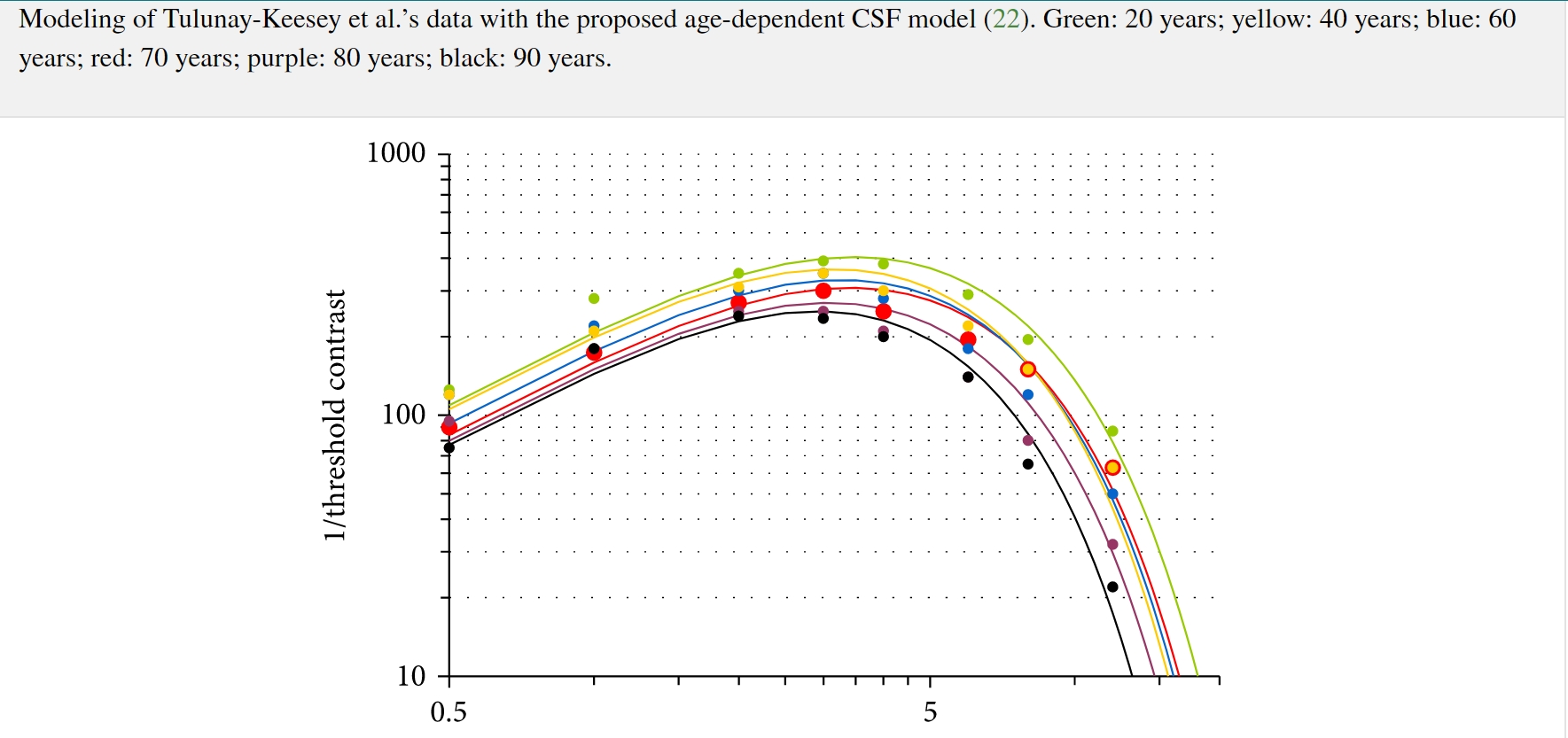

    Thanks for all responses so far!
    I based my acuity versus age on this set of graphs:
