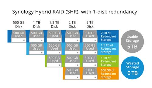

    No, if you want that ability in a consumer-grade NAS box, then as far as I know the closest you can get is with something like Synology SHR.
    However,
    from here.
    If you look at the above diagram you can see that even if you mix and match drives with different sizes, you have to create multiple "shares". You can think of a share as an extra disk attached to your computer via network. We cannot create a share that spans multiple array groups.
    So, again from the above diagram, you cannot create a single share with 5 TB (2 + 1.5 + 1 + 0.5 TB) of redundant storage.
