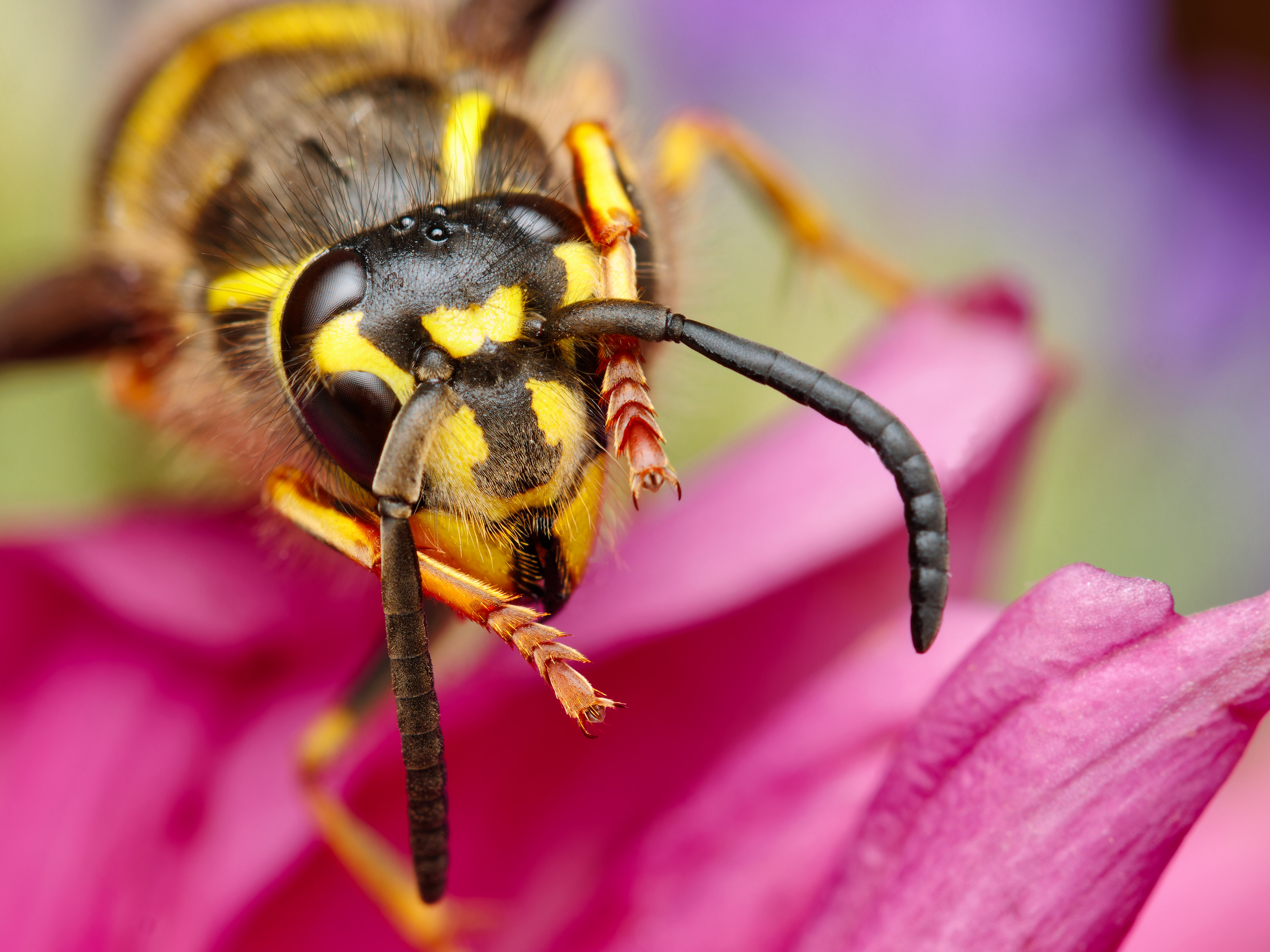

    April 3, 2023, 3:11 p.m.
    JPG, 1.7 MB, uploaded by james on April 3, 2023.

    (james) Superb image from a single exposure!
  • Members 218 posts
    April 3, 2023, 7:46 p.m.
    My new toy is pureraw deep prime xd 😀 it’s better at processing raws than I am

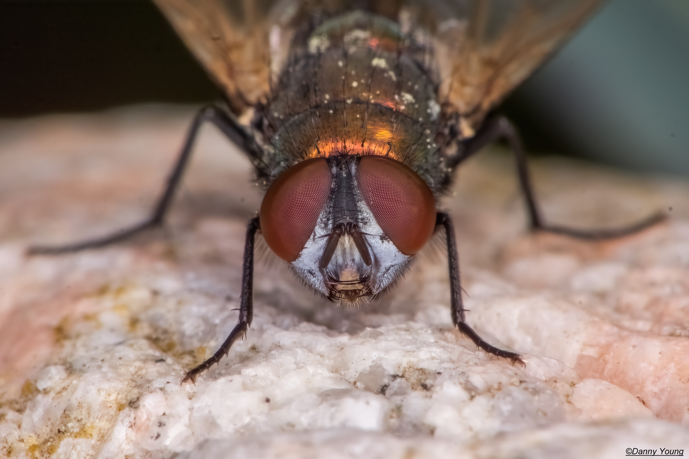

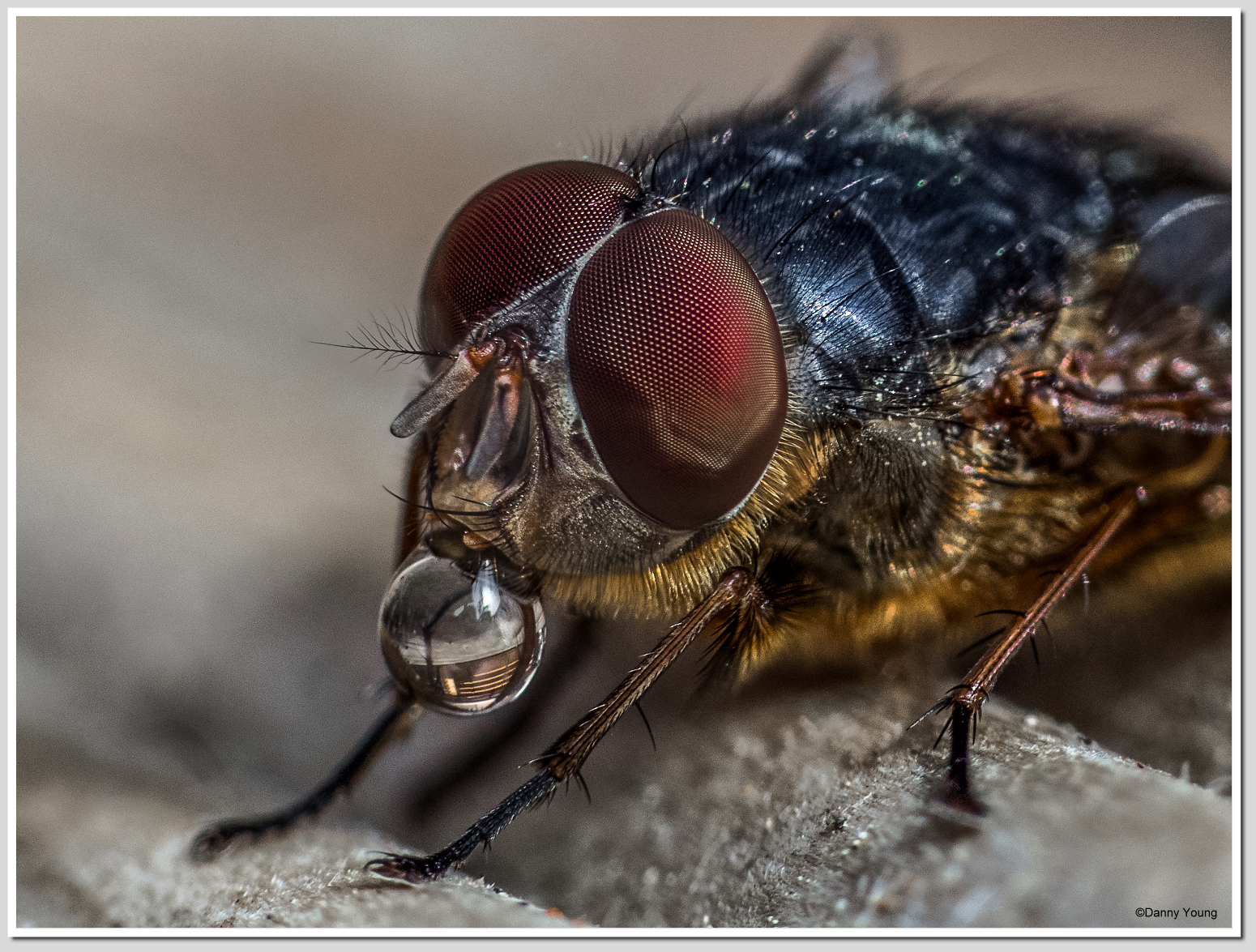

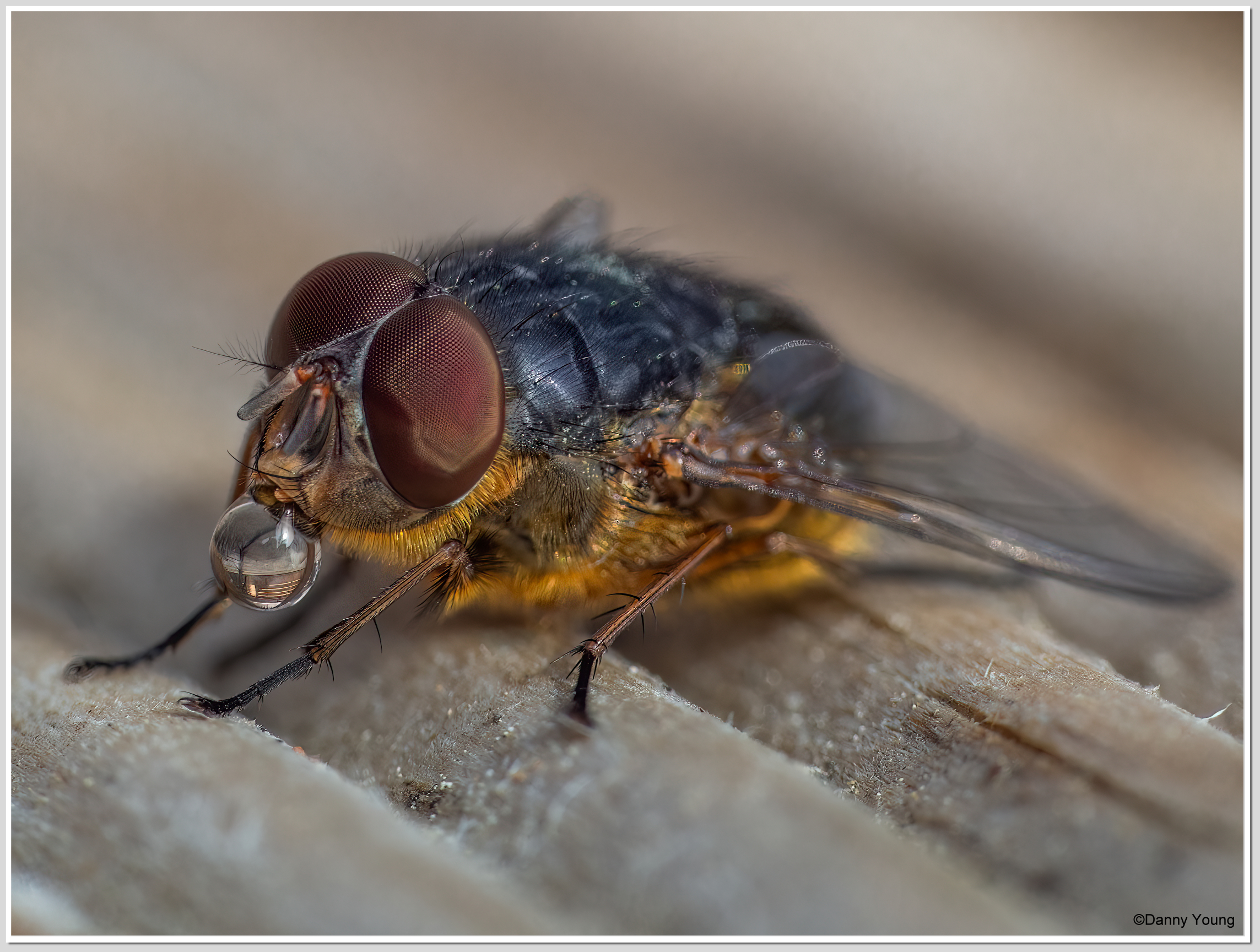

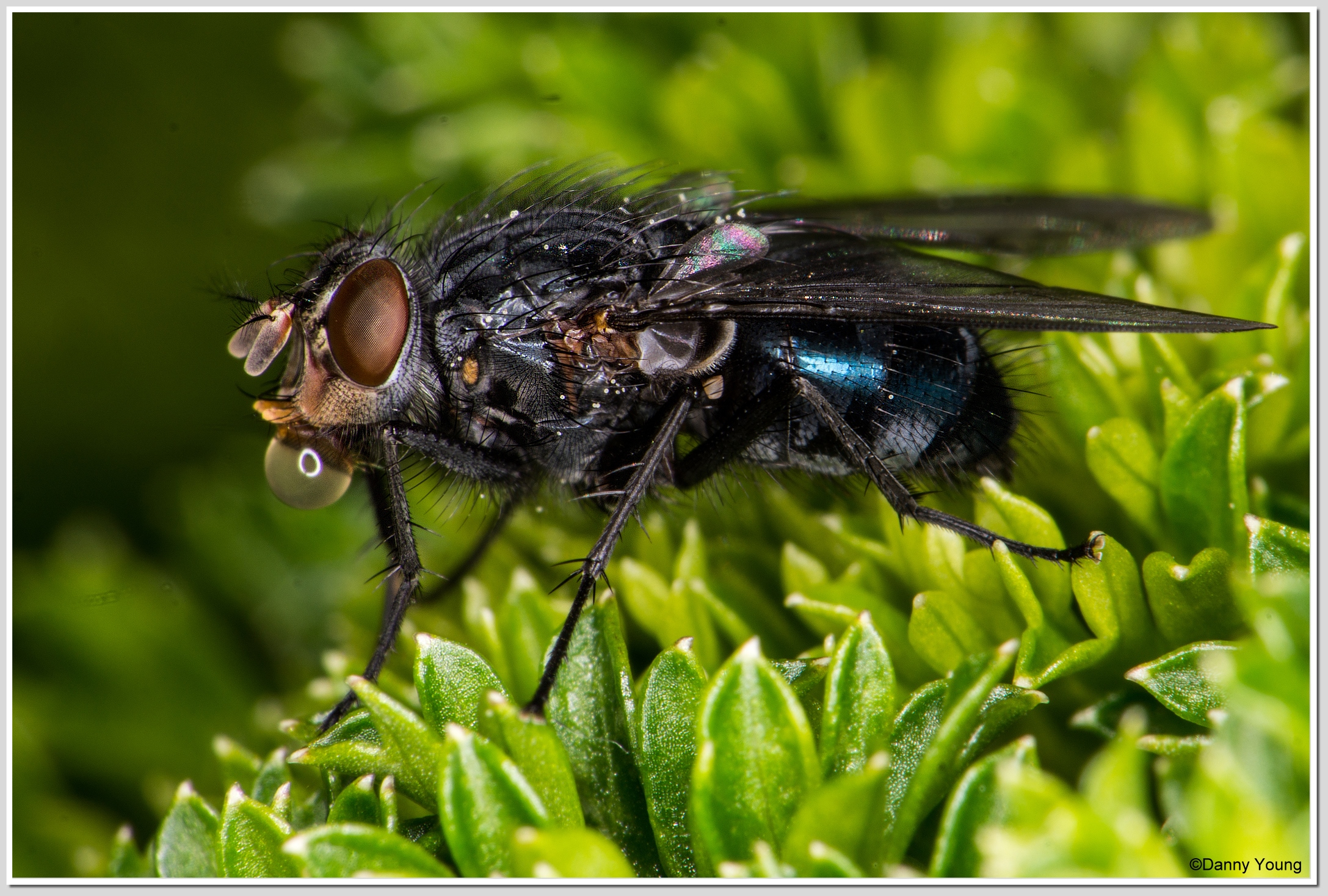

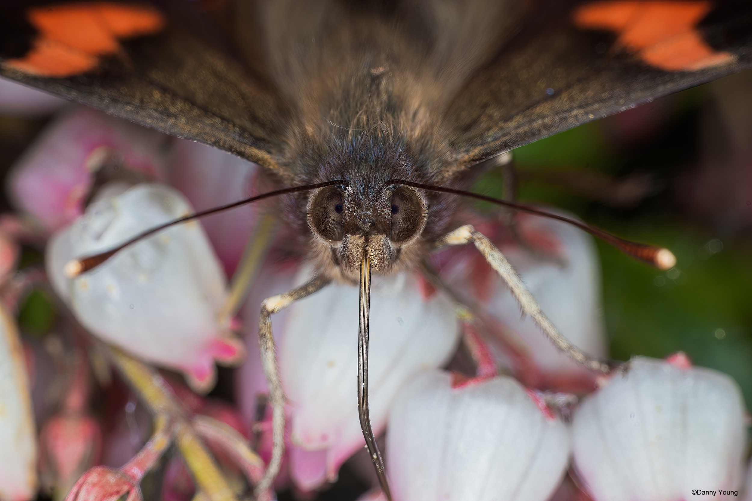

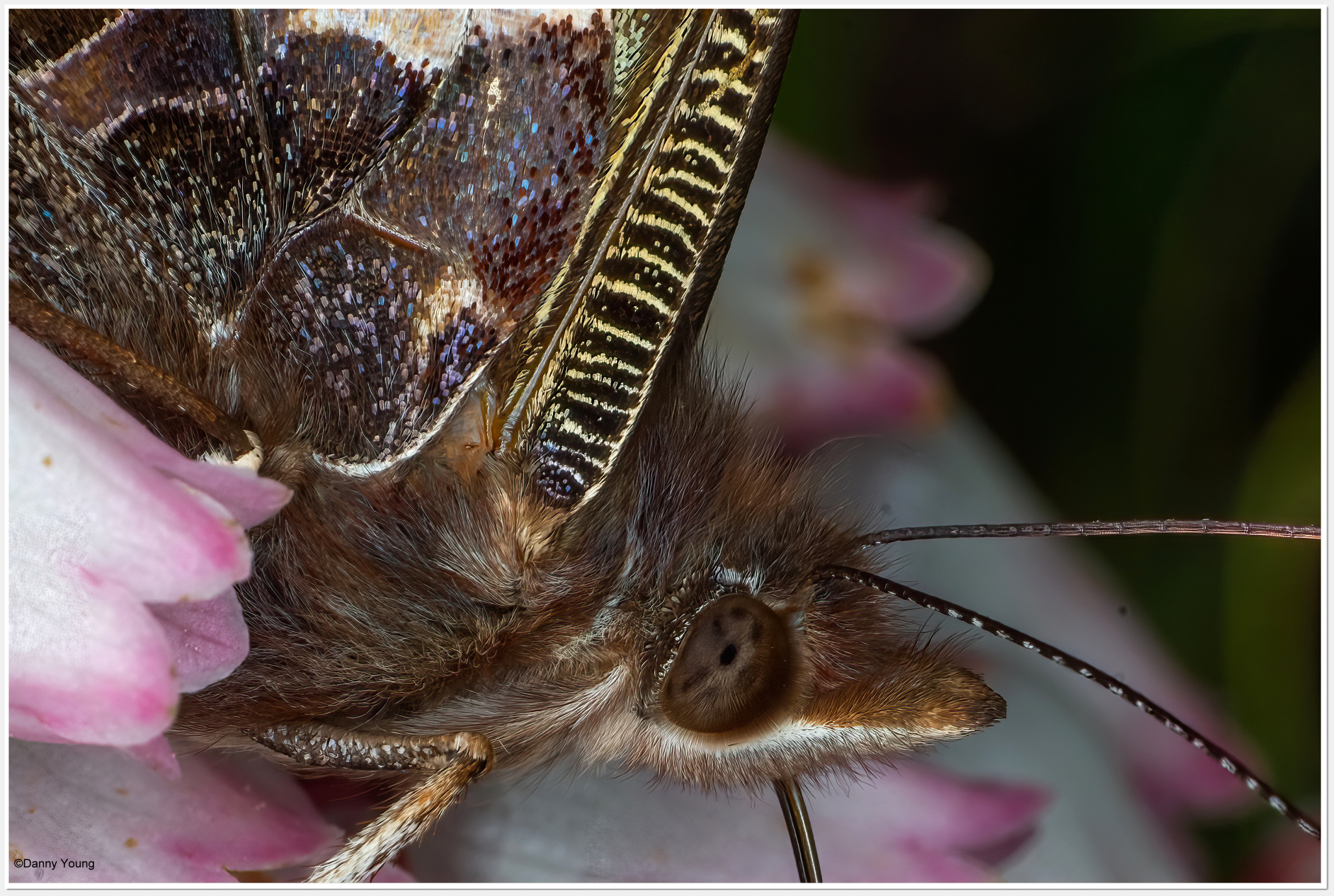

  • Members 435 posts
    April 5, 2023, 8:41 p.m.

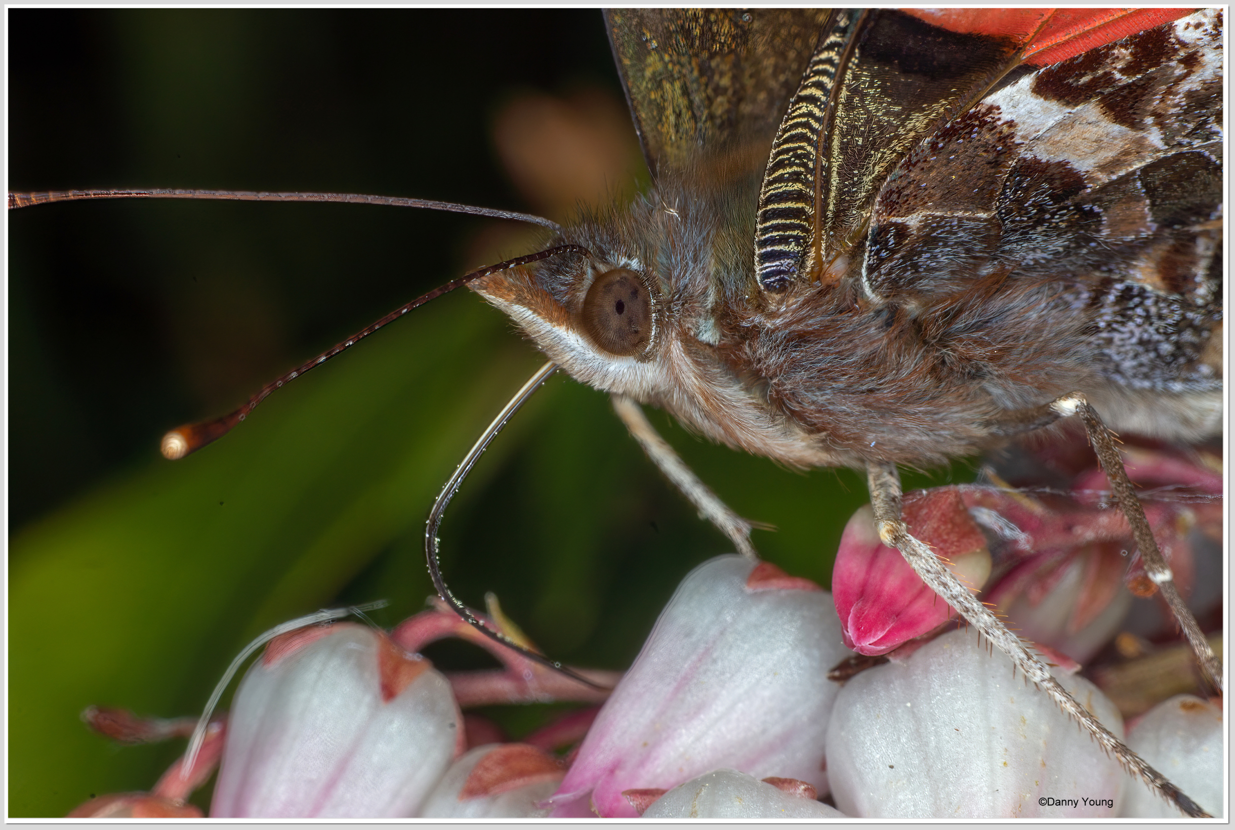

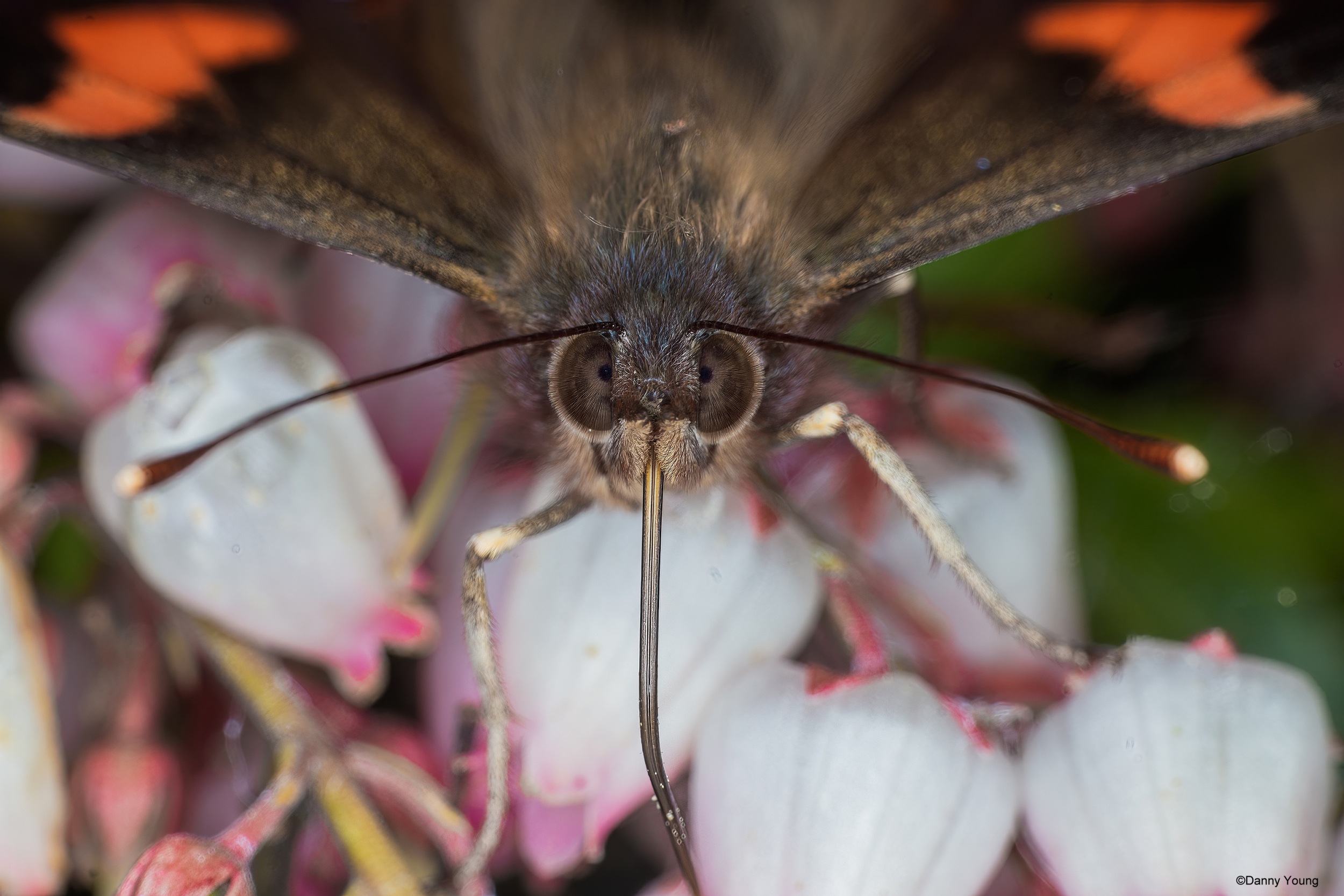

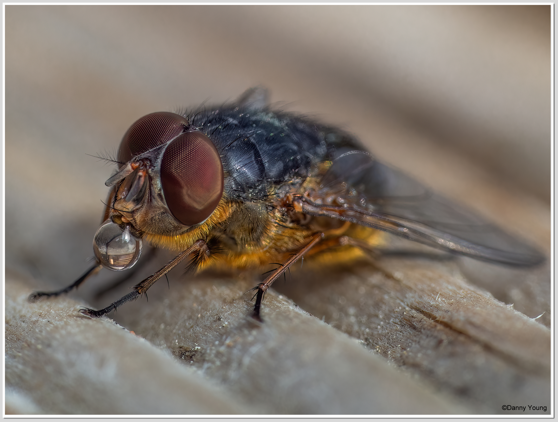

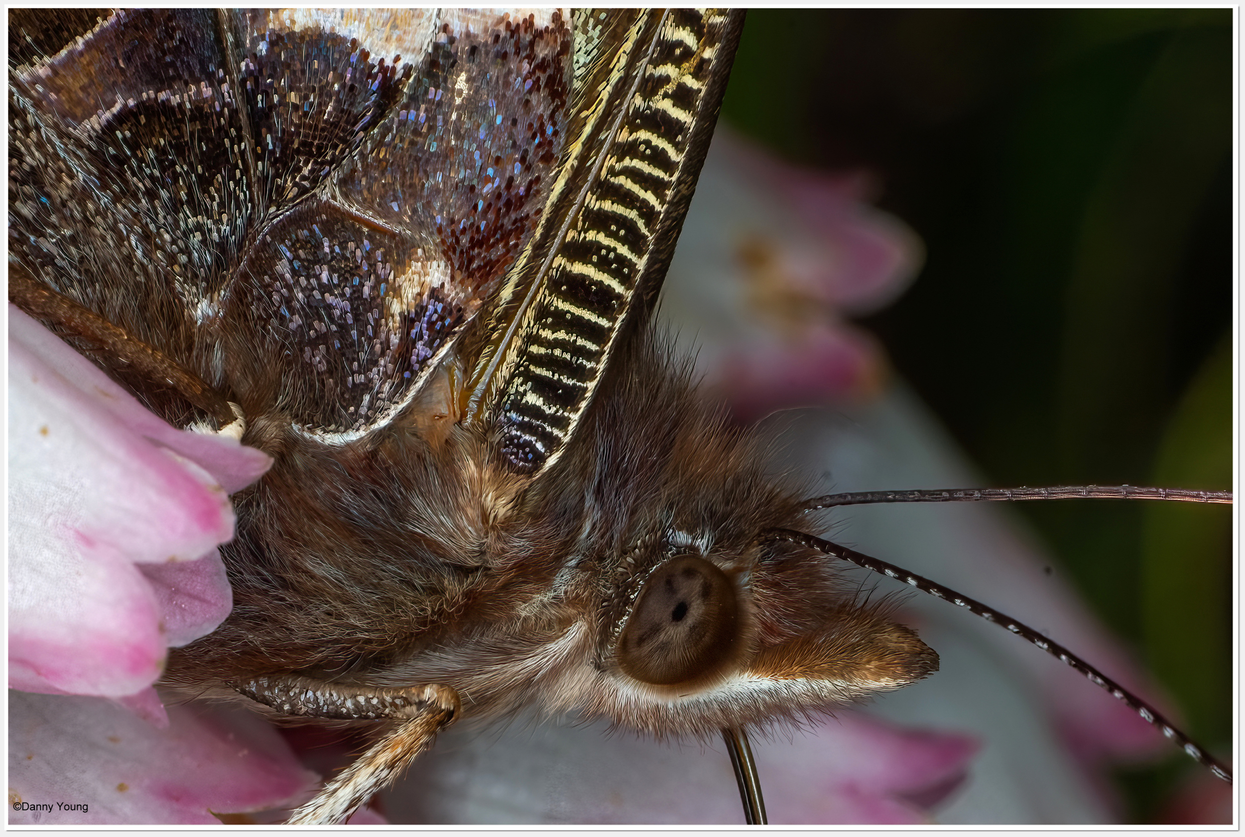

    Regarding the Raynox DCR-250
    The Raynox DCR-250 on a Canon FD 100-300. Dead subjects simply don't appeal, if it's not breathing, I'm not interested.
    So we are looking at a lens to subject distance of 150mm to 180mm depending on the zoom set. Prefer a zoom for the versatility of the macro ratio. DOF at F/32 is still really slim, so you need to be deadly accurate in focus for sure. I find manual focus is the way to go at higher ratios. With that setup, up to a 4:1 is possible.
    Of course it also depends on what format you choose. Red admiral butterfly and a fly
    There's not many that want that though and to be honest, I far prefer to see the entire subject, not just part of it. To each their own I guess. Don that's in the forum somewhere here takes amazing high ratio macro shots, but he's also very clever about it.
    Danny.
