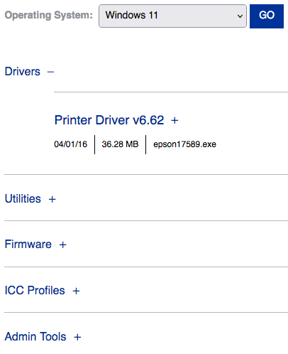

    GracieAllen
    Members 17 posts
    April 25, 2023, 11:30 p.m. April 25, 2023, 11:30 p.m.
    Yeah, that's the place I've been going all day. I can't get anywhere...
    And while I"m asking - is there a way to get images LOCALLY? WITHOUT having to go through the whole "image address", ftp, find the address junk?
    Anyhow, here the screenshot... Notice that the Operating system is MISSING! I don't know what I've got set in Firefox, but once I went to the address in Chrome, it FOUND Windows 11.
    dperezphoto.com/x.jpg
    OK - I may be having an exceptionally stupid day, but I DON'T see a printer driver. I see Utilities with a Net Config utility, Firmware with a couple firmware updates, ICC profiles with a whole bunch of stuff in there, and Admin Tools with the same Net Config utility. Is there someplace where there's an obvious Windows 11 printer driver that I'm missing?
    I TOLD it I had windows 10 and it provided a driver for that - looks like the 3880 is using the OLD driver?
    Greg
    Members 608 posts
    April 26, 2023, 12:06 a.m. April 26, 2023, 12:06 a.m.
    If the page is not rendering correctly, it may be because you are running an Add or Script blocker?
    Anyway, here are direct downloads for the whole shebang.
    Attention: Your operating system may not be detected below. It's important that you manually select your OS in the Operating System drop-down menu below to ensure you're viewing only compatible files.
    These are all for Windows 11
    Drivers
    Printer Driver v6.62
    • 04/01/16
    • 36.28 MB
    ftp.epson.com/drivers/epson17589.exe
