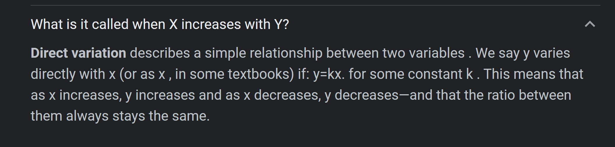

    April 3, 2023, 11:56 p.m.
    That's just plain weird. You could also say velocity increases with brake pedal application. Or sunburn risk decreases with exposure to sunlight.
    PNG, 99.4 KB, uploaded by JimKasson on April 3, 2023.

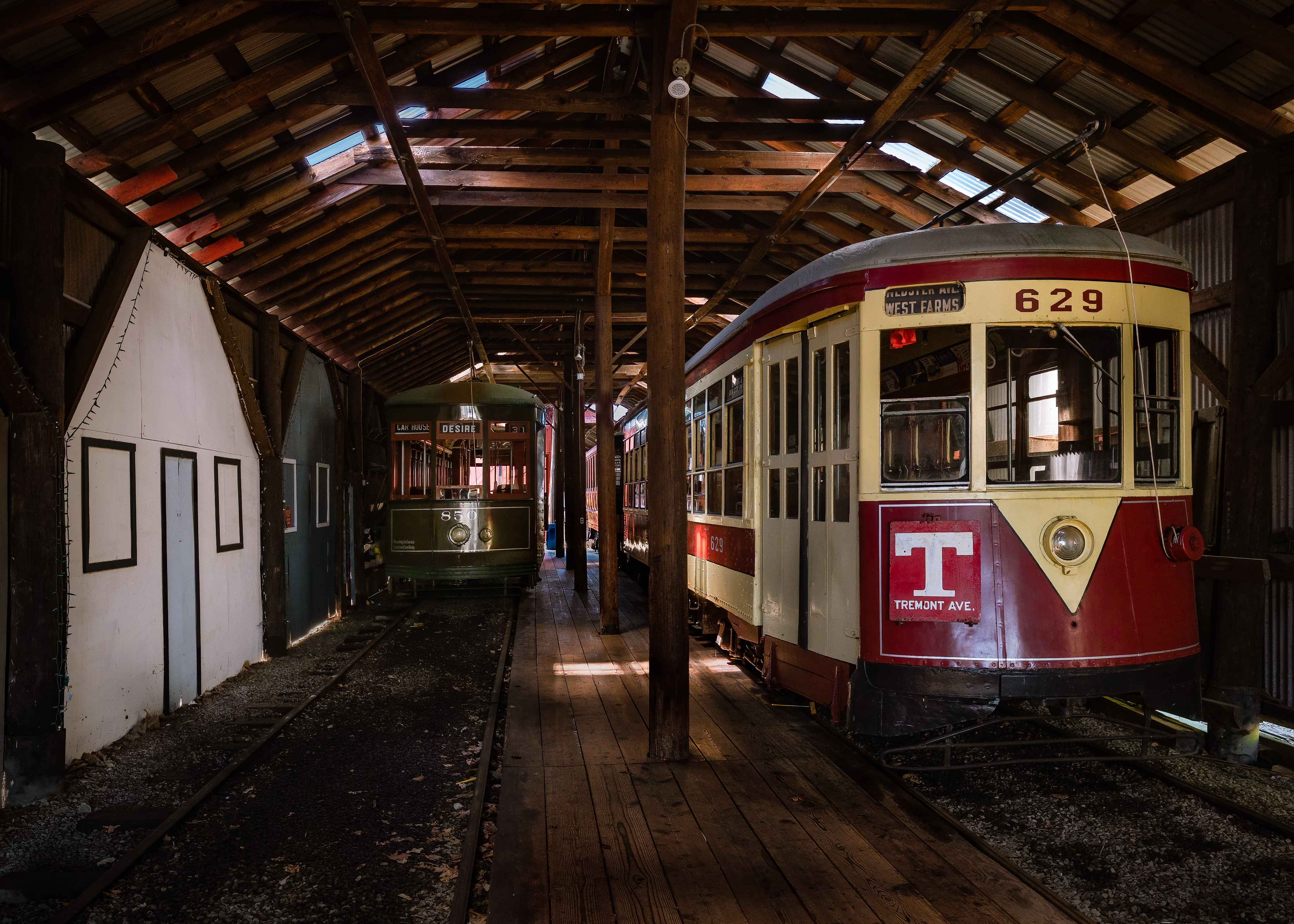

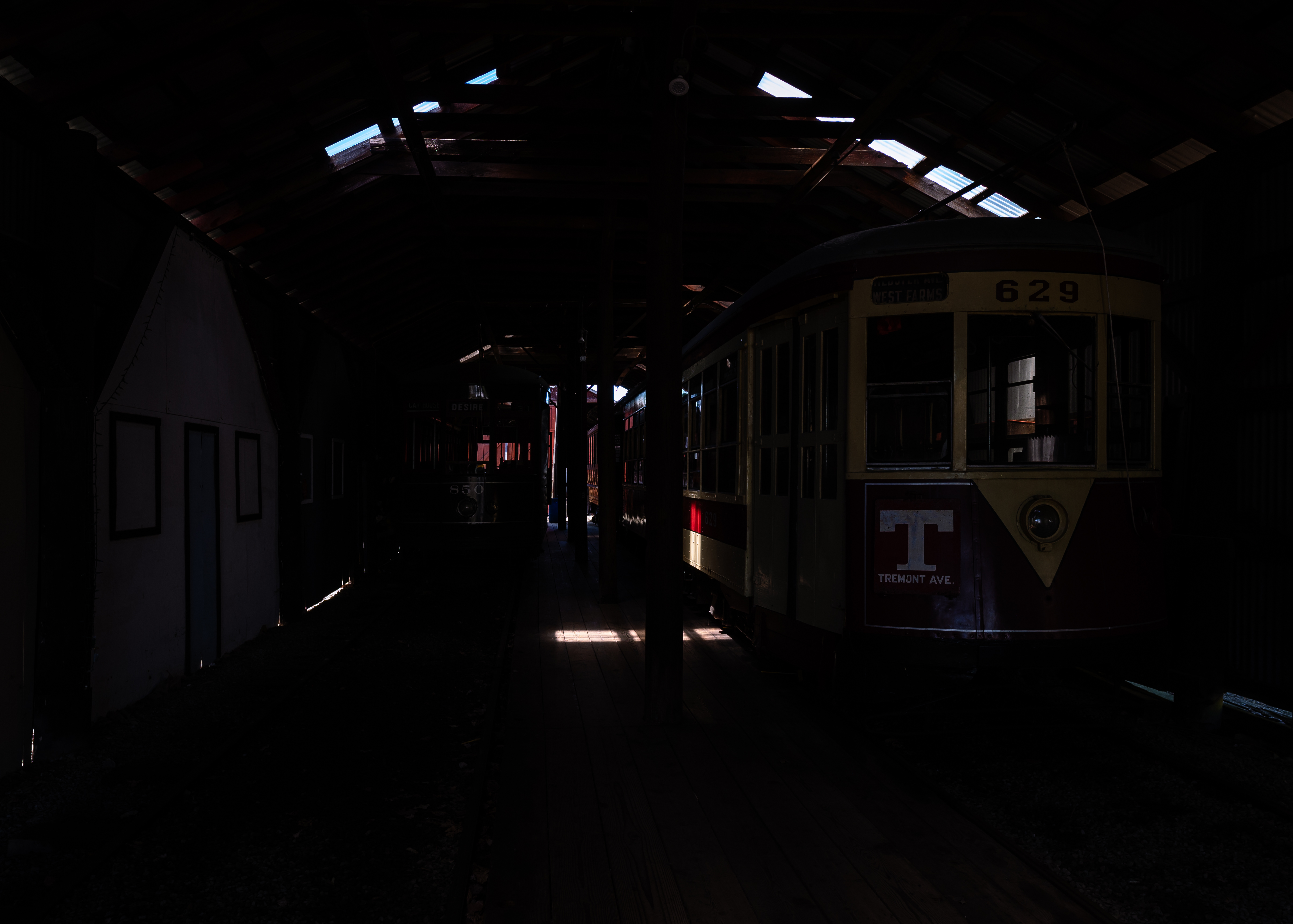

  • Members 267 posts
    April 4, 2023, 12:33 a.m.
    While underexposure and overexposure will make an image lighter or darker, to ensure the best possible signal to noise ratio and maximum dynamic range, optimal exposure is about recording as much sensor exposure as possible without blowing any important highlights (or compromising DOF/motion blur etc.) and can easily result in an initially too light or too dark image.
    Clearly, this RAW image initially appears too dark, but was it underexposed?
    Not if you wanted the highlight detail intact it wasn't...
    Sure, but image brightness and exposure should be considered and handled independently, they are not the same thing.
    JPG, 3.1 MB, uploaded by ErikWithaK on April 4, 2023.
    JPG, 2.9 MB, uploaded by ErikWithaK on April 4, 2023.
