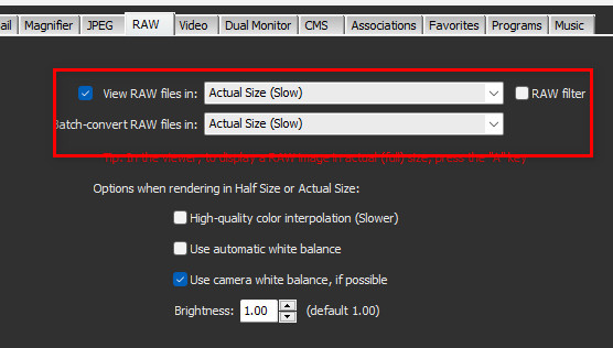

    I wanted to try this free image viewer from fast stone to cull my raw images quickly using it's tag feature.
    Full screen preview is working fine with embedded jpg images. But when i changed to Actual size in setting i only get blank black screen. This is happening to all RAW files not just one camera.
    JPG, 52.1 KB, uploaded by Mahi on April 19, 2023.

    go into the faststone menu and set the raw parameters. for fast load or slow. are you shooting compressed or uncompressed ?

    do you know where to set the raw settings from ?

    I think I know where to set the parameters. I have attached a photo in my first post. That's the place right?
