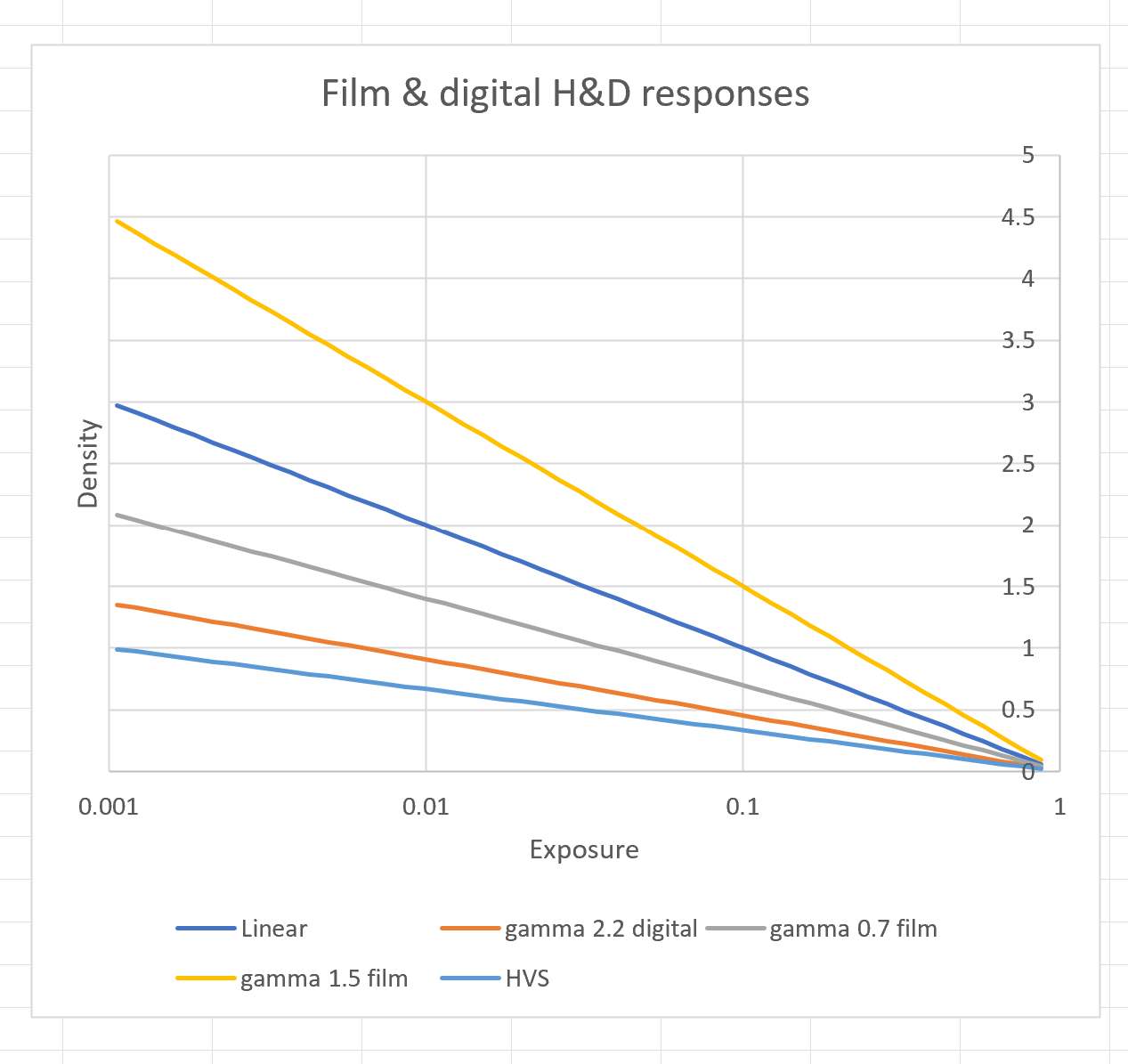

    Someone recommended a Bruce Fraser white paper that he wrote for Adobe in 2004. It’s still up on the web. I read it. It seemed that it was far from Bruce’s finest work. I read it again, and noticed more things that are wrong with it. I now think that it is not only error-ridden, but that it is conceptually wrong and should be pulled. Some of the errors are being promulgated even today, and so some explication is in order.
    In this post, I'm only going to concern myself with the first two errors.

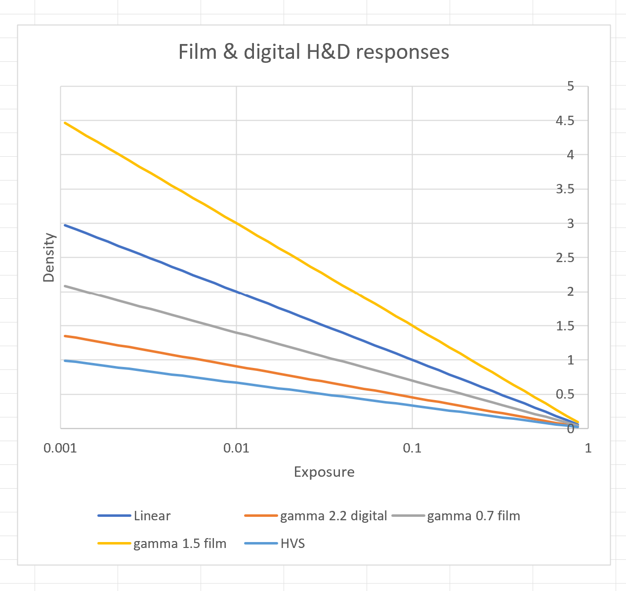

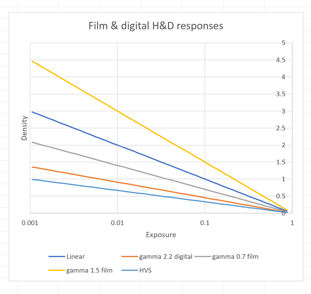

    Here's the beginning of the article:
    There are two assertions that I’d like to examine. The first is that film and digital respond to light in fundamentally different ways, and the second is that film responds to light like the human visual system (HVS).
    If you’re used to film sensitometry, you’re familiar with the Hurter and Driffeld (aka H&D) curves. They are also known as D log E curves. In these curves, the x-axis is the base 10 logarithm of the exposure, and the y axis is the base 10 logarithm of the absorption of light. That last quantity is also known as density. In the following graph, I’ve plotted a linear response, which is what most digital sensors have. It is possible to develop film so that it is linear through much of its exposure range, and the linear line can serve as a proxy for that. Negative film usually has more of what Bruce calls compression: if you lower the exposure to half of what it was, the density won’t halve, but will go down by less than that. A gamma of 0.7 is not uncommon for developed negative films. Slide, or reversal, film not only doesn’t exhibit compression, it expands the input: if you halve the exposure, the density will more than double. A gamma of 1.5 is typical of slide films developed normally.
    Gamma in digital images is specified differently than with film. An image encoded with a gamma of 2.2 will look right on a monitor with a gamma of 2.2. In film sensitometry terms, we’d say that file had a gamma of 0.45. There are several different ways to estimate the nonlinearity of human visual response. For small changes, the lightness axis of CIELab works pretty well. For most of its range, CIE Lstar is the input lightness to the one-third power. In display gamma terms, we’d say it has a gamma of 3.
    All of those are plotted on the graph below.
    In order to make the different sensor media comparable, I’ve rendered the negative plot above as a positive.
    The two film curves are on both sides of the linear one that represents digital capture. Even the flattest film curve is a long way from a gamma 2.2 display, and even further from the human visual system lightness nonlinearity. I see little justification for saying that film capture offers nonlinearities that are far different from digital capture, or for making the claim that film capture nonlinearities are close to those of the human visual system.
    PNG, 70.6 KB, uploaded by JimKasson on April 20, 2023.

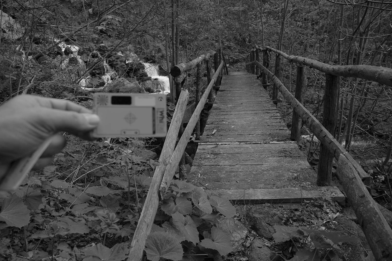

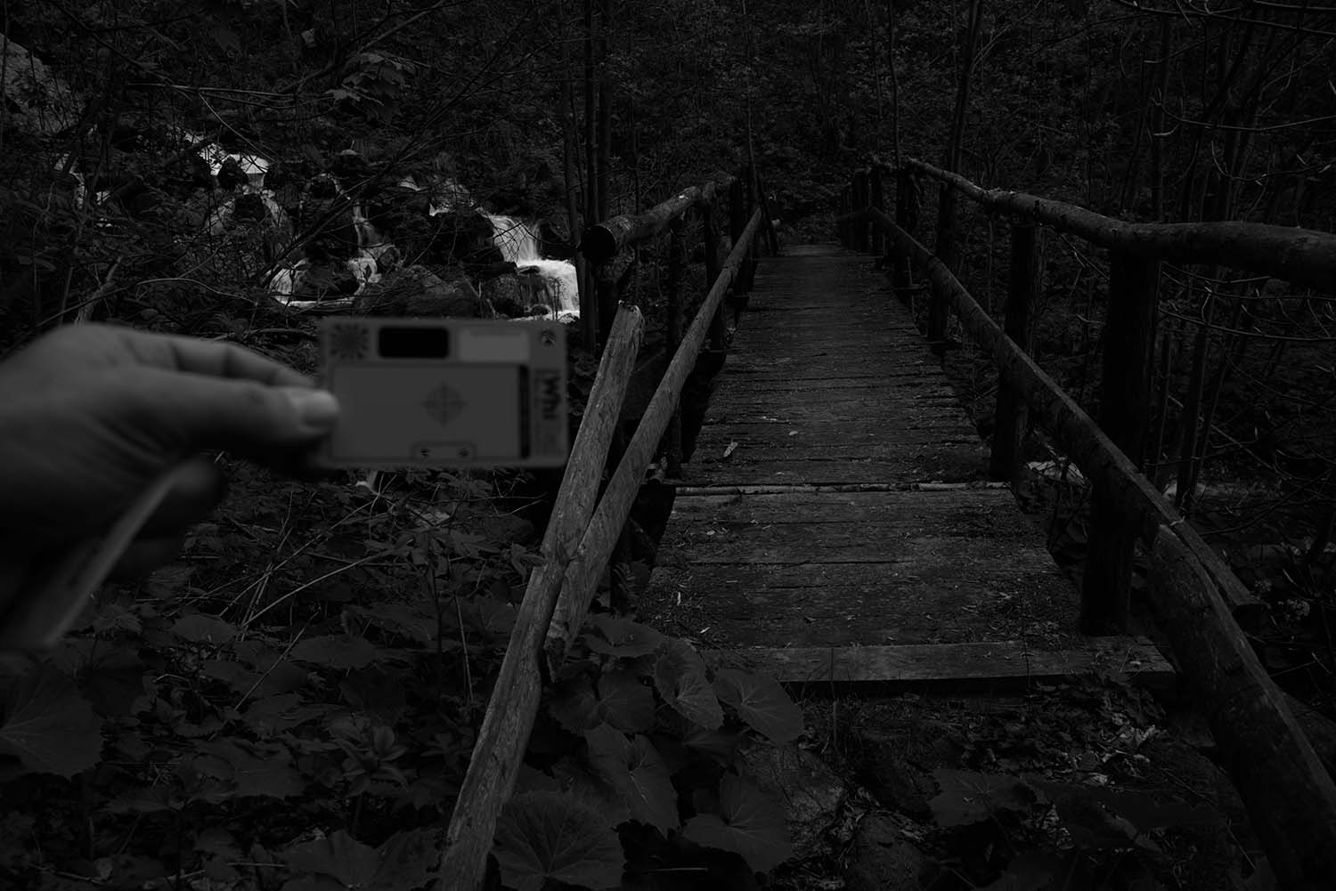

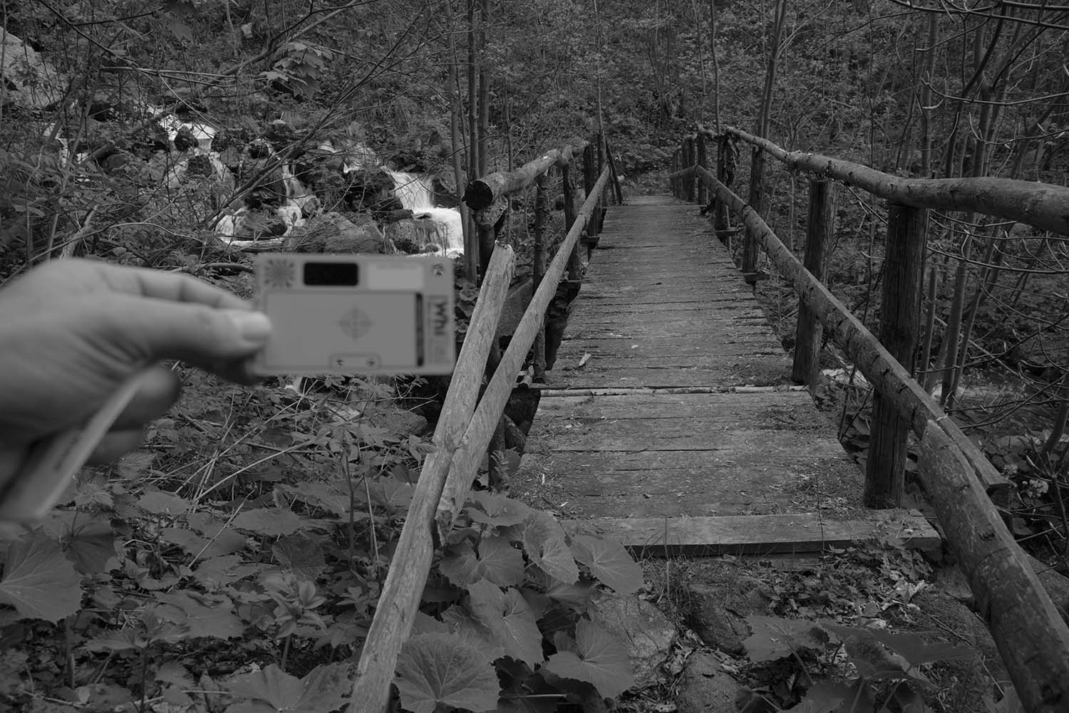

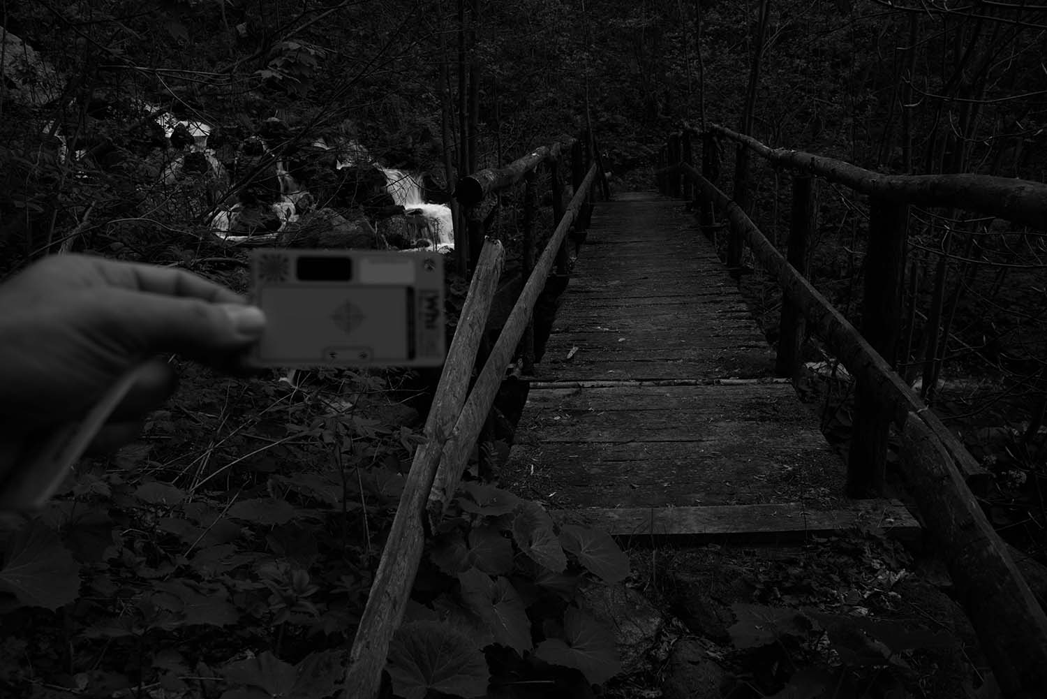

    Right. My pet peeve with that white paper is that it gives the impression that a raw/linear image is 'dark' because the sensor does not 'mimic the eye's response to light'. This is incorrect and/or misleading, the eye expects a linear image as input, as previously mentioned here.
    Demo: The following two images are based on the exact same linear raw data. One of them was white balanced and saved as is with a linear gamma profile; the other in addition had gamma applied assuming a 2.2 gamma monitor and saved with an sRGB profile. They are from this article that explains how raw images are rendered.
    If the site and the browser are properly color managed, and the monitor is calibrated to a 2.2 gamma, they should look similarly bright* because the objective of the imaging system as a whole (camera, software, display medium) is to provide Luminance to the eye proportional (i.e. linear) to that from the scene. Any non-linearity introduced by film or the monitor ideally needs to be fully undone before it reaches the eye.
    So digital sensors respond to light just like the eye does, linearly. The HVS is then free to respond non-linearly to that linear input, as it always does.
    Jack
    • If they don't it's because one of the components in the system is not doing its job properly. I probably should have chosen a better example but this is what I had lying around.
    JPG, 135.0 KB, uploaded by JackHogan on April 20, 2023.
    JPG, 232.5 KB, uploaded by JackHogan on April 20, 2023.

    I have been told that film, at least in the range of its highest exposure capacity, does not simply blow out white (actually black in the negative), but digital sensors do. In other words, film handles overexposed highlights better. I always wondered if this is actually true. If it is, the film is indeed more non-linear than a sensor.
    The next question I have in this regard is about the dynamic range of the eye. It seems to be only so big because we can adapt with the iris. So, saying that the eye can adapt to 10000 times the light (12 stops), but the sensor cannot, makes no sense to me. A camera has an aperture and a shutter speed.

    April 20, 2023, 6:14 p.m.
    That is true of negative film. That is not true of slide film.
    The nonlinear portion of a digital sensor highlight response is typically hidden from the camera user by the people who designed the camera.
    However, you could argue that a smooth rolloff is less nonlinear than hard clipping.

    I've been asked to explain where the 0.45 comes from. It's the reciprocal of 2.2. the film world specifies the gamma that the capture has when developed. The display world specifies the gamma of the monitor on which the image will look right.
