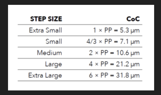

    Here's what the new manual says about step size:
    This is clearly wrong, since the pitch of the X2D is 3.76 um.

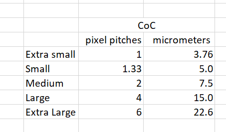

    MGrayson over at GetDPI has run a test to determine the actual step sizes.
    Here's my new table based on his test.
