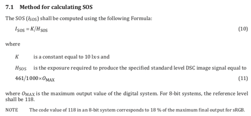

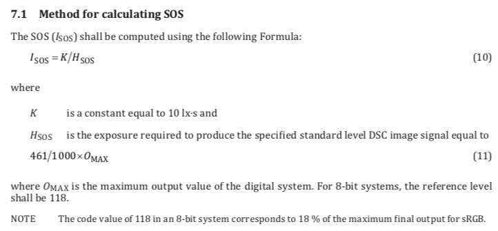

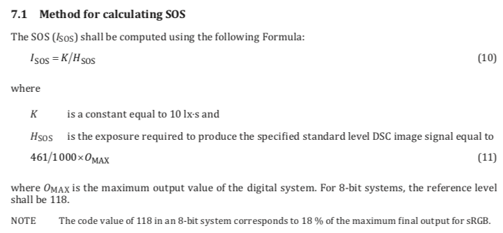

  • June 1, 2023, 9:06 p.m.
    The person who wrote that for Canon would have been better to use the word 'lightness', rather than 'brightness' and certainly shouldn't have confused it with exposure.
    So far as the ISO standard goes, it defines the most used version of ISO, (SOS) as follows:
    So, what it defines ISO as is a specification of 'value' against 'exposure'. 'Value' is another term for 'lightness', but a less descriptive one, which is why I prefer to use 'lightness'. It is the note that makes this clear, as it relates the 'level' to an sRGB 'value'.
    Anyhow, what the VF or LCD is showing is not the exposure, but the value or lightness which results from that exposure at the given ISO setting, according to the present processing defaults in the camera.
    That's a question for Canon's technical author, as to why the manual includes errors.
    The cameras meet the standard, so far as I know. The manual is confused.
    PNG, 59.2 KB, uploaded by bobn2 on June 1, 2023.
