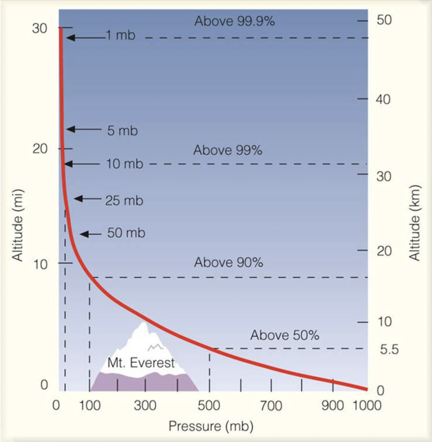

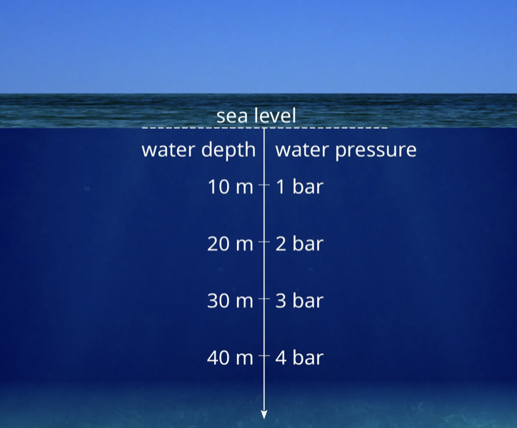

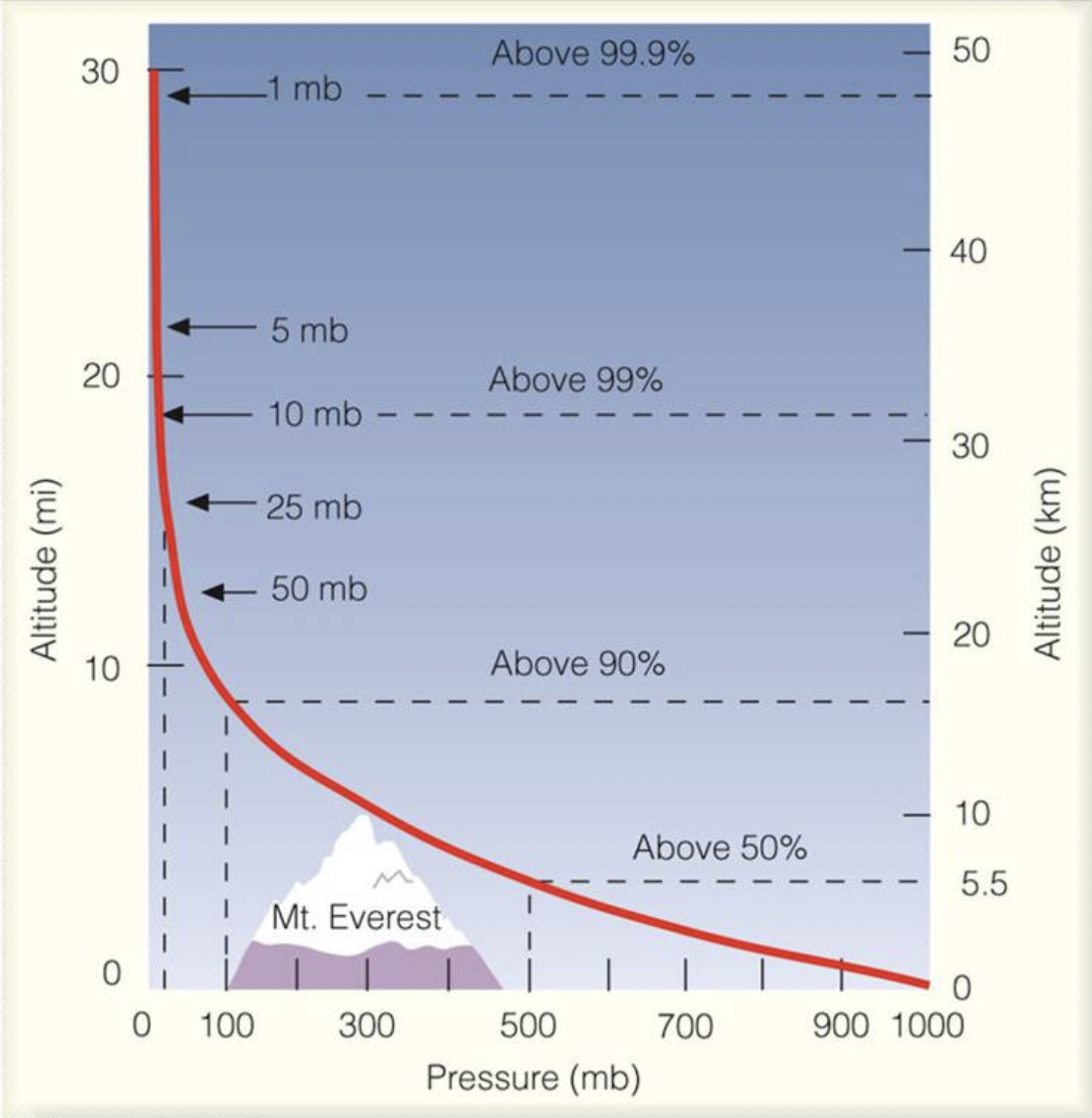

  • Members 35 posts
    May 24, 2023, 10:25 p.m.

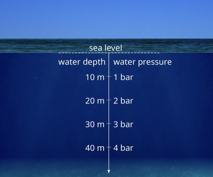

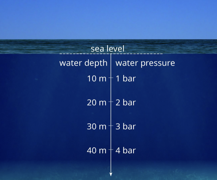

    Its not the density of, e.g. water, but the hydrostatic pressure that increases with depth.
    A balloon filled with air will become compressed the further down it is placed from the surface.
    The same applies to the atmosphere. At ground level there's approximately 1 tonne of pressure/square foot.
    A balloon filled with hydrogen will float up & expand the higher it goes.
    Perhaps this explains pressure differences better :
    Archimedes Principal
    Hydrostatic pressure
    PNG, 1.6 MB, uploaded by martinhb on May 24, 2023.
    PNG, 627.4 KB, uploaded by martinhb on May 24, 2023.
