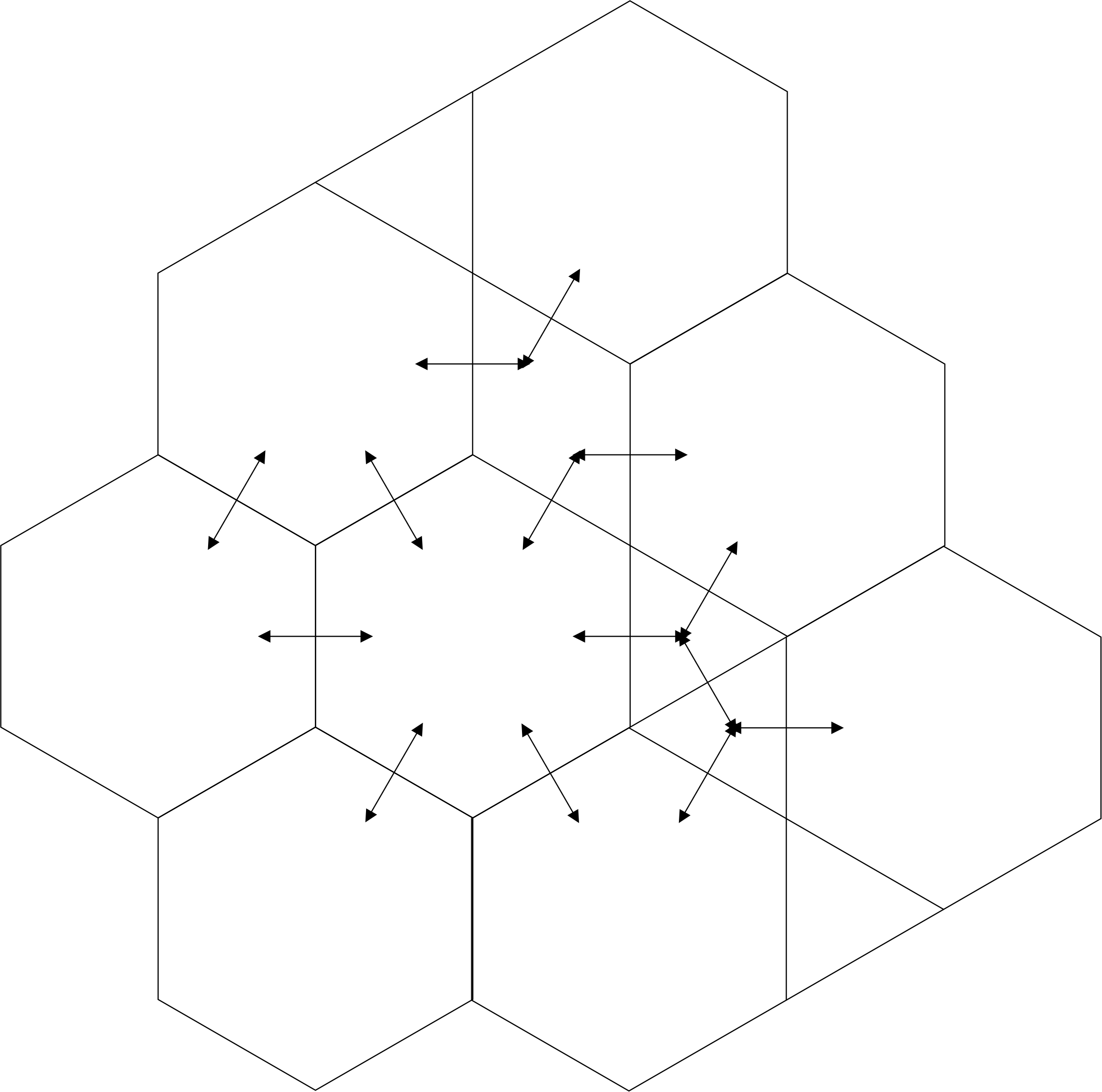

  • May 31, 2023, 4:54 p.m.
    Good, it looks like this: (No references to Kurt Vonnegut intended.)
    Now I start with first model under some assumptions:
    • we have homogenous fluid or gaseous environment (our environment is not infinite, but boundaries are very far away and do not affect our model)
    • our environment is anisotropic - no preferred direction /edit: no one noticed terminology error here🙃/
    • we analyze only static conditions
    • we have no gravity or any other outside forces present
    I marked some virtual boundaries around really small volumes and few of your tiny forces on those boundaries on next drawing - note that all forces are numerically equal (boundary lengths on picture are same) and perpendicular to boundaries. I hope these claims do no need explanations, they are based on our assumptions alone - but if required, I can explain more.
    Also I hope that despite my image being 2D and I'm talking about boundaries length, we can safely assume that in reality situation is 3D and boundaries have same surface area - this does not change overall picture.
    Is such image/situation agreeable and understandable?

  • Members 509 posts
    May 31, 2023, 7:12 p.m.
    Looks good...

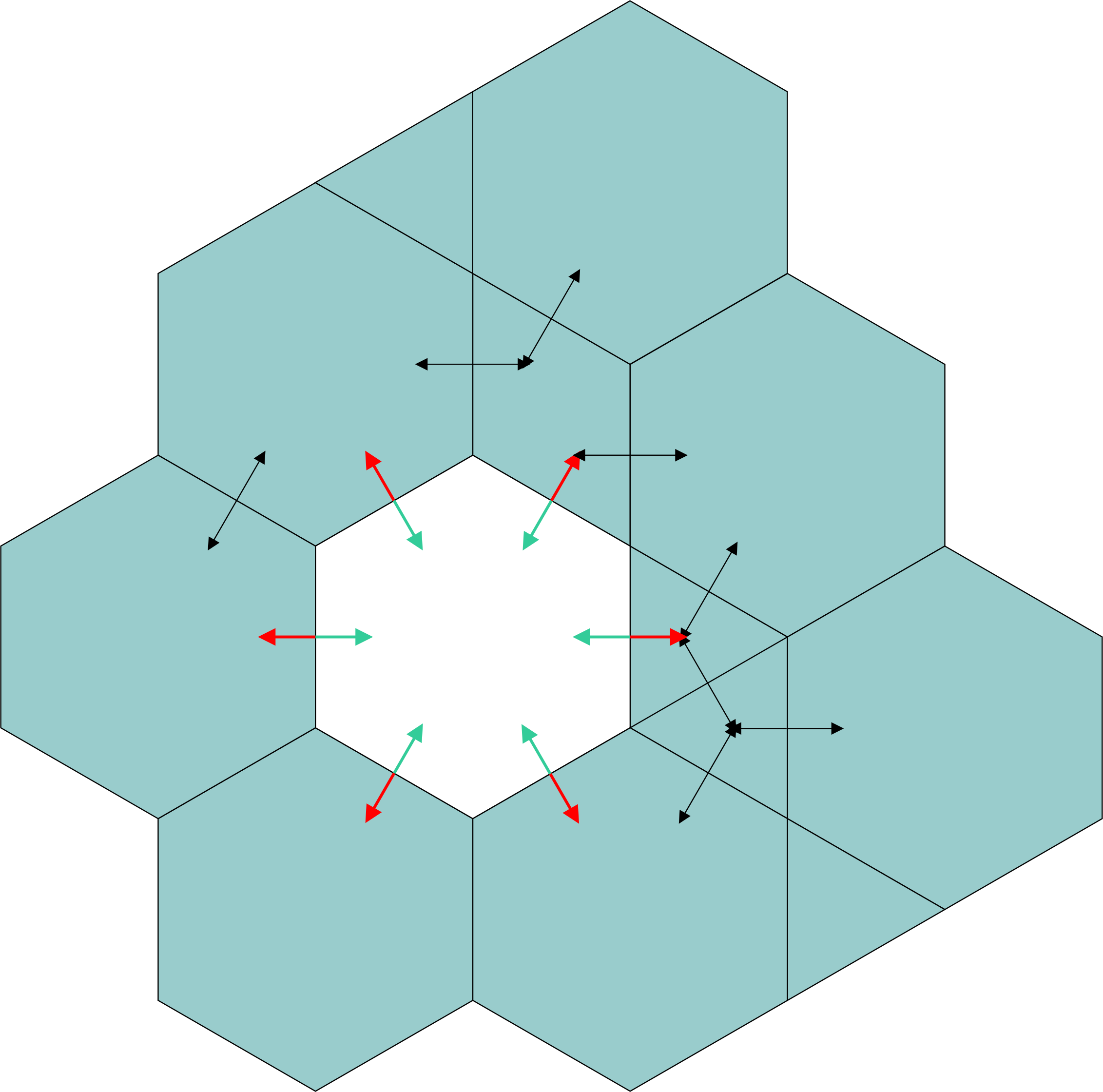

  • May 31, 2023, 7:33 p.m.
    OK, now we take two more steps (maybe they are side steps, but I think they may help later), continuing without gravity.
    1. We can safely assume that virtual boundaries are real boundaries (surfaces), infinitely thin, weightless, rigid and elastic (elastic here means there will not be absorbtion of collision energy) - entire picture will look exactly the same.
    2. We remove water from one "cell", resulting in next situation:
    Now we have similar looking forces, but their meaning is somewhat changed.
    Green arrows are your tiny forces from previous model - water molecules colliding with something.
    Red arrows are reaction forces to water molecules impacts. (They are of electrostatic nature as well - as are almost all forces between molecules.)
    As we have no gravitation, overall picture does not change - cell walls elastic reaction replaces previous water molecules action.
    We can leave cell empty or put anything inside evacuated cell, this does not affect surrounding fluid/gase behavior at all.
    PNG, 221.1 KB, uploaded by ArvoJ on May 31, 2023.

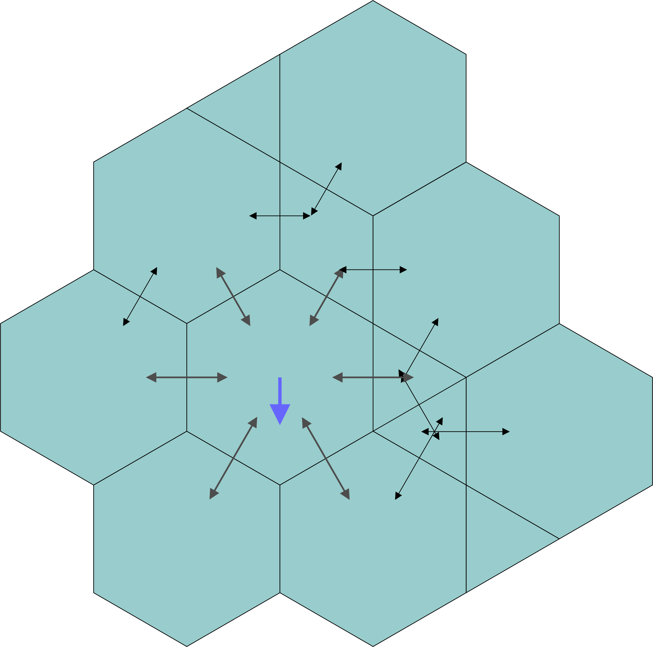

  • June 6, 2023, 5:09 p.m.
    I hope it is nothing serious!
    But well, let's continue.
    To recall most important claims and conclusions so far, for fluid or gaseous environment in static conditions:
    • our 'tiny forces' are caused by chaotic, non-directional movement and can thereby drawn as , not ↗ or ↙ or something else with clear direction
    • without external forces (gravity) we can replace any part of our environment with some solid object, this does not change any forces in surrounding environment

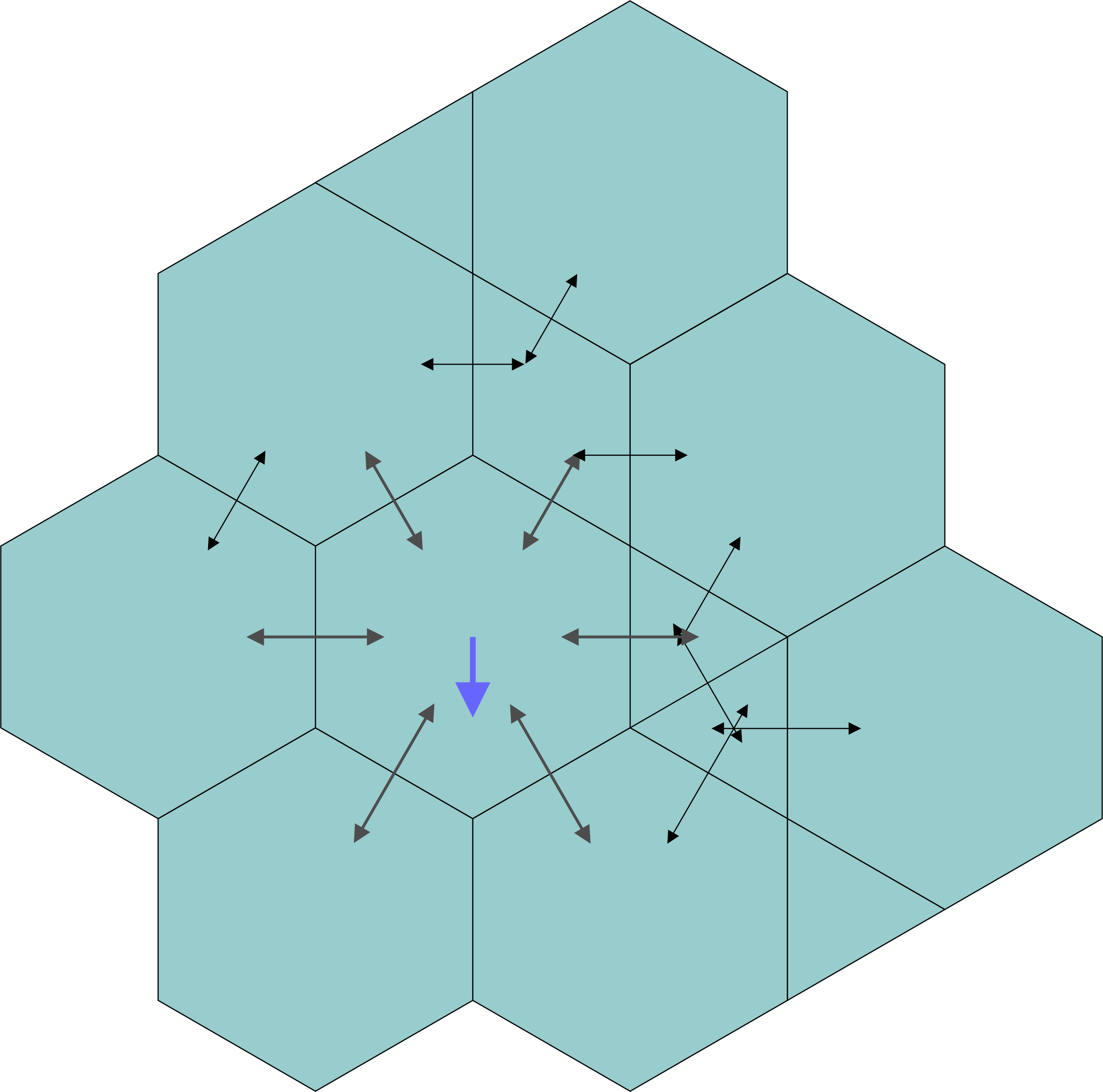

    Now we will introduce gravity, first without any additional objects or real walls in our environment (boundaries between 'cells' are again purely imaginary).
    As you can see, there appeared additional force to our tiny water droplet - bluish arrow on picture. Similar forces, caused by gravity, apply of course to all other 'cells' too.
    But we have condition that our model has to be static - this means that we must have some other force(s), balancing gravitational one. As there are no more 'big' forces, then apparently our 'tiny forces' need to be reconfigure itself in some way - in lower part of our droplet they need to be stronger (water molecules need to kick harder). As our forces are in form and symmetrical (otherwise water would start to flow into other directions, which is excluded by static nature of our model), then we can first conclude that they are equal at the same level (at same gravitational potential) and then that applying gravity creates 'tiny forces' gradient in entire environment, aligned in directon of gravity.
    As you can see on image, 'tiny' forces at lower level are drawn as longer arrows. Of course if our cell is tiny, then real forces differ much less - but they are certainly different.
    Although some words are explicitly forbidden here 🙃, I will anyway note that those non-directional forces are called pressure. Previous claim can also be reworded as "applying gravity to fluidous/gaseous environment creates pressure gradient".
    PNG, 225.6 KB, uploaded by ArvoJ on June 6, 2023.
  • Members 509 posts
    June 8, 2023, 12:33 p.m.
    Just got back from seeing the physio at my GP's surgery. She has given me an exercise to treat my "trigger finger" problem (fingers lock in position and won't move) - likely caused by typing too much stuff about buoyancy 🙂, she's diagnosed my shoulder/arm problem and will send me an exercise programme to deal with that, but the back will have to wait for another appointment. Hopefully it will get a bit better on its own.
    My description of your scenario above:
    In the absence of gravity, we have a bunch of particles all vibrating randomly. Each particle moves randomly back and forth about a point. This movement causes there to be lots of random collisions with neighbouring forces. On average, these cancel out and thus we have a static situation.
    With gravity added, all the molecules also have the force of gravity pushing (pulling) them downwards towards their neighbours below (who push back equally and oppositely). The whole group of particles should fall as a block. No idea how the block remains in a static position.

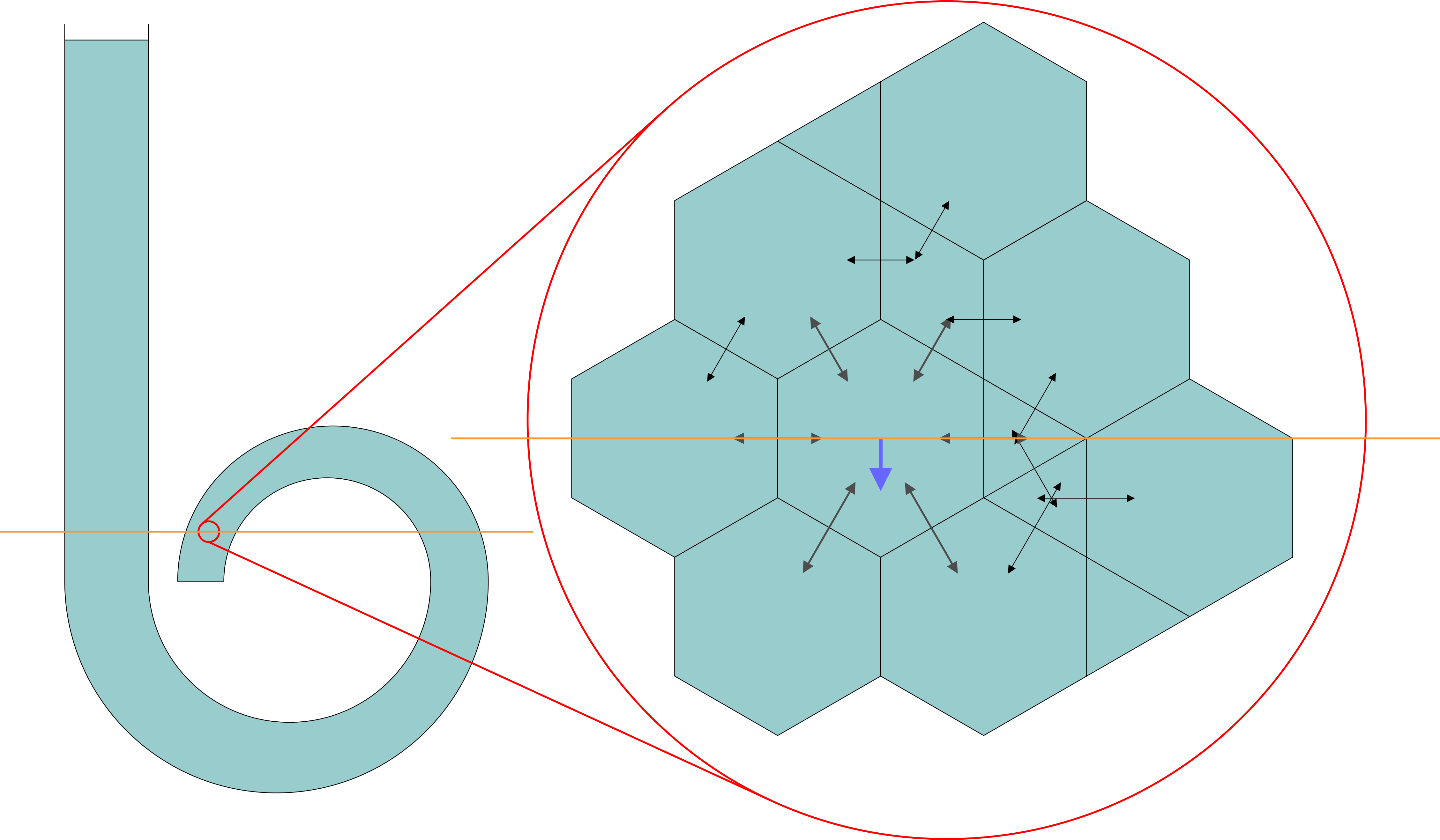

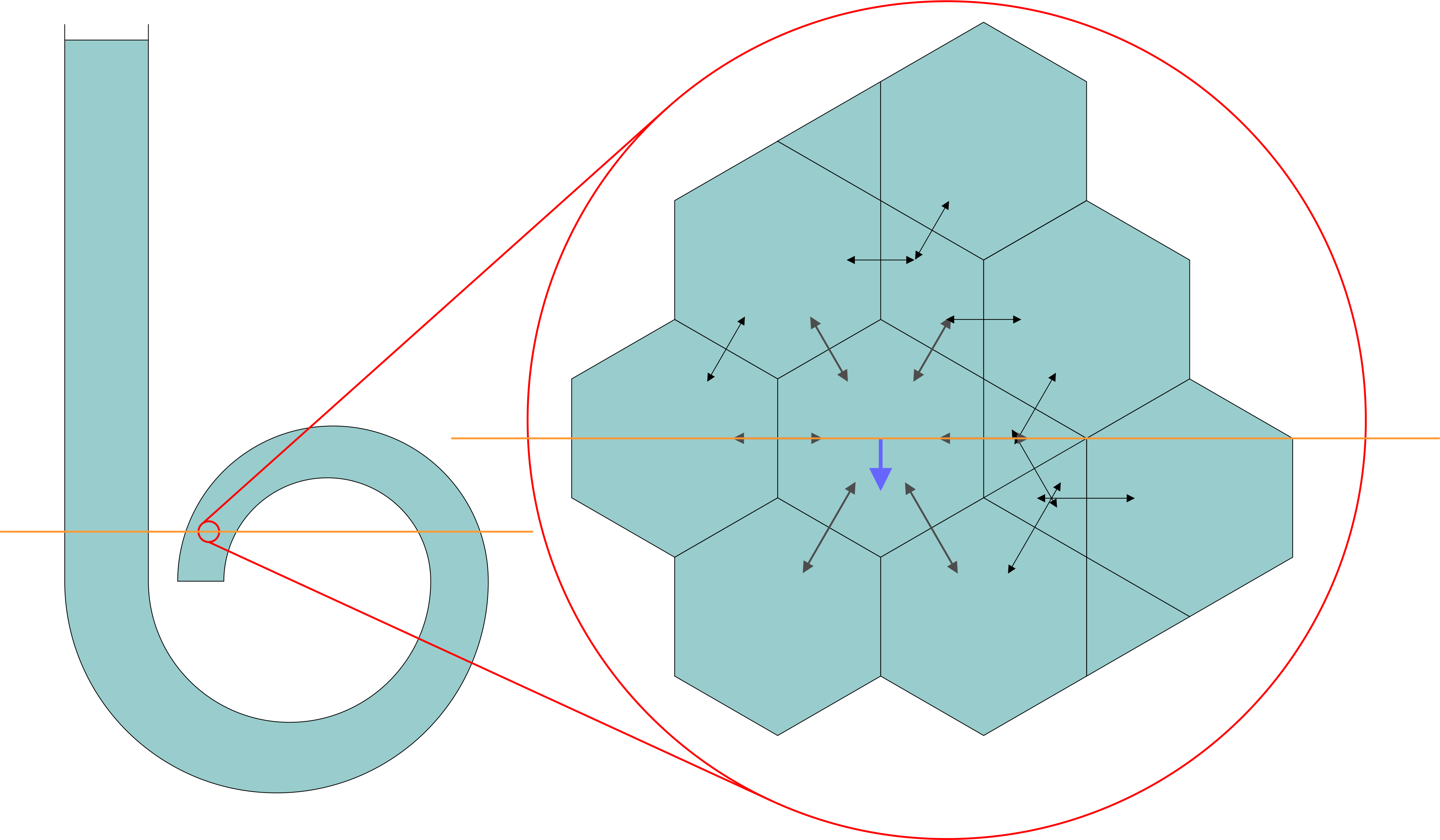

  • June 8, 2023, 6:20 p.m.
    I should have guessed that 🙃
    You inverted my assumption - remember, we have static situation and we need to find out, what happens then.
    But well, let's confine our water somehow - like I said many postings ago, to hold water in place we have to put some walls somewhere. Like on next image:
    Now we have perfectly bottled water, gravity is vertical, our tiny droplet is also located there (my previous model is just magnification of it).
    I did not draw forces at water-bottle surface, but they are reaction forces to water molecules, similar situation we have talked before.
    I won't explain what happens at the top surface of water - this is very different topic.
    By orange lines I have marked levels, where tiny forces (pressure) have to be equal.
    Can you explain, why? In few words, to not hurt your finger :)
    PNG, 491.7 KB, uploaded by ArvoJ on June 8, 2023.
  • Members 509 posts
    June 12, 2023, 9:48 a.m.
    Assuming the blob of water is held in place by the walls of the bottle, and assuming your orange line goes through the centre, I guess forces half to balance to prevent the top half of the blob pushing the bottom half out of the way (or the reverse).
    But I doubt somehow that is what you meant....Please enlighten me 🙂
  • June 14, 2023, 8:42 p.m.
    For given tiny cell it is correct. A bit more generally - molecules below some water volume need to counteract to weight of 'upper' molecules; they would gladly move away - but there is nowhere to go, molecules in the neighbourhood have similar 'pressure' from upper ones and then we have walls, which don't go away. 'Lower' molecules thereby just need to kick harder (= exert bigger force) to keep situation stable.
    Then we claim that forces on same level are equal.
    Remember that the only external force (gravity) is vertical, there is no horizontal component of it - this implies that forces cancel out in horizontal direction or in other words, they are just equal. Or in prohibited :) words - pressure at the same level is equal.
    (Wikipedia calls related principle as 'Communicating vessels'.)
    This holds even in strange geometric forms, like our bottle above - pressure at a level, marked by orange line, is equal in all three areas.
    Can we use the word pressure for our tiny forces from now or should I continue to avoid that?
    I mean do you start seeing pressure as a result of omnidirectional (molecular) forces or not yet?
    Few posts ago you attempted to assign direction to pressure, this is not possible in our static fluid or gaseous environment - I hope you have changed your mind :)
    (I'm really not a teacher kind of person.)
