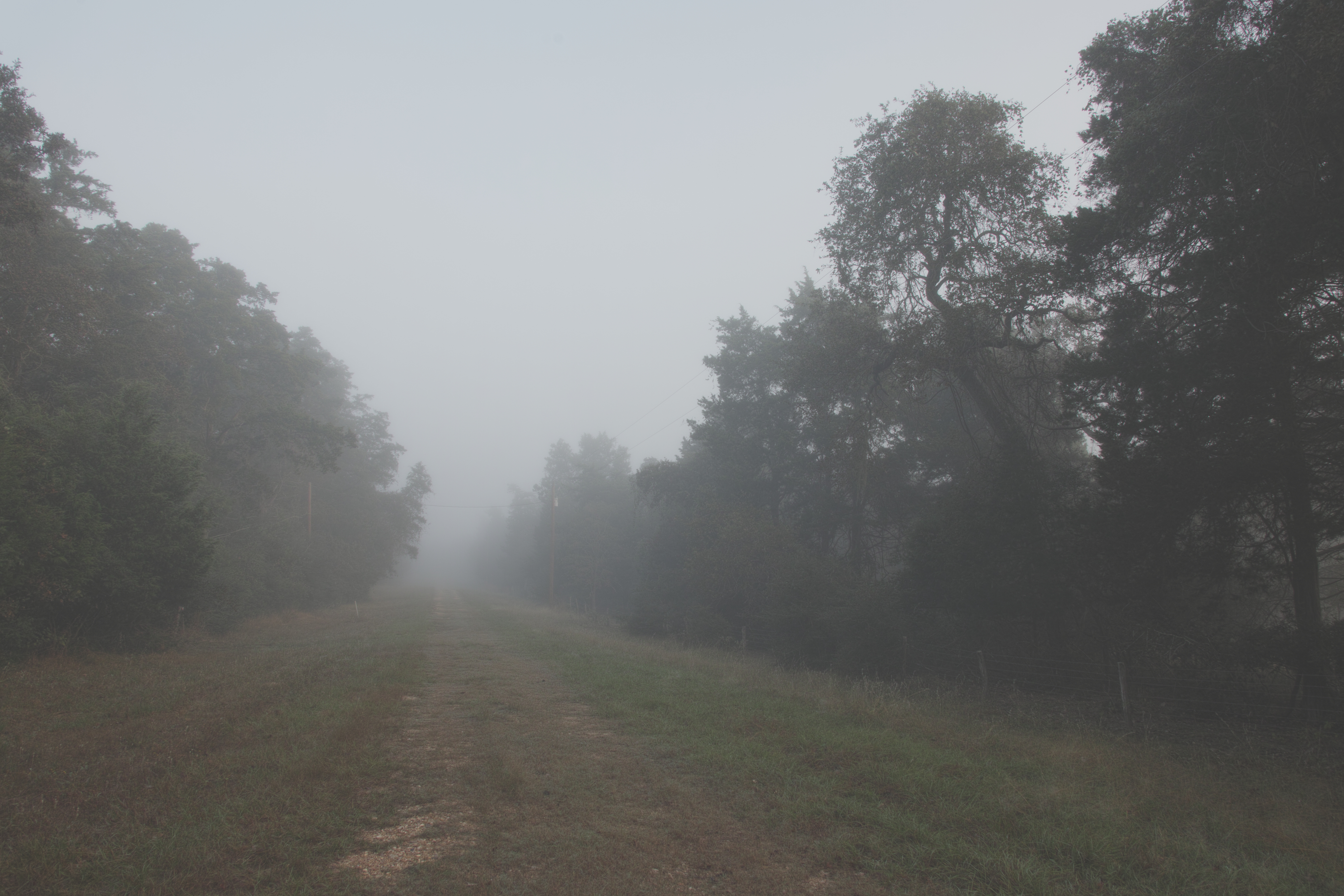

    Haze, mist and fog all tend to reduce the contrast, but often more so to the darker parts of the image.

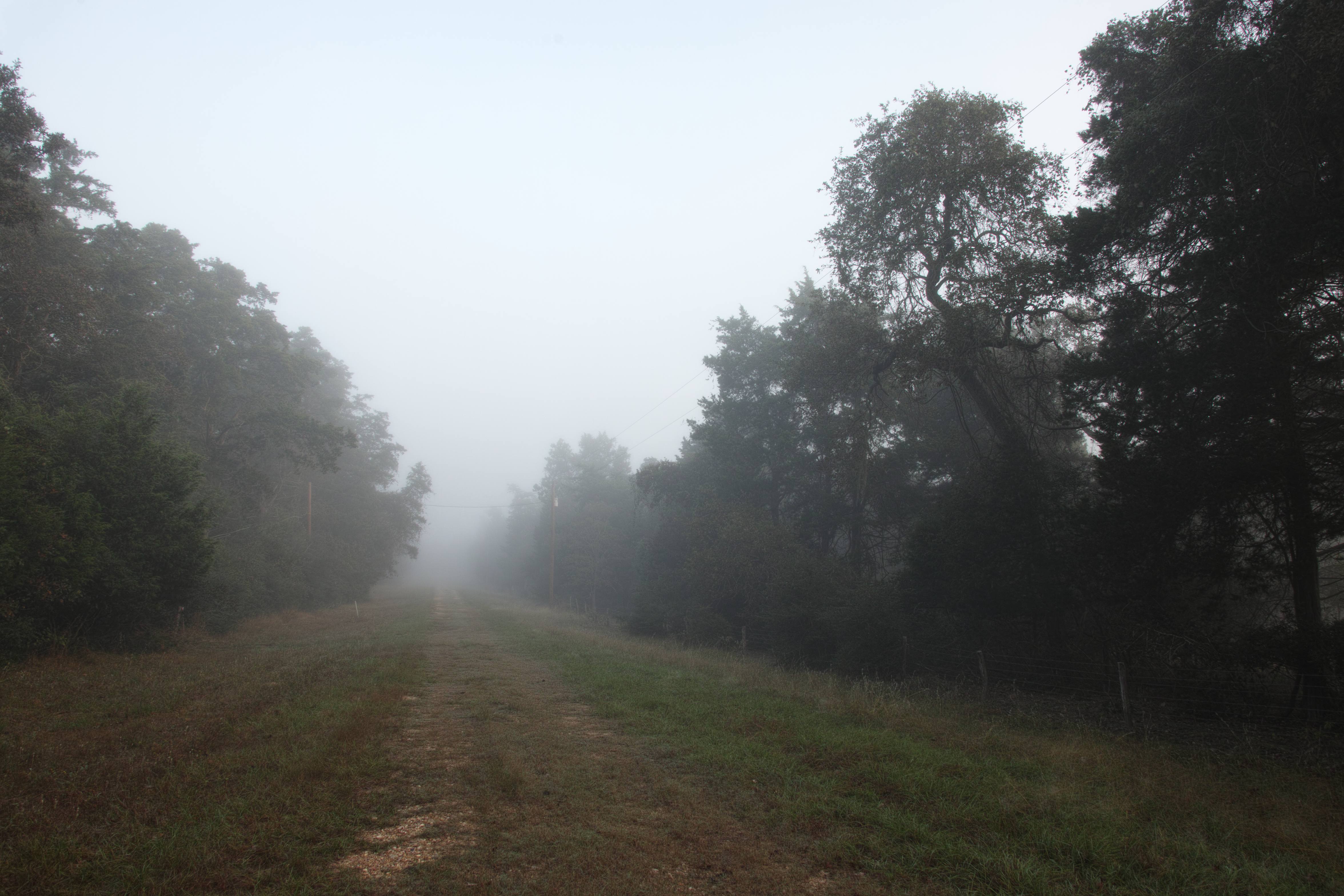

    Any increase in contrast tends to partially cancel the effect of the haze. However, rather than increase the contrast globally, it is usually better to just increase the contrast locally using something like UnSharp Mask. With a very small radius (one pixel or less), USM has the effect of sharpening the image, but with a larger radius (e.g. 10 to 50 pixels), it increases the contrast close to edges, and so provides local contrast enhancement.
    I don't really know, but I presume haze removal tools use AI or something similar to decide where in the image to apply contrast enhancement for the best haze removal.
    An Example: image taken on a foggy day:
    Processed with UnSharp Mask to give local contrast enhancement and sharpening (purely to illustrate the effect, I prefer the original):

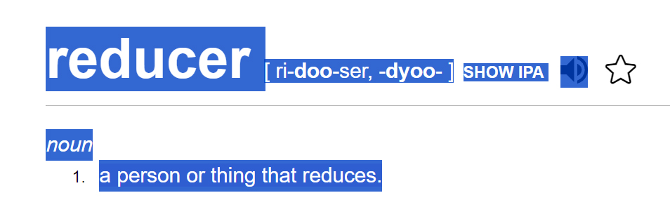

  • Members 197 posts
    Sept. 13, 2023, 10:23 p.m.
    It's a thing 😀 though as photographers we may be more used to think of a reducer in a darkroom scenario
    JPG, 110.3 KB, uploaded by JimStirling on Sept. 13, 2023.
