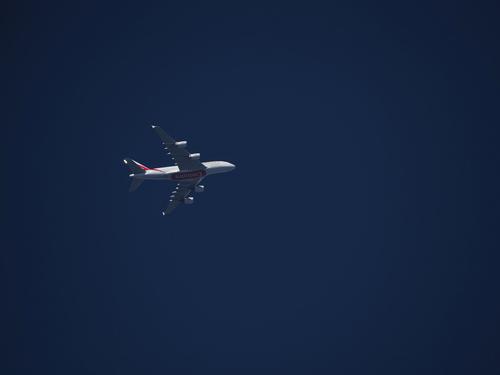

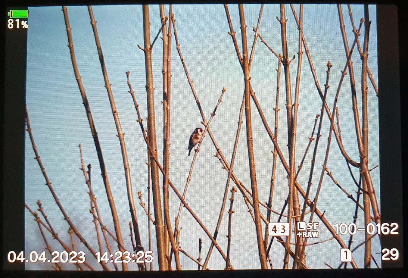

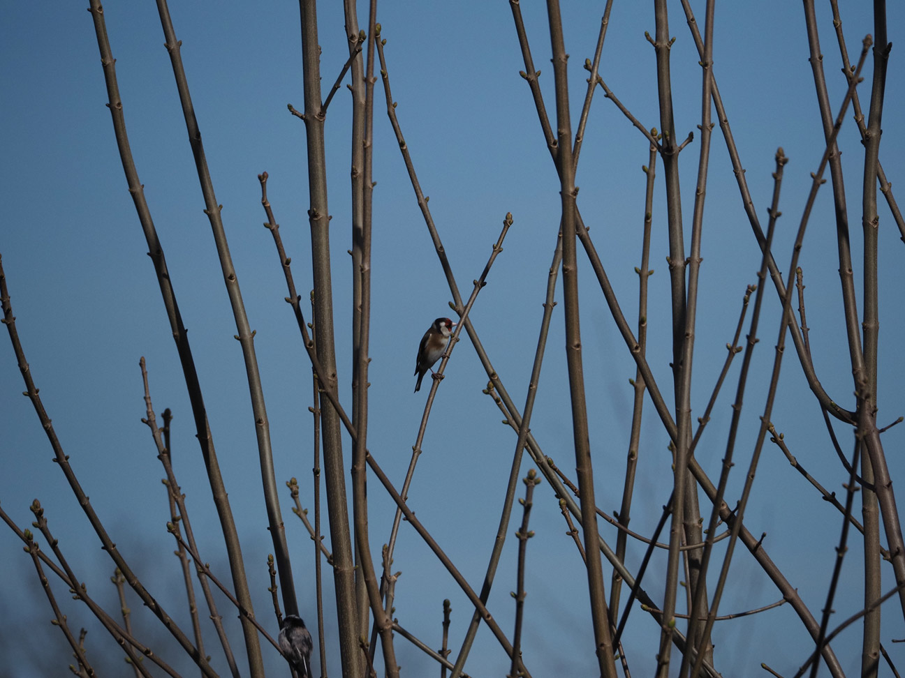

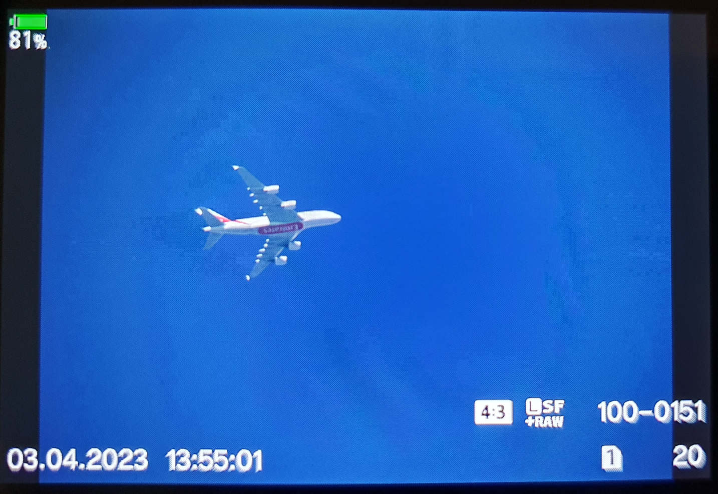

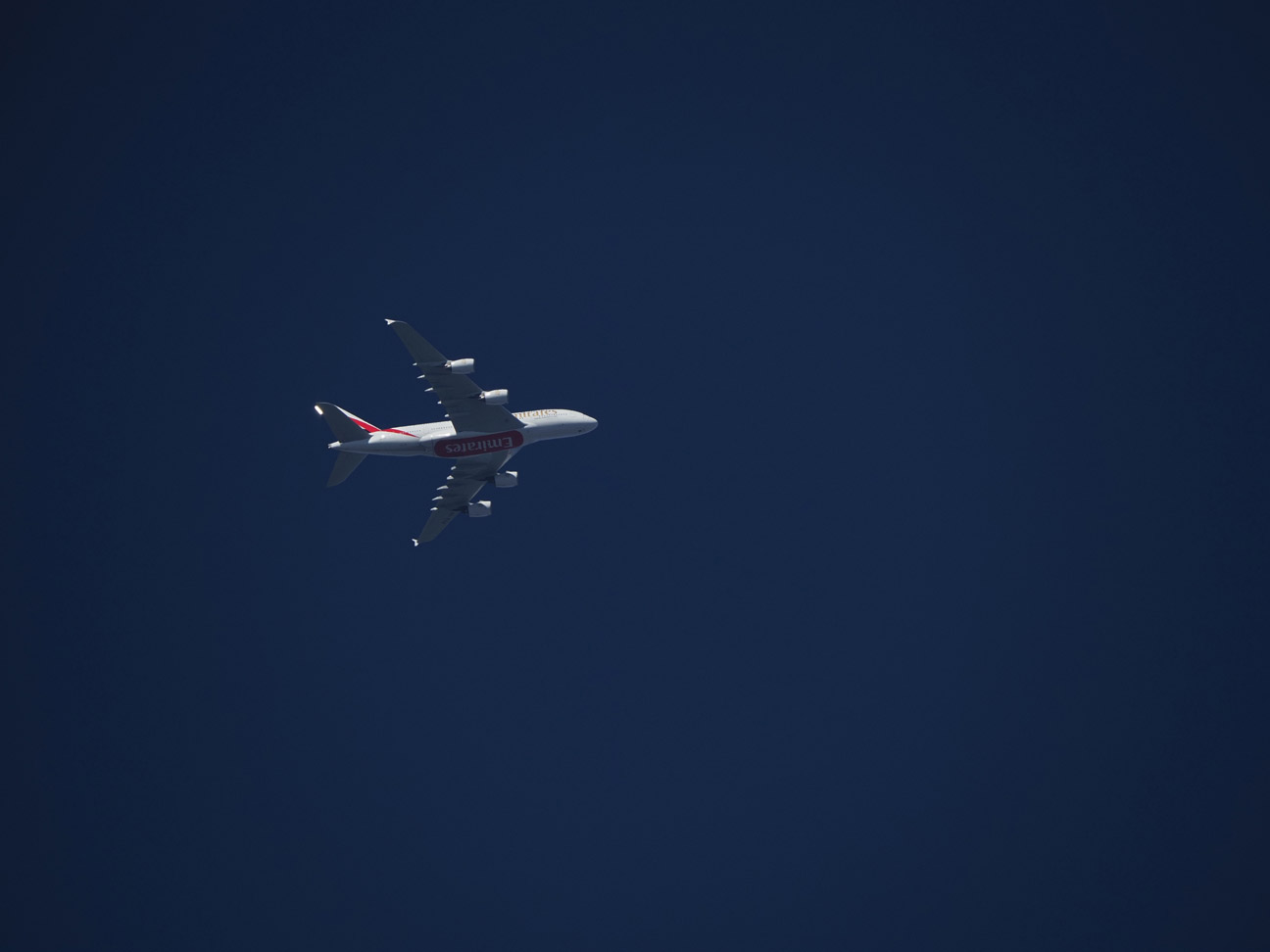

    I've just got a used Olympus OM-D E-M1 II and Panasonic 100-400mm. In testing, I'm finding a confusing problem.
    Through the evf the exposure looks correct. The final picture, when checked on camera looks correct. However, when I download the files to PC they look very much underexposed, both the 'super fine' jpeg and the raw. I've attached 2 example photos below. No editing apart from a resize. I used my phone to take an image of the back of the camera showing what I thought I'd taken (colours slightly off but exposure as seen), followed by the image I ended up with when transferred to PC.
    I'm on full manual and using the -+ bar to get my exposure. I have not altered the brightness of the screen or evf. Am I missing something?
    JPG, 71.8 KB, uploaded by Ambe on April 5, 2023.
    JPG, 921.2 KB, uploaded by Ambe on April 5, 2023.
    JPG, 289.1 KB, uploaded by Ambe on April 5, 2023.
    JPG, 461.2 KB, uploaded by Ambe on April 5, 2023.
