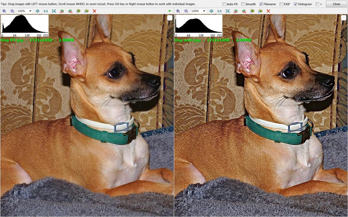

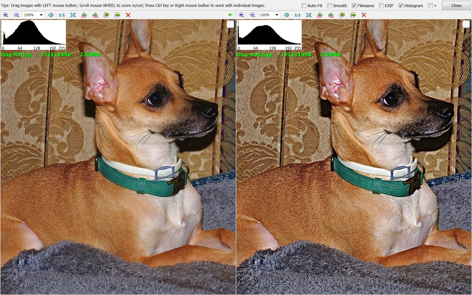

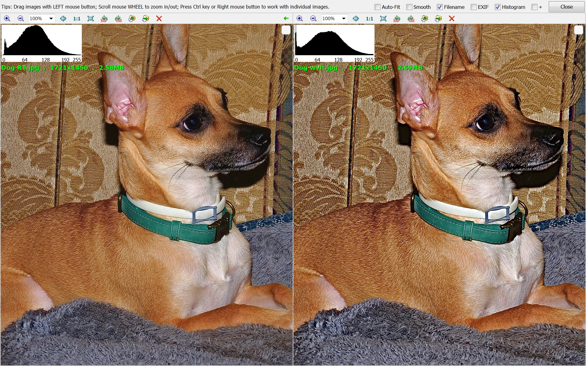

    By way of experiment to account for viewing distance, here's a dog shot;sharpened at left for normal screen viewing at about 40cm and then with local contrast about 8px increased for more distant viewing. 1920x1200px screen in my system,
    View about 15" wide on your system at about a foot ... nice and sharp at left, a bit OTT at right. Now scoot back a yard or two ... with my myopic vision the dog at left blurs a bit but the dog at right remains sharp because of the greater local contrast.
    Your experience may vary but, for me, the "sharpening" for these prints would benefit from a larger radius than normal and perhaps a greater amount

    As for you samples I think that they are quite lo-res images for screen (look at the strands on the mat) and over sharpening to compensate is not going to be representative of an MF image for print. I find the one on the left looks better at all distances as it "holds the impression of finer detail" and at least a semblance of the different textures of the different materials. The one on the right reduces the appearance of everything to the same "SQF", even from across the room the one on the left has far more natural looking fur...

    On my 49" 4K screen (I also have larger ones), the image on the left is more pleasant, seen up to 3m away. Properly scaled to 3840x2160 resolution and slightly "enhanced" with other clarity-enhancing formulas, the one on the left looks better, more natural, from greater distances anyway.
    I can print images up to 12"x20" on canvas paper, the images do not need to be processed differently than those that are going to be printed on normal paper.

    Thanks for trying it out with a different monitor, viewing distances and processing. Your experience certainly differed from mine and I'm thinking of figuring out a number for my monitor and looking at the dog again ...
