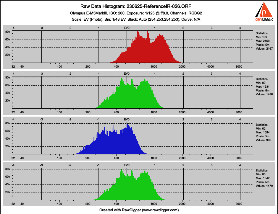

    So, if the said foliage is emitting lots of true IR and with, say, the much-loved Hoya 720nm on the lens, then we would expect a highly-captured-but-not-blown red channel compared to the much lower capture with other two. I imagine that attempting to "balance" foliage to look white may not always be easy
  • Members 118 posts
    Aug. 22, 2023, 7:40 p.m.
    Pretty much. Here's a processed image and a RawDigger histogram from the original raw file:
