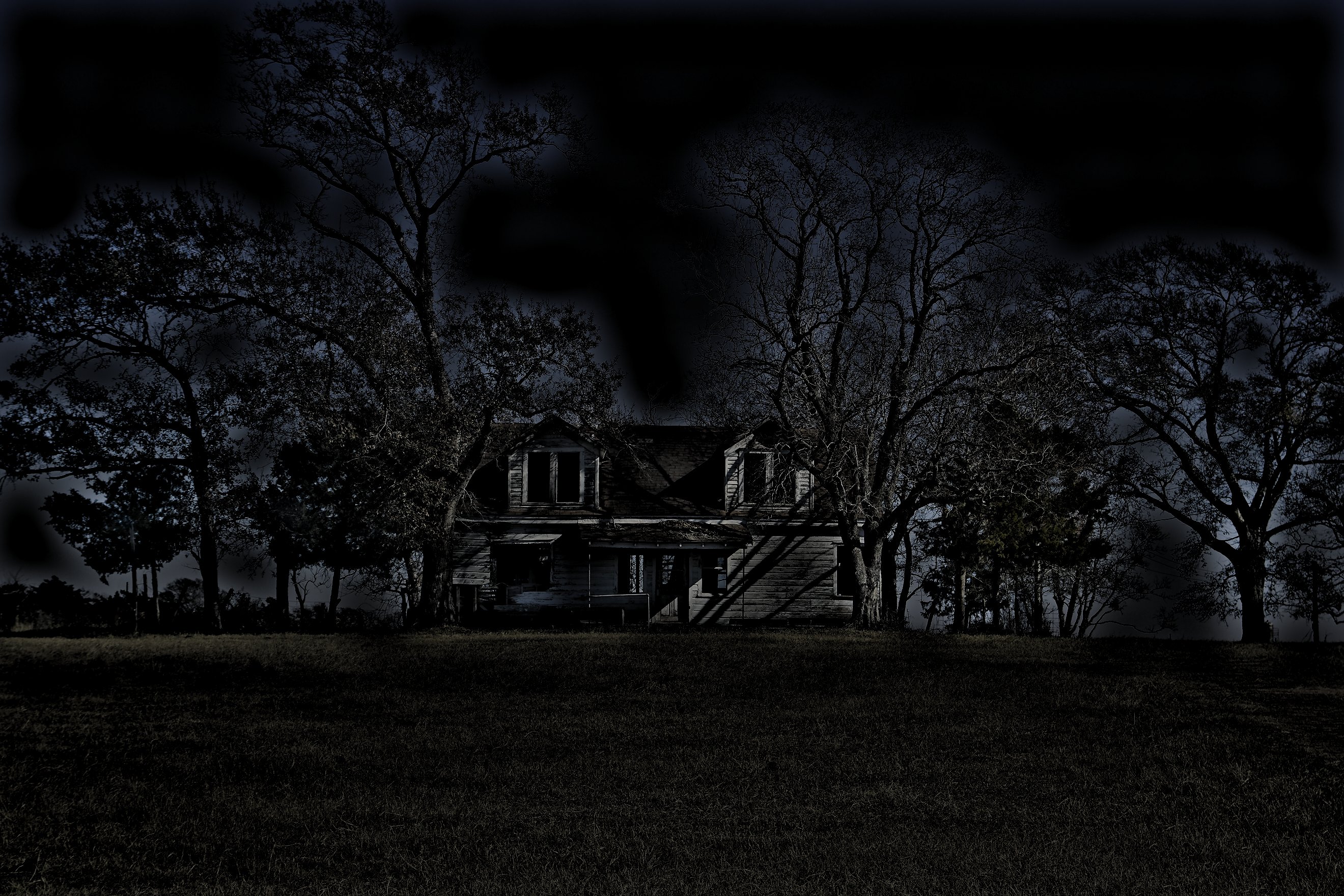

    I've been trying to understand Fourier transforms - not easy for an 83-yr old geezer!
    But today I deleted low frequencies from an FFT plot and was quite surprised at the result ...

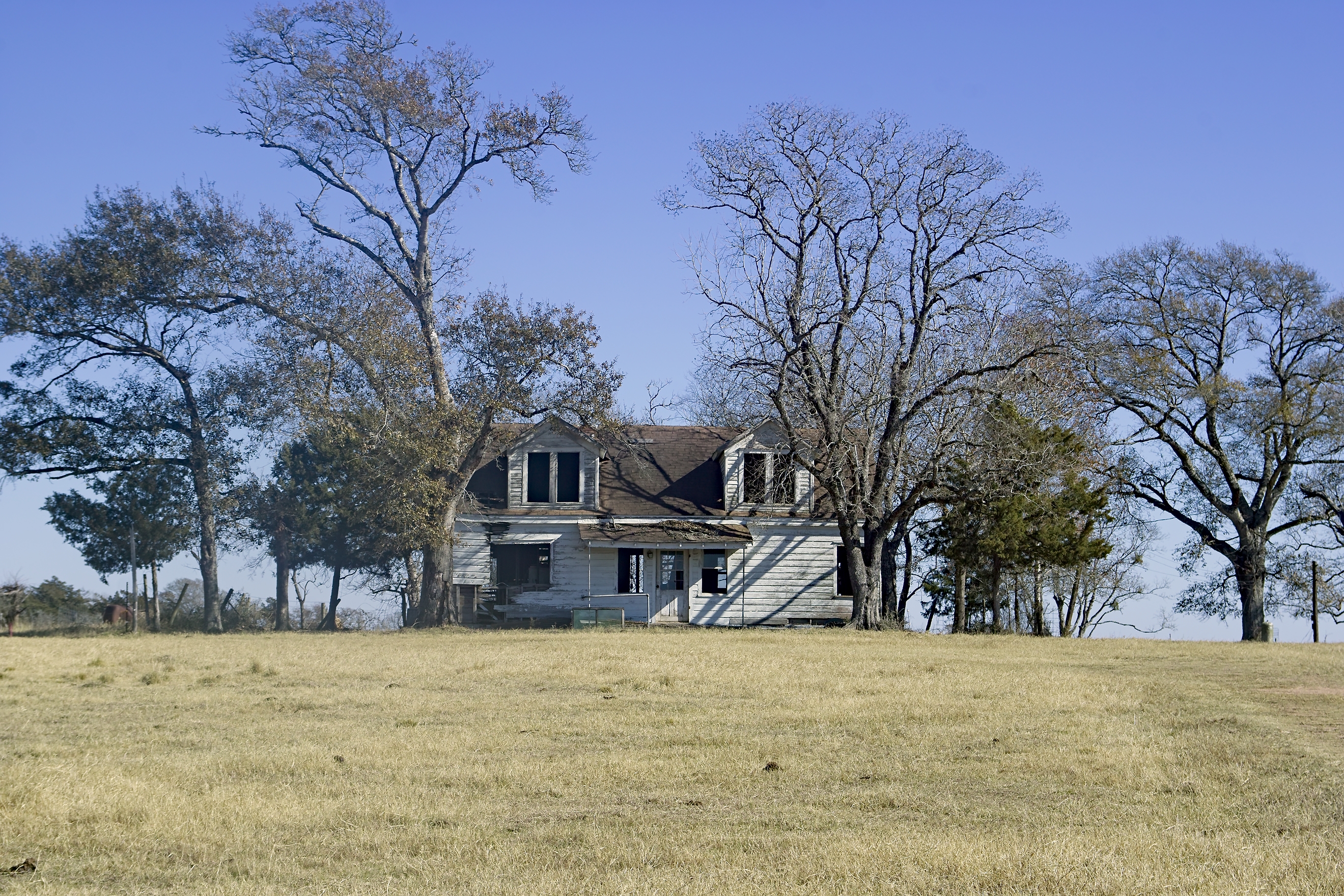

    The Victim:
    The result:
    Kind of like wavelet processing but where frequency is the inverse of detail size ...

    In the FFT plot, I deleted a small circle in the middle and then inverse FFT'd back to a 2D image.

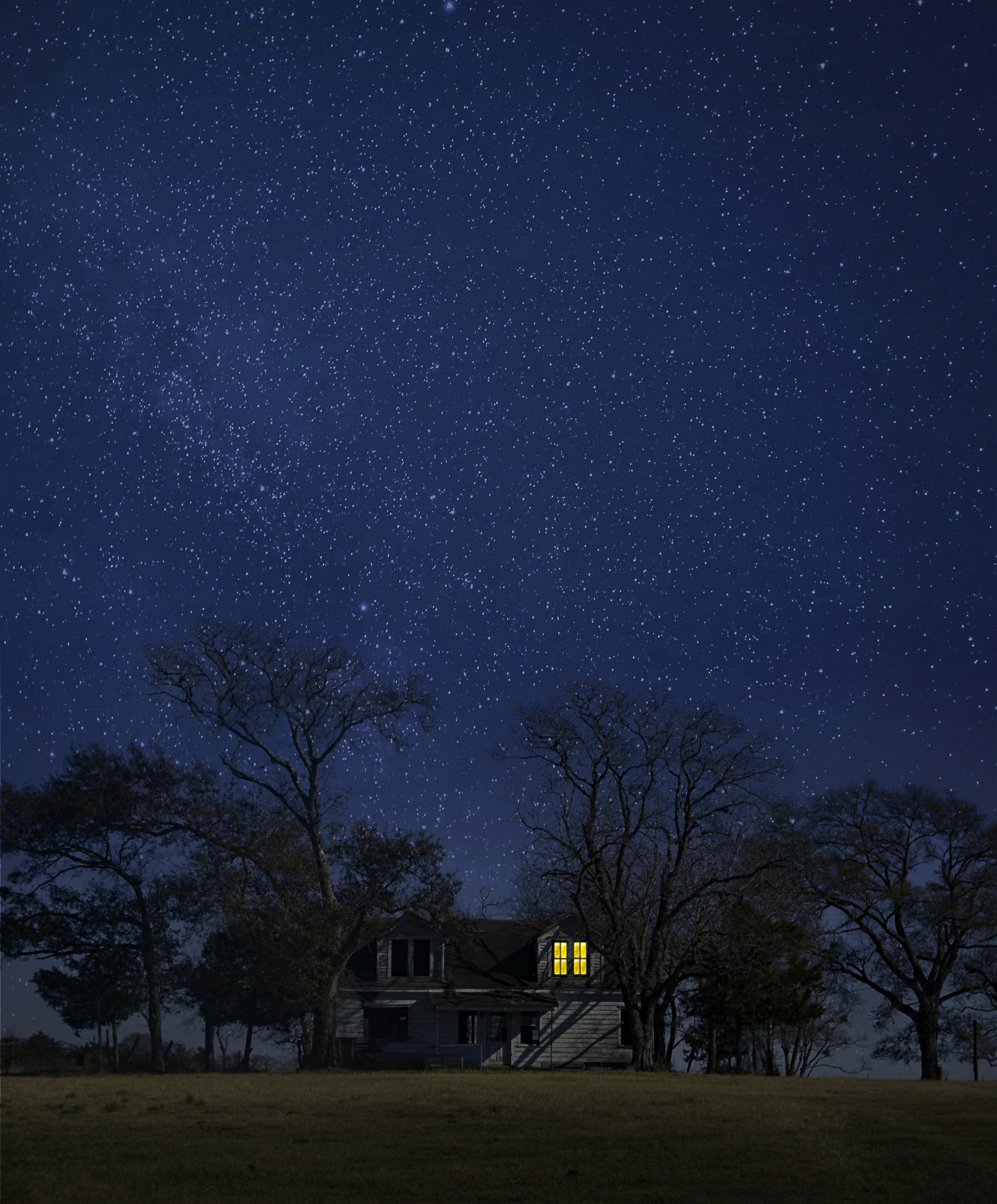

    It depends a little on each specific photo, but achieving a more or less credible effect is usually a laborious process.This is my try...

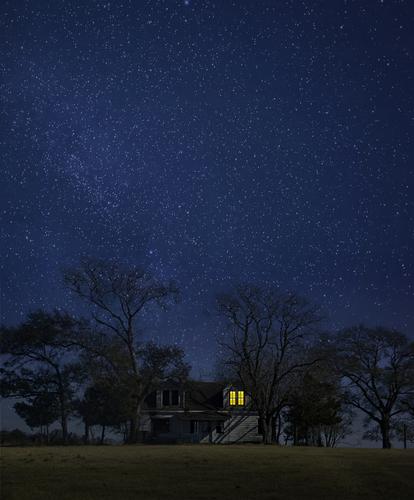

    JPG, 2.2 MB, uploaded by doctor on Dec. 13, 2023.

    They are related, Fourier transform is equivalent to very special case of wavelet processing. Wavelet transforms decompose image into frequency+time components, Fourier transform only into frequency components. Both transforms are reversible.
    About getting your night scene using fourier transform.
    If you remove low frequencies, then you start from zero frequency, which corresponds to average value of your signal (image) - average of sky and field; removing it makes average value zero (shifts all values). Then removing next low fequency component (we are talking about discrete FT here - in continous case there is continous spectrum of frequencies) approximately removes differences between halves of your image (in every direction) - making sky and field same brightness (if you process colors seprately, then same color too). Then removing next low frequency component (again approximately) removes difference between image center and border areas and so on.
    You could get similar effect using high-pass filter with very steep transmission curve.

    Agreed. The posted image was an accident while playing with FFT, so wasn't actually trying to create a realistic night scene.

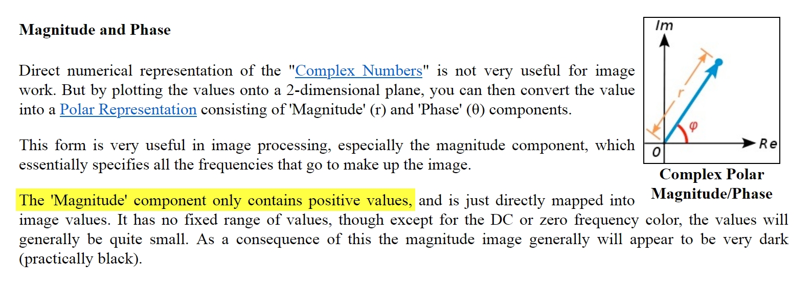

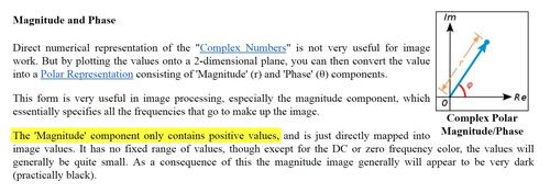

    Dec. 16, 2023, 8:02 a.m.
    What?
    What?! There are no negative values to truncate!
    Please define "a proper rendering" ...
