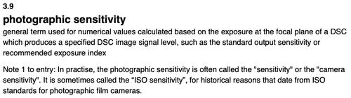

    This is how ISO defines the photographic sensitivity:
    I don't see any mention of noise in this definition.
    PNG, 74.0 KB, uploaded by TomAxford on June 7, 2023.

    Clearly not. The history of 'sensitivity' in a photographic context is convoluted.
    In a general context, 'sensitivity' refers to the size of stimulus necessary to cause a reaction, not the size of that reaction. The smaller a stimulus is necessary the higher the sensitivity. That applies both in general parlance and scientific/engineering usage. In that sense the ISO control does not usually change sensitivity of the sensor (if the sensor has dual conversion gain, it does, but not in proportion to the ISO). At some stage it crept into photographic usage to denote the size of reaction rather than the size of stimulus which went with the idea that 'gain' or 'amplification' changes 'sensitivity'. Generally it doesn't. Applying gain after a transducer does not change the sensitivity of the transducer. I suspect that the misunderstanding is due to radio hams, who are used to an RF gain control increasing the sensitivity of their receiver, but this is due to the specific behaviour of a diode detector - putting gain before the detector does change the minimum signal it can detect. In a sensor we are not putting the gain before the detector.
    Anyhow, when digital cameras started to provide the ability to change the ISO, it was described (wrongly) as a 'sensitivity' control due mainly, I suspect, to this bogus RF receiver analogy. CIPA has been promoting this 'sensitivity' description for a long while, whilst ISO has been resistant, even though it adopted CIPA's two novel 'ISO' definitions in 2006. In the 2019 update of the standard it fudged the whole issue by adopting a term 'photographic sensitivity', which essentially says 'Photographic sensitivity is a term for ISO and for historical reasons sometimes it's just called sensitivity'.

    I was talking about the English word "sensitivity"; not the ISO committee's definition. Even by the common English understandings of the word, doubling ISO does not double sensitivity.

    At the focal plane implies below the stack, the microlenses, and the CFA. That doesn't seem right.

    Worse, it's actually the image plane. The focal plane is out there in front of the camera. I think it's a translation issue, where what was meant was 'plane of focus' and what came out was 'focal plane'. It's a consistent error in the ISO photography standards, so maybe it's not now an error.
