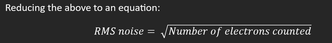

    You are correct. the radical got lost in translation. I've notified Lensrentals.
    Thanks.
    PNG, 14.2 KB, uploaded by JimKasson on May 4, 2023.

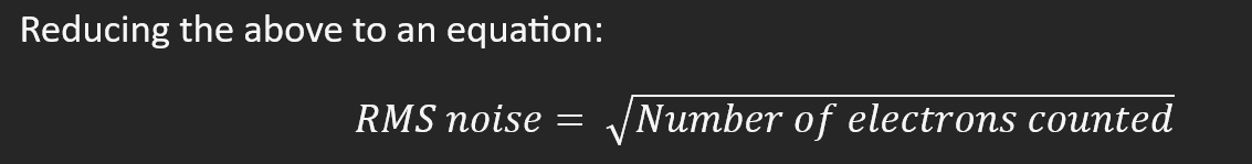

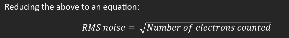

    The Lensrentals folks left out the radical. Here's what it is supposed to look like:
    I've notified them and hopefully they'll fix it soon.
