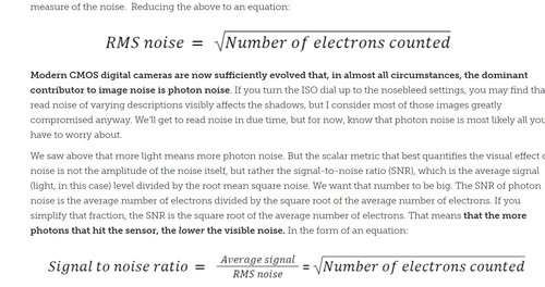

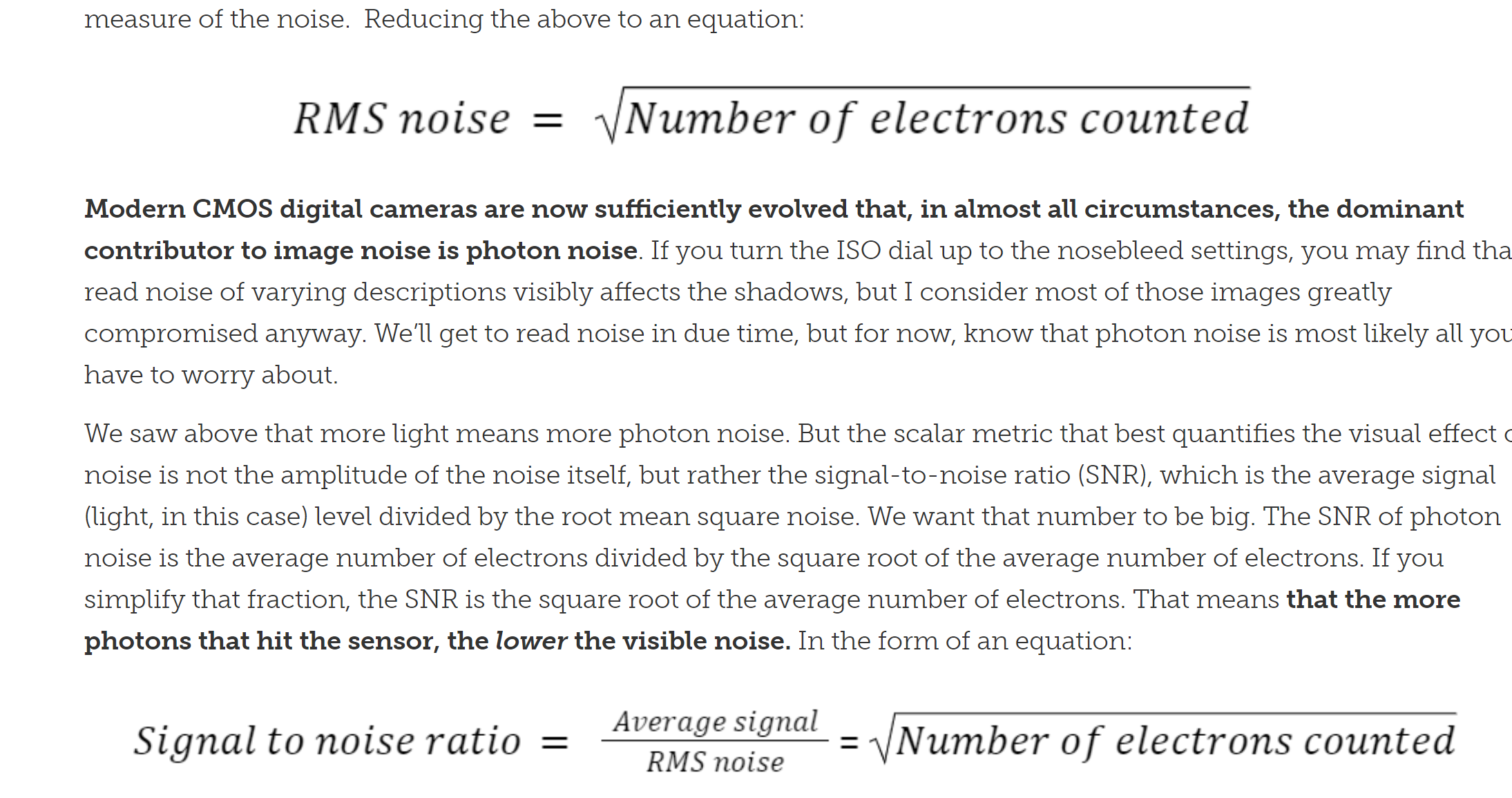

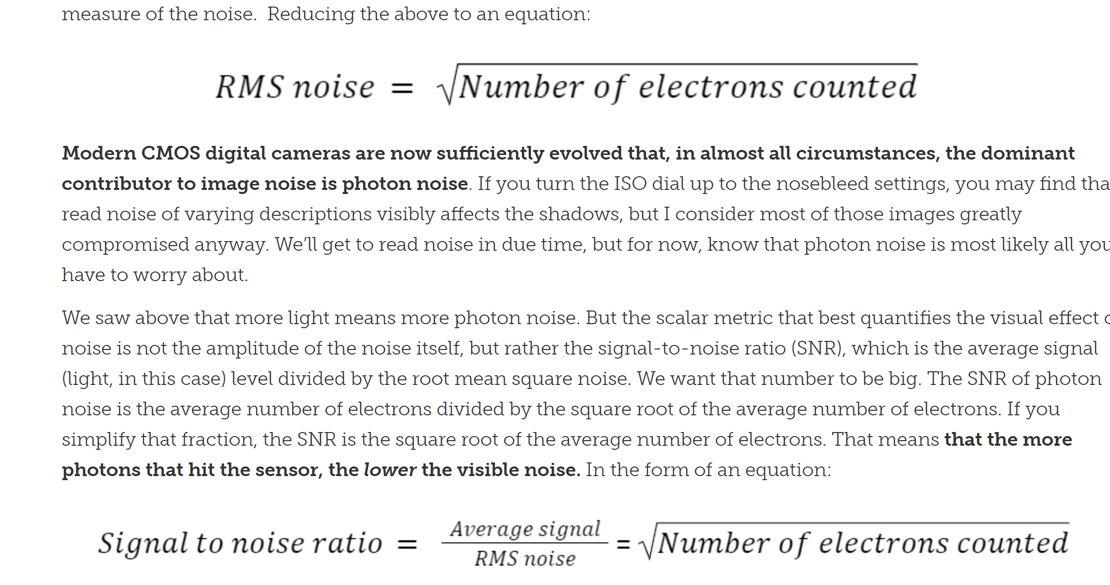

  • Members 1738 posts
    May 5, 2023, 7:03 p.m.
    Both equations are fixed now.
    PNG, 356.3 KB, uploaded by JimKasson on May 5, 2023.
