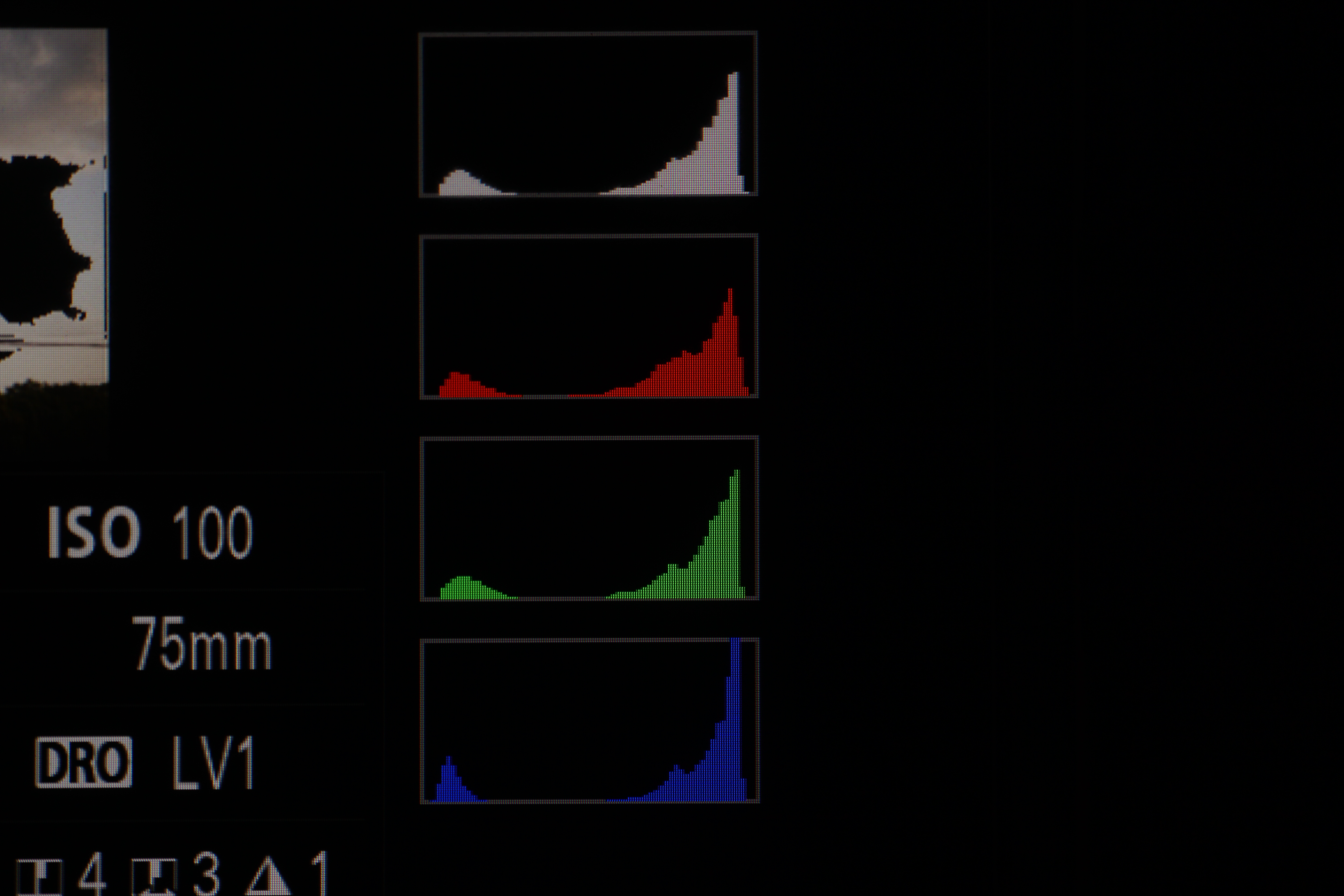

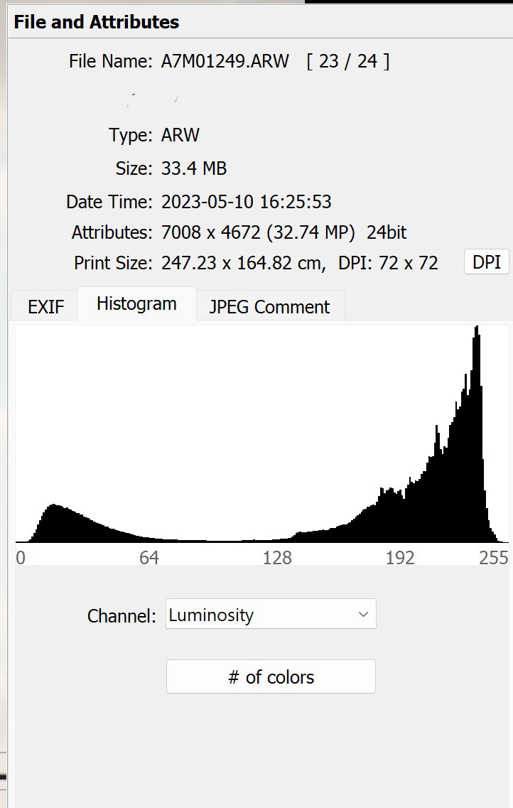

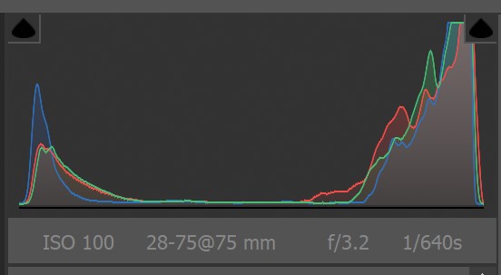

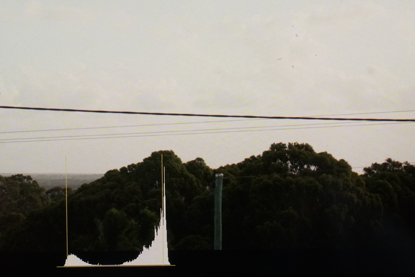

  • Members 2657 posts
    May 10, 2023, 7:30 a.m.

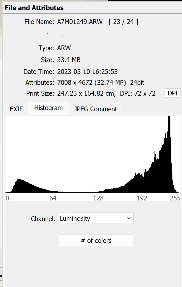

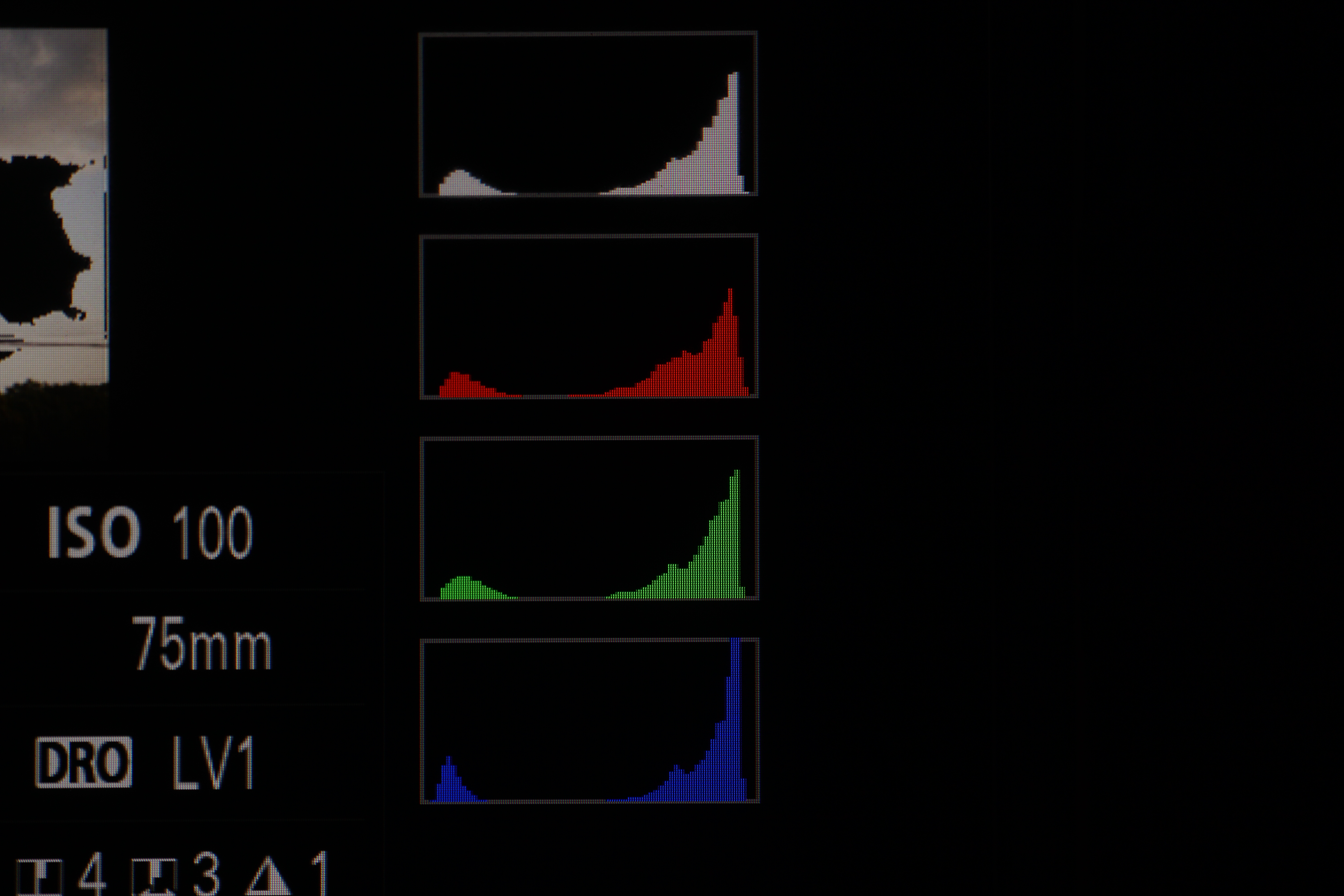

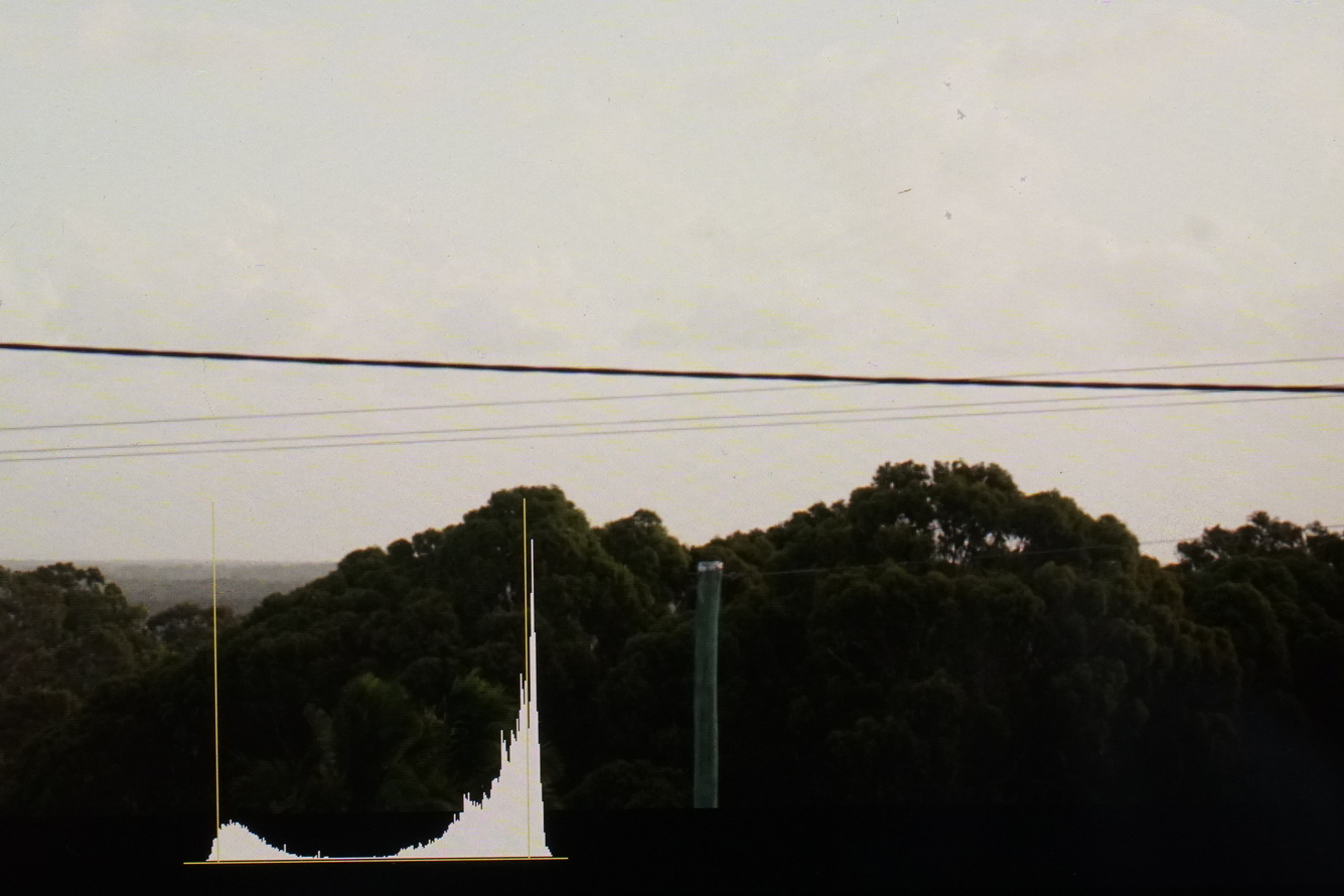

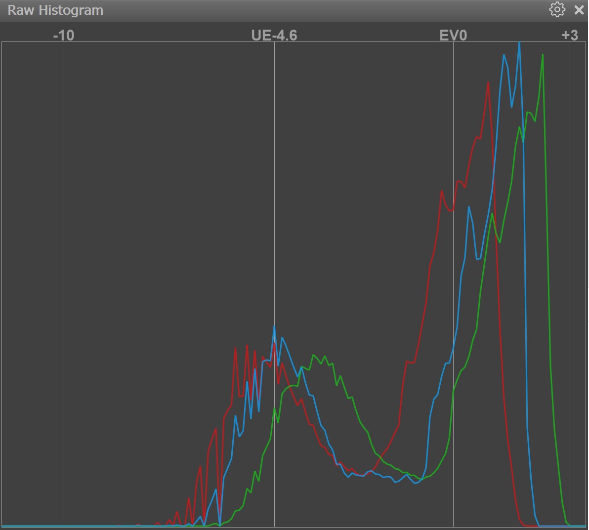

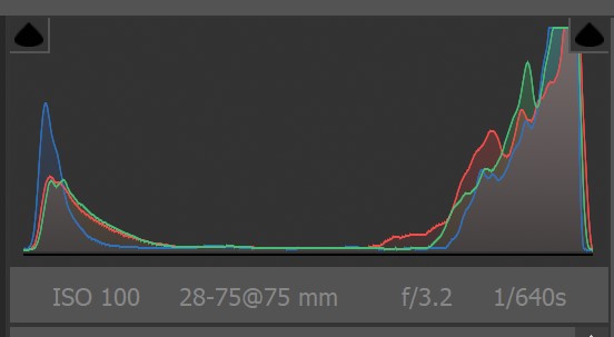

    Sony a74
    Not accurate !
    my zebras had a tiny black dots flashing.
    Fast raw histogram
    camera histogram
    ACR
    [Screenshot 2023-05-10 170310.jpg]
    (/a/tlLHm6J8lsER3dMtWH8Gqkrg0gBryY7XRjF6QE8AQ8UATJdr1q1tzWDFDN8kM6eS/7531/?shva=1)
    faststone
    field monitor, the black dots are the zebras
    JPG, 264.2 KB, uploaded by DonaldB on May 10, 2023.
    JPG, 145.9 KB, uploaded by DonaldB on May 10, 2023.
    JPG, 18.0 KB, uploaded by DonaldB on May 10, 2023.
    JPG, 84.2 KB, uploaded by DonaldB on May 10, 2023.
    JPG, 3.2 MB, uploaded by DonaldB on May 10, 2023.
  • Members 976 posts
    May 10, 2023, 1:55 p.m.
    Post the raw file. Post FastRawViewer statistics screenshot. It's possible that your zebras are not accurate.
