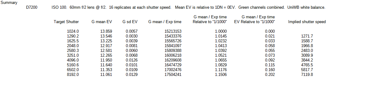

    This is what I get on D7200:
    Bill Claff suggests an "FWC" of about 36k e- for D7200. So at "1/1000" shutter speed, I should have about 32k e-.
    I'm doing something daft, or something odd is happening. Either the RAW data is quite non-linear, or the shutter speed steps - in EV - get smaller at higher shutter speeds. In particular, this data makes 1/8192 appear more like 1/7100. Which you don't seem to be getting with D850 in your setup. If there was some nonlinearity near "FWC", I might expect the picture to change if I re-based the test at 1/2048, but it doesn't change much.
    I haven't tried directly measuring D7200 shutter speeds yet.
    FWIW, I slotted a diffuser into my LED panel, and pointed the lens directly at that. The hood was in contact with the diffuser.

  • Members 1738 posts
    June 21, 2023, 2:29 p.m.
    Mechanical shutter? Could be because the shutter is not in the same plane as the sensor, even if the slit widths are right.

  • Members 128 posts
    June 21, 2023, 7:16 p.m.
    Shutter not in the same plane as the sensor??? How can that happen??? 😀
    Yes, it's mechanical shutter - D7200 only has mechanical shutter for stills.
    In this case, like Bernard, I'm sampling a small square area at the centre of the sensor. I'm sampling 512x512 pixels or about 2mm x 2mm.
    The exit pupil is about 73mm from the image plane. Na ~= 1/4. Slit width ~= 0.9mm at "1/8000" and full travel speed (~7m/s).
    Do you have an estimate for the separation between the first and second curtains (in a direction normal to the sensor) ?
    If the curtains were travelling at constant speed, I think I'd expect the overexposure on one side of the slit to roughly compensate the underesposure on the other.
    More head-scratching required.
    June 21, 2023, 7:18 p.m.
    A mechanical focal plane shutter has to be above the sensor stack. That means that the light that falls on the sensor can be wider than the slit width of the shutter.
