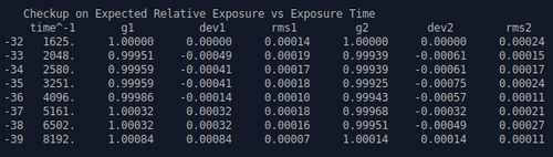

  • Members 1738 posts
    June 23, 2023, 4:14 p.m.
    PNG, 357.8 KB, uploaded by JimKasson on June 23, 2023.

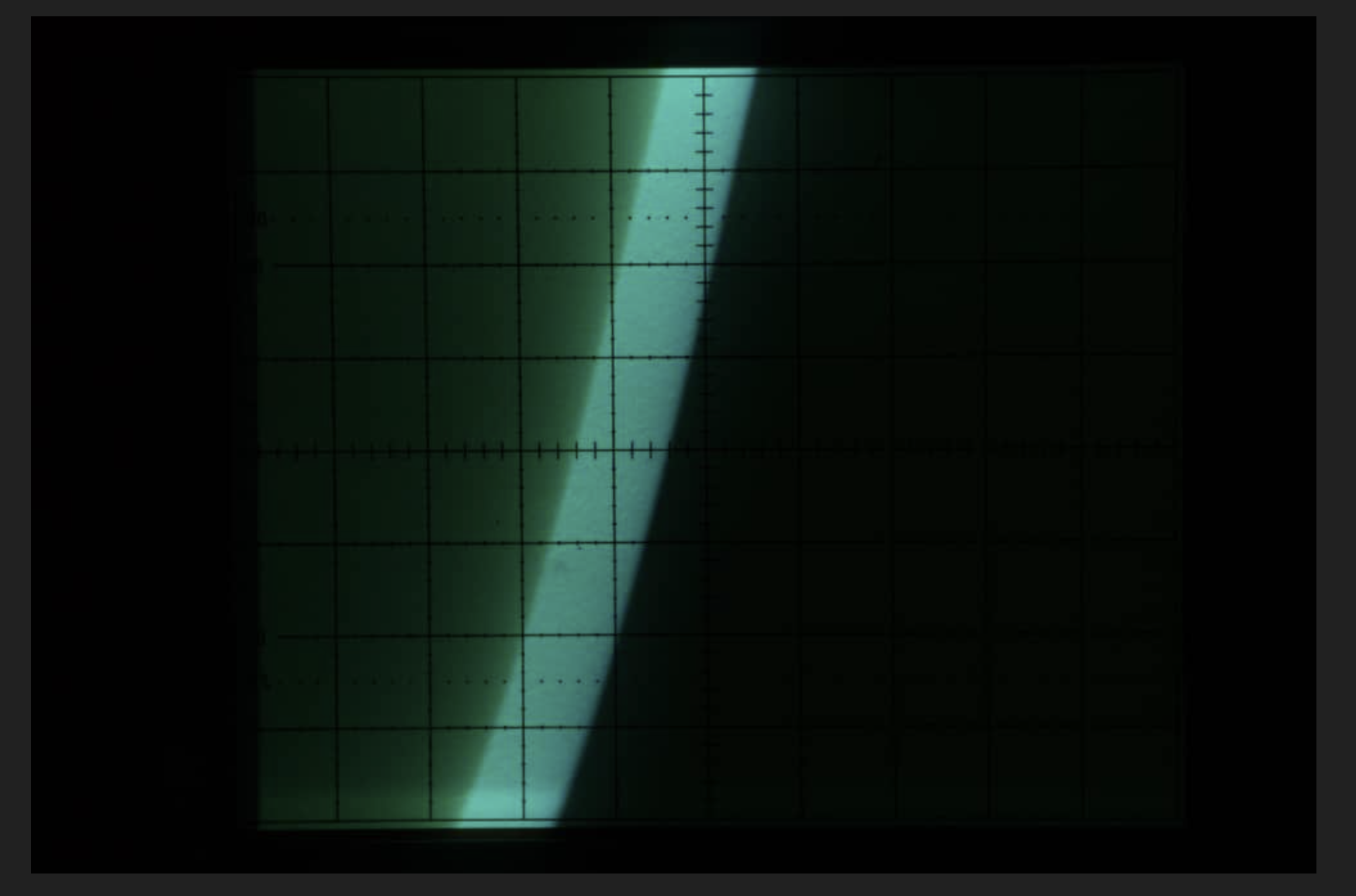

    Yes, that appears to be normal. See e.g.: dprevived.com/t/new-ways-with-shutter-travel-time-measurement/3402/
    There the shutter accelerates from about 5m/s at the start of exposure to about 10m/s in the centre of the frame, and remains at about 10m/s until the end of the frame.
    I have similar examples from other cameras.
    If the acceleration profiles of the first and second curtains can be sufficiently accurately matched, the exposure time is basically the delay between triggering the first curtain, and triggering the second curtain.
    At 1/8000.0 s, and 10m/s shutter, the gap between the first and second curtains is 1.25mm.
    At 5m/s, the gap between the first and second curtains is 0.625mm.
    That's with a premium, fast-moving FF shutter that allows 1/320 X-Sync. (Similar performance to D850 shutter).
    I haven't tried precise modelling, but I don't think EFCS-style bokeh truncation problems are possible at realistic f/numbers. Exposure uniformity is an issue, though - the exposure time varies across the frame at high shutter speeds.

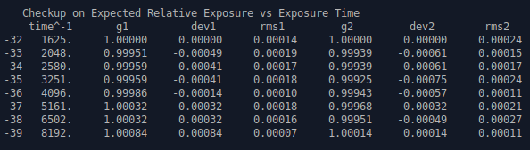

    If you have 22000 e- per green pixel, the pixel standard deviation is about sqrt(22000) ~= 148 e-
    If we then average these 10000 green pixels, the standard deviation of the average (attributable to shot noise) will be about 148/sqrt(10000) ~= 1.48 e-
    The ratio of the standard deviation (attributable to shot noise) to the mean is about 1.48 / 22000 = 0.000067 (about 0.0001 EV).
    Which is somewhat below the "rms" shot-to-shot noise that you are seeing (except maybe at high shutter speeds).
    Getting the variation in the standard deviation of the replicates down to a level where we can reason about the standard deviations of different treatments needs quite a few replicates: The 𝜒2 confidence intervals for the population standard deviation start out very wide.
    Try: www.statskingdom.com/confidence-interval-calculator.html with 'type:' "Standard deviation confidence interval" and 'Data is:' "SD, n".
    This is why I usually end up doing 8 or 16 replicates of each test condition. (And why I use an intervalometer a lot in these tests).
    With 4 replicates, a 90% confidence interval for the population standard deviation is [0.62s, 2.92s].
    With 8 replicates, a 90% confidence interval for the population standard deviation is [0.71s, 1.80s].
    With 16 replicates, a 90% confidence interval for the population standard deviation is [0.77s, 1.44s].
    - Where s is the sample estimate of the population standard deviation.
    (This being the internet, for all I know, you could be a professor of statistics. If I'm teaching you to suck eggs, I apologise.)
    Yeah.
    Edited: I misunderstood the number of pixels in the patches Bernard is using - I thought they were 25000 pixels, but it seems they are 10000 pixels.
    Edited: Hurried to fix the above, and made another silly error.

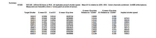

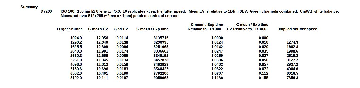

  • Members 128 posts
    June 28, 2023, 11:28 a.m.
    Can you be more explicit? Do you mean statistical significance?
    The differences I get are quite large compared to the standard deviation of the replicates. The replicate standard deviation estimate is the "G sd EV" column. We can expect the mean EVs for each case to be distributed with sd roughly a quarter of the corresponding "G sd EV" value.
    With 16 replicates per treatment, a 90% confidence interval for the treatment mean is: (sample mean) +/- 0.44*(replicate standard deviation).
    Stopping down the 15-150 to f/5.6, compared to using the 60mm f/2 wide open adds about 0.01EV noise. (I don't have a manual-only lens that I can use on F-mount).
    The D7200 tests I did went down to 11EV (above 1DN). At 11EV, the variation in the replicate means attributable to Poisson noise is in the 8E-5 EV ballpark. So negligible. I could/should use more of the available dynamic range.
    I mentioned black level errors before. If I have a 0.5DN black level error at 11EV, that's a 0.00035EV error; if I have a 0.5DN black level error at 6EV, that's a 0.01EV error in a measurement near 6EV. That's at the level of effects I'm trying to detect. I could try gettting more fancy with the statistics, but they would be less robust.
