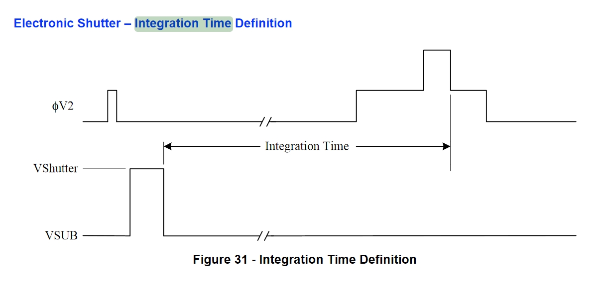

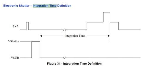

    Now looking for a definitive Kodak description because of the same tag number.
    Found this list repeating the above tag.
    Found this note:
    Electronic shutter is not used. Integration time equals frame time
    Found this diagram:
    Ignore the EXIF - FastStone Viewer strikes again 😟
    Both in here, www.kodak.com/global/plugins/acrobat/en/digital/ccd/products/interline/KAI-11000CMLongSpec.pdf
    All I need to know is what is meant by 'frame time' because my camera does not shoot video!
    JPG, 91.2 KB, uploaded by xpatUSA on June 30, 2023.

    Further research today is leading me to believe that IntegrationTime is the period during which the sensor or parts thereof are being iluminated.
    The difference between the smallest IntegationTime 1/66 sec and the sync-speed 1/180 sec remains an anomaly yet to be explained.

    I doubt that it is 1/66 sec "per pixel" and I don't know whether the curtains' travel is somehow synchronized to the sensor's row-by-row line scan. If the shutter is inherited from the SA-9, then such synchronization is most unlikely.
    [edit]Maybe when the sensor is covered after exposure, there is a long read time just as you imply.
    I'm looking at a paper for that sensor, as we speak. [/edit]
