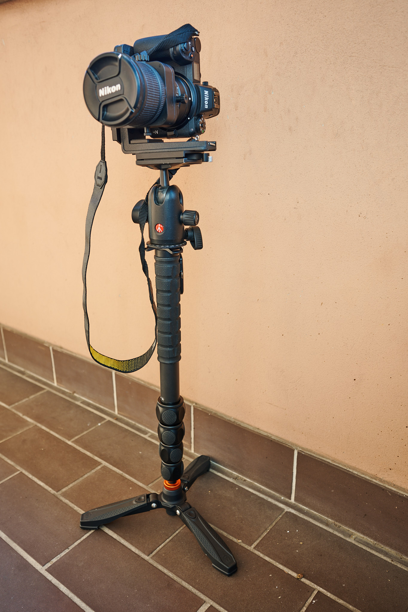

    A little off topic, but it might be interesting to sombody. I do a lot of architectural photography in dark old Italian monuments. Tripods are not often welcome, but my self standing monopod with feet, looks sufficiently amateurish to not cause alarm with custodians, and allow me to get those HDR shots with up to 30 seconds of exposure. In practice I have found the IBIS in my Z7 takes care of any little vibrations that might occur during exposure. I wait a few seconds to let the big vibrations die down, before tripping the shutter with a cable release. I have a carbon fibre monopod to save weight and it is much nicer than carting my heavy Manfrotto around, when I am exploring a cities monuments.
    I get bitingly sharp results, almost up to tripod level, and I can use base ISO to get less noise, also HDR sets are easy and aligned perfectly. BTW some of the Exif data below is wrong for the HDR sets.
    Here is my Z7 with a Three Legged thing monopod + Nikon 24mm PC. The angle bracket is essential to keep the centre of gravity of the camera/lens, within the area traced by the feet ( otherwise the whole lot will fall over!) .
