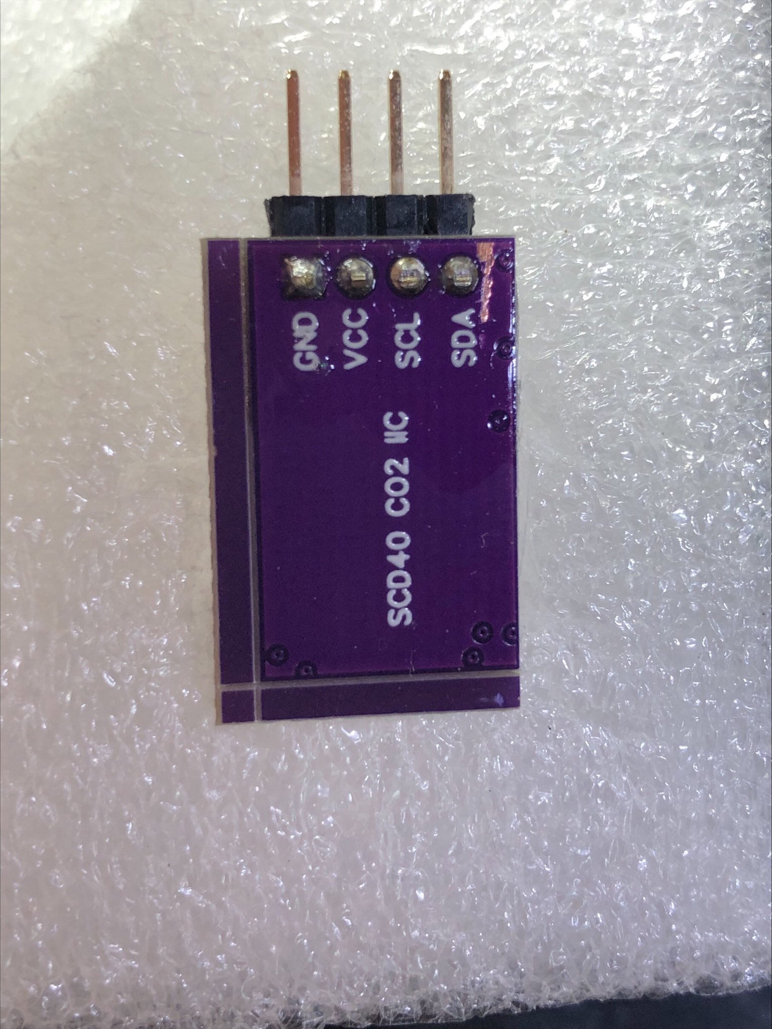

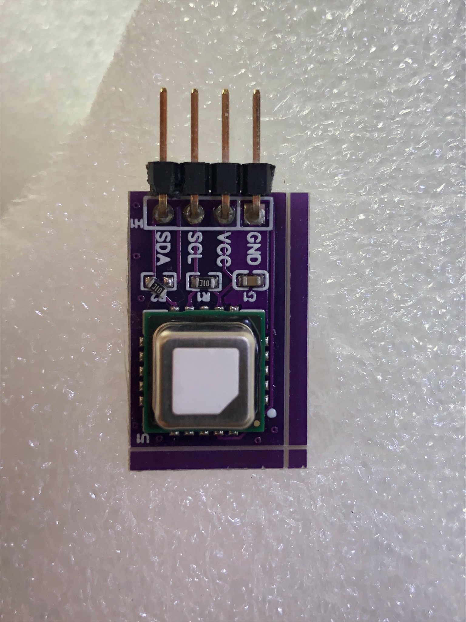

    Generally I'm very happy with goods sold through AliExpress. But sometimes they need rework. This is the SCD40 module (SCD4x are Sensirion CO2 sensors) I just received.

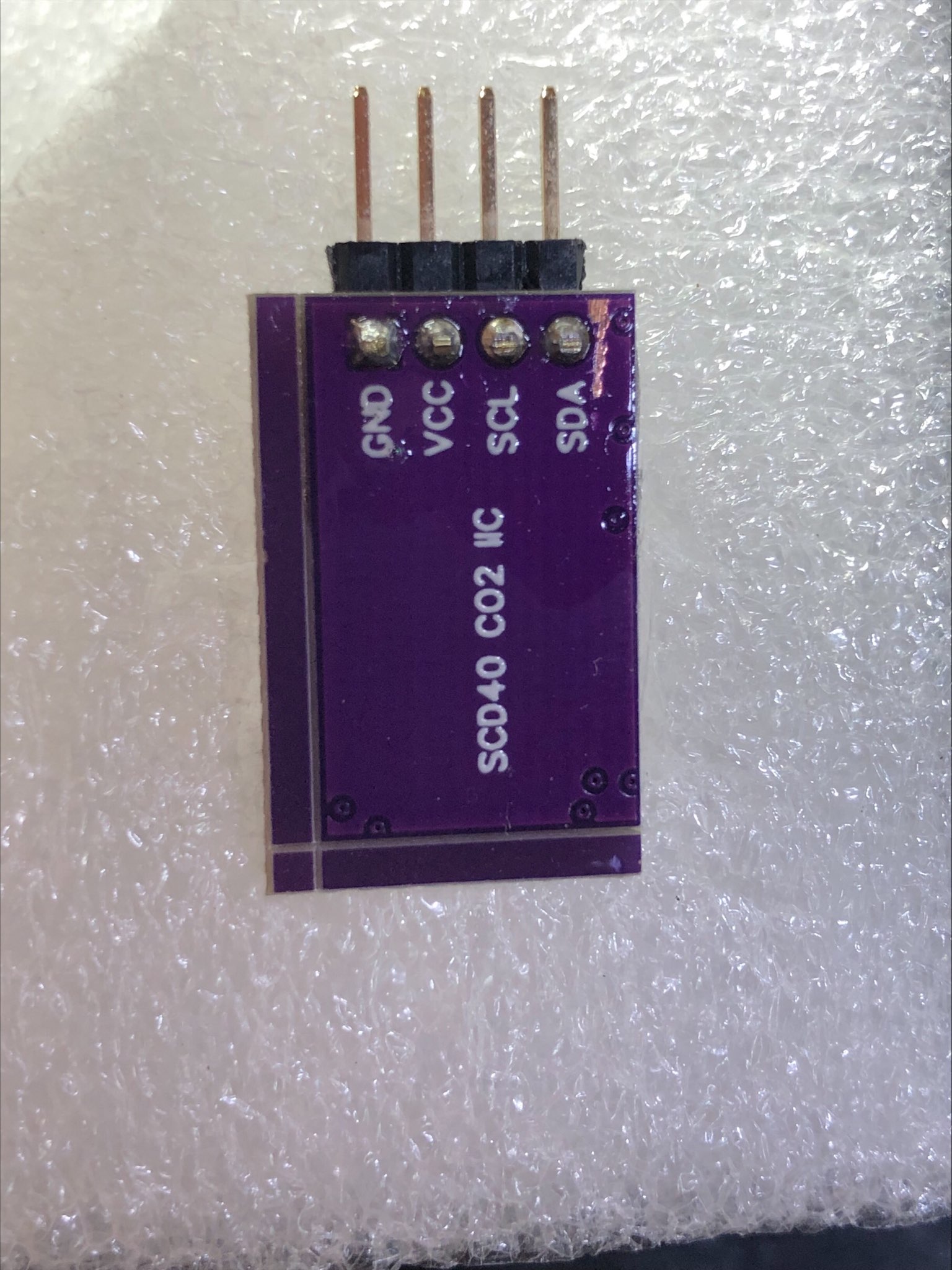

    Bottom side, conformal coating, Kapton tape, or something else needs to be applied:

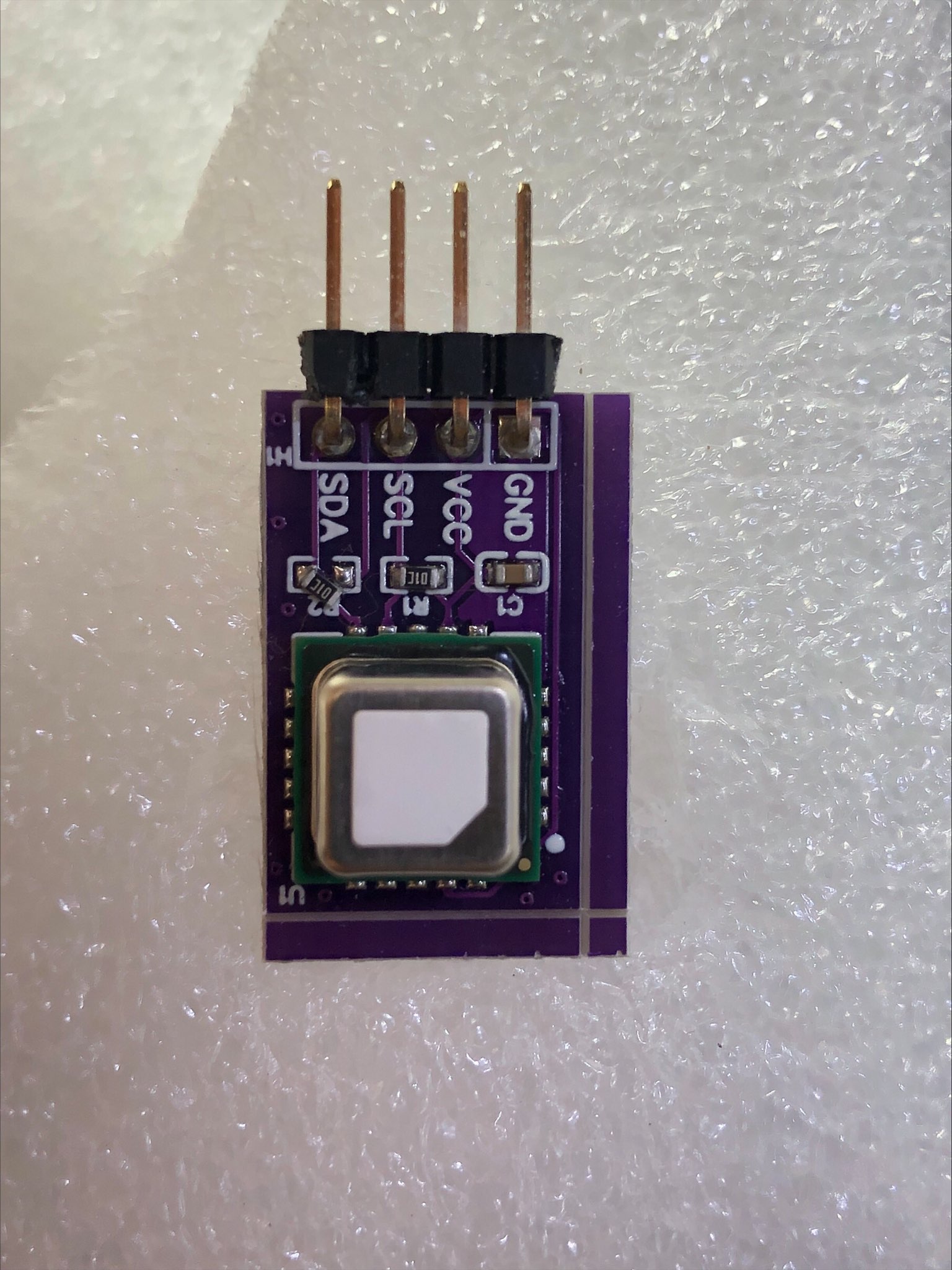

    Top side, resistor needs rework:
    Not a big deal, but this sensor can be easily poisoned by fumes.

    Don’t use any conformal coating, I know that there is a Low VOC type, but I've never used it.
    and if it’s that super sensitive you better mask it off somehow before soldering.

    All done already, testing the sensor side by side with 2 others from a different batch ;)
