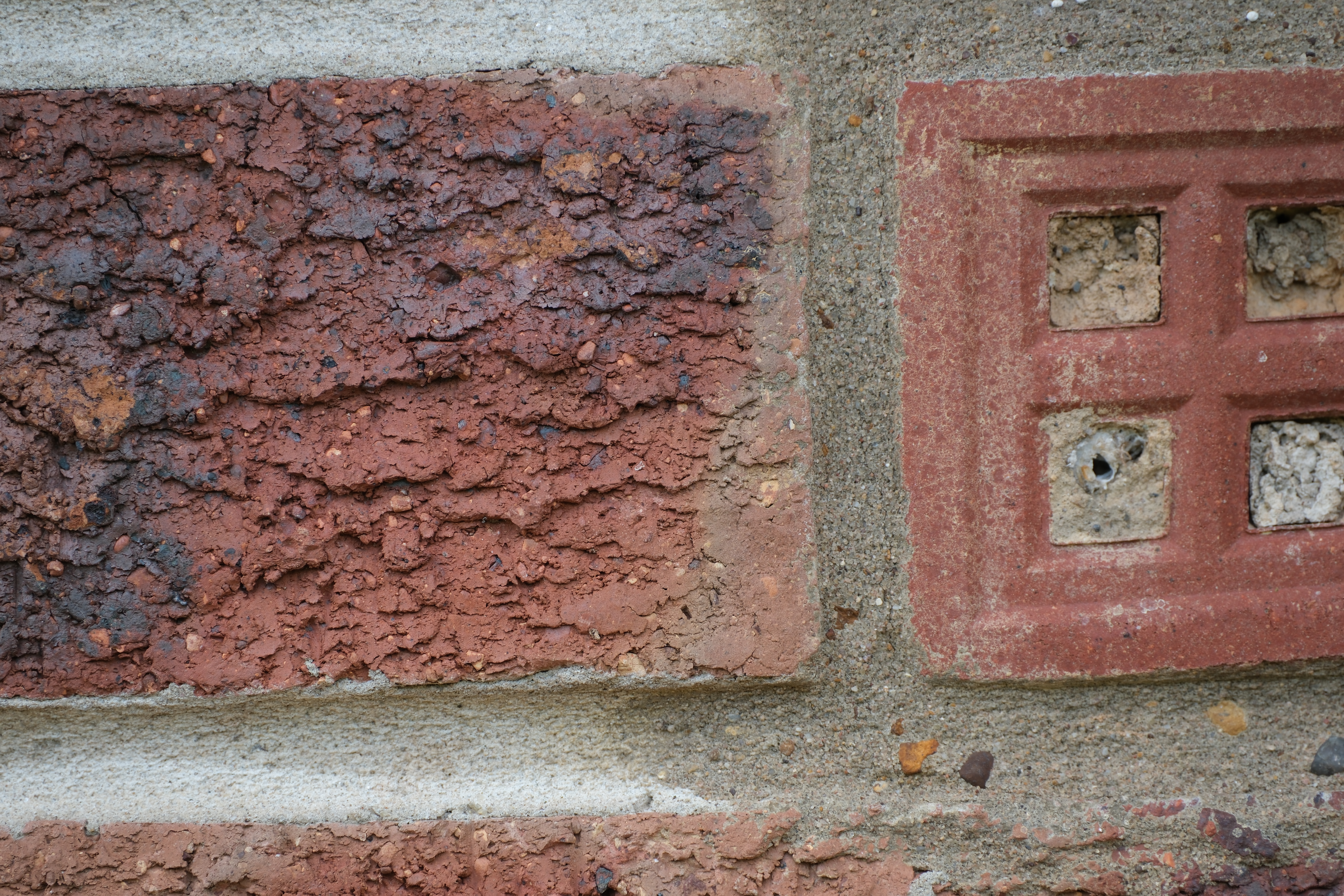

    In January, I moved over to Fuji, from Canon APS-C (M series). I spent a lot of money on lenses. I've never had to return/change so many due to inconsistant softness (more on one side than the other). I'm just returning a Tamron 18-300 and I want to change my 70-300 for that reason. I've never noticed it on any of my previous camera/lenses - all Canon. I only really notice it when pixel peeping, but it does annoy me.If it's the same softness both sides, I am OK with that - it's when one side is worse than the other that I want it fixing.
    So, is the 40mp sensor too good and I am picking up inherent faults which have always been there on all lenses, or is Fuji (and Tamron) quality control just not that good.
    I do have some lenses which are fine. My 16-80, my 10-24, my 23 & 33 - all seem OK. But the 16-80 is the second one.
    I now have two X-T5 bodies. Which eliminates the body as a source of the problem.
    Here's one from my 70-300. Right hand side is a lot softer than LH side
    Thoughts from the experts?

    Likely a tilt in the lens or lens mount.
    Do you use adapted lenses from another mount, or did you buy X-mount lenses for your Fujis?
    Possibly - but why so different?
    No, I always have X-mount lenses.

    I don't mind a bit of blur, but what I expect is that it is the same on the left as on the right. If it isn't then I assume the lens is faulty.
    Is my assumption correct?

    @AlanSh has written:
    Could be the lens. Could be the body.
    Try this test.
    blog.kasson.com/lens-screening-testing/
    just turn the camera upside down and take an image is all you need to do to see if the lens elements are not aligned.

    Thank you. Yes, that explains it. But my issue with lenses is the differing levels of softness at left and right. I am not sure I need the complexity of a Siemens Star and all the tests I would need to run to see if a lens is not performing correctly. Actually, Donalds idea of turning the camer upside down would do nicely if I had a tripod mount on the top of my camera.
    But in the absense of that, I will continue to test using bricks.
    @JimKasson has written:
    That is explained here:
    blog.kasson.com/lens-screening-testing/theory-of-the-test/
    Turning the camera upside down without changing the lens axis is difficult, even with a coaxial mount.
    Getting the alignment right for a brick wall is difficult also.
    Those are two of the reasons I developed the test.
    If there is a shift due to gravity and loose parts, that could make a difference, but if it is securely decentered, that won't change anything.
    well if it makes a sound and rattleing parts its the lens 🙄😂

    are you serious ! its the best way KISS if your stranding in the exact spot and use center focus on a point and spin the camera around without adjusting AF it cant get any more accurate.
