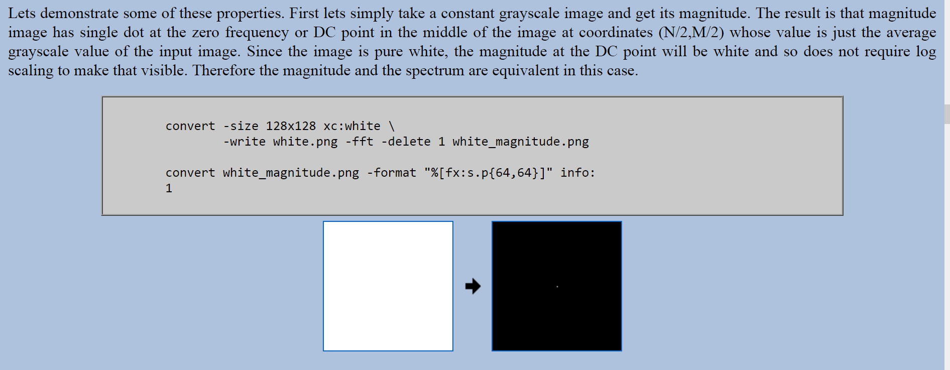

    looks like no padding, according to their 128x128 white square example:
    A bit above my head, sorry.
    I was thinking that an FFT plot of say 256x256 px can not have a 'DC' pixel at the exact center of the image, whereas a 255x255 px plot can.
    JPG, 300.2 KB, uploaded by xpatUSA on March 25, 2024.

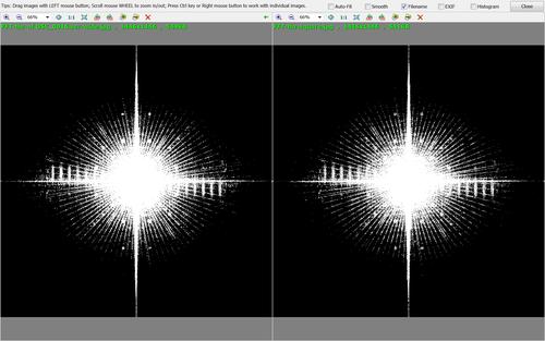

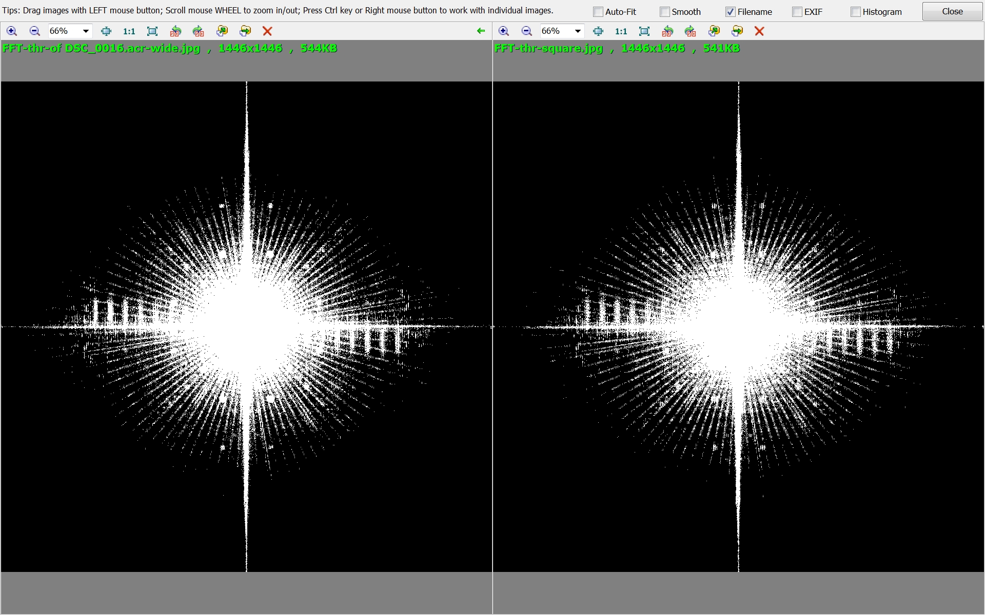

    To test that belief, I produced FFT plots of a wide Aspect Ratio image with G'MIC and ImageJ. I resampled the G'MIC plot to be square. I resized the ImageJ plot to the same size as the G'MIC, Then applied the GIMP Threshold function to each plot. It takes an eagle's eye to spot any differences:
    It would seem that padding and Aspect Ratio make no difference for my purpose!

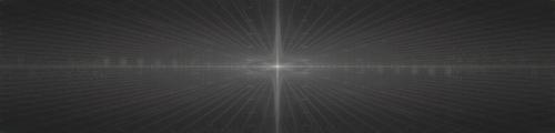

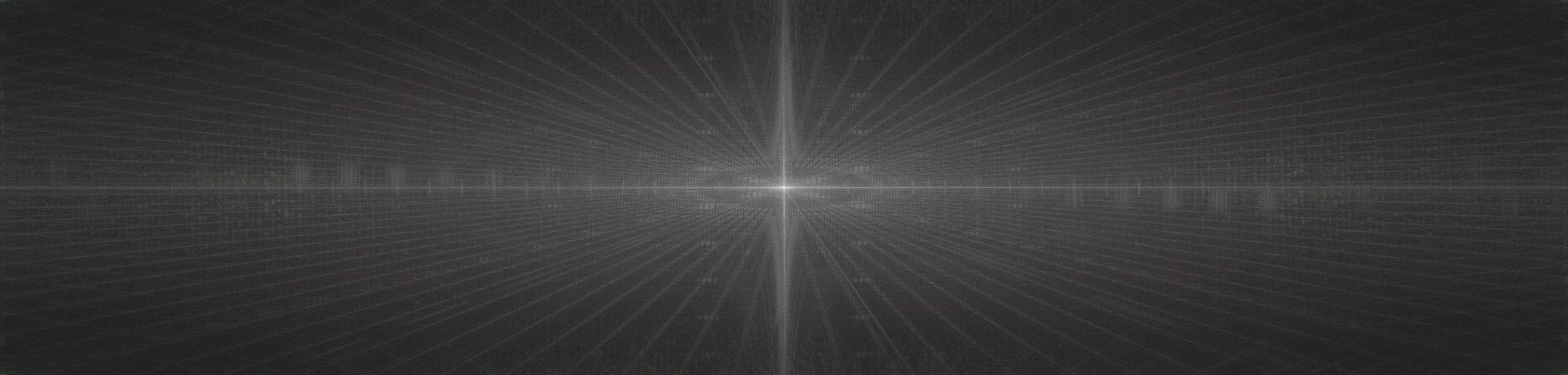

    Thanks ... here's the G'MIC version:
    JPG, 1.4 MB, uploaded by xpatUSA on March 26, 2024.
